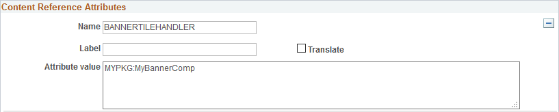

In the portal registry, edit the content reference definition for this fluid dashboard.
Note: The content reference definition can be found in Fluid Structure Content > Fluid Homepages.
Add a content reference attribute:
Translate: deselected
Attribute value: The name of your custom application class. For example: MYPKG:MyBannerComp
BANNERTILEHANDLER content reference attribute
The following example illustrates the definition of the BANNERTILEHANDLER content reference attribute.
