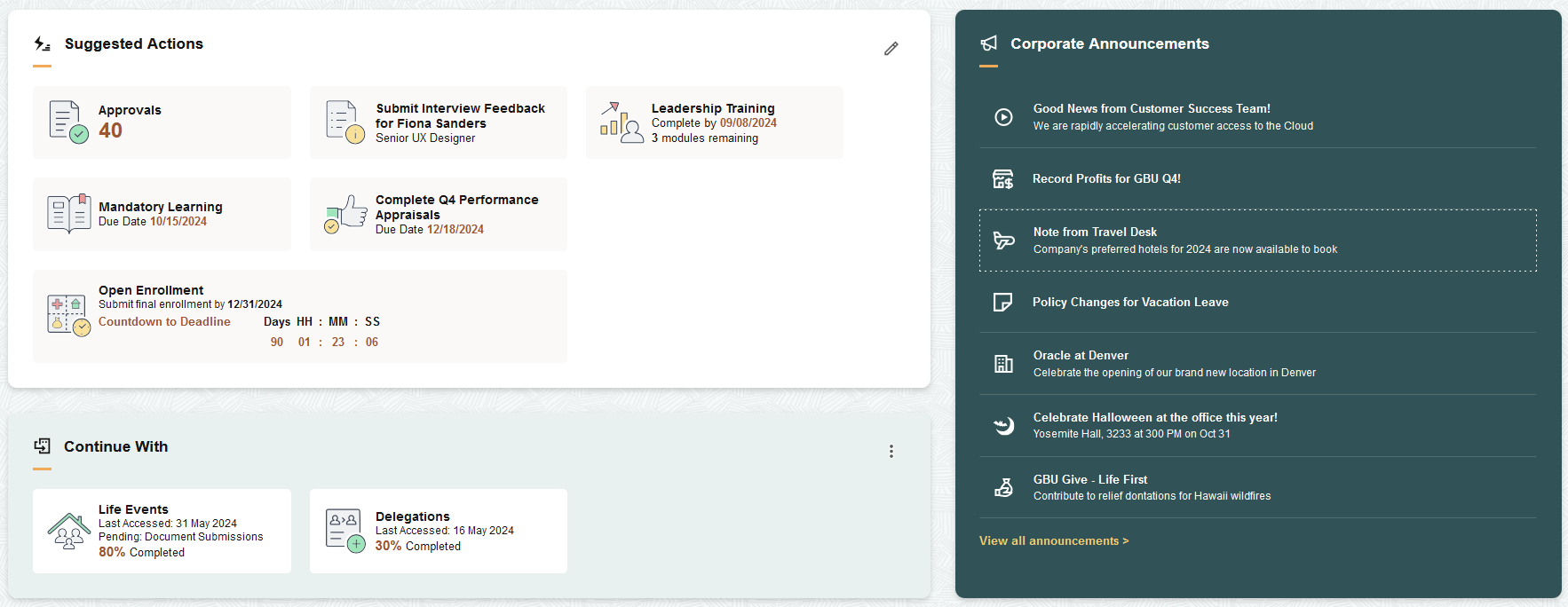

Designing Visual Forms of Sections
You use the delivered styles and CSS variables applicable at the level of a section to add granular styling to the section. The styles and CSS variables are described in the preceding topics. Based on your business requirements, you can style sections to span the entire width of the homepage or specify a fixed width for the section, which can grow vertically as you add tiles in the section, or you can lay the sections side-by-side.
Additionally, you can design each sections to be unique in its look and feel by applying specific background color, border, icon, and so on.
The following example shows some of the visual forms of sections.
This example illustrates some of the visual forms of sections.
Visual forms of sections

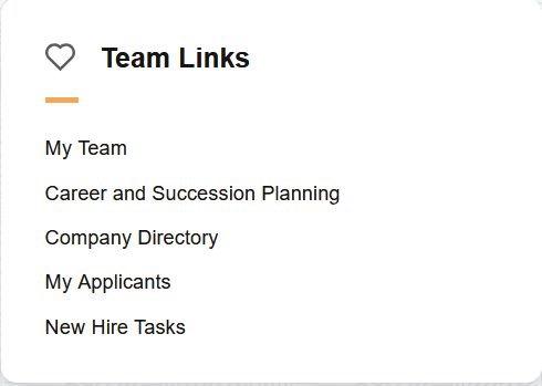

Tile Presented as a Link
You can create a tile to display as a link (hyperlink). Special properties have to be applied to the tile to behave as a link. These properties and styles are discussed in preceding topics.
  • At the tile level, use the psc_tile-simple-link style class to convert a tile to a hyperlink.
  • At the section level, use the psc_section-link-collection style class, which converts all tiles in the section into a collection of links displayed vertically.
  • Use the Tile.IsNotTile property and set it to True.
The following sample code creates a tile that is presented as a link. At the section level, the psc_section-link-collection style class is applied which presents the tiles as links.
&oTile = %This.CreateTileUsingTab("", "My Team");
   &oTile.RowNum = %This.GetNextRowNumber();
   &oTile.IsNotTile = True;
   %This.SetupFluidTarget(&oTile, GenerateComponentContentURL(%This.Tab.PortalName, %This.Tab.NodeName, MenuName.MYMENU, %Market, Component.MYCOMPONENT, Page.MYPAGE, %Action_UpdateDisplay));
   %This.AddTileToSection(&oTile);
Example of tiles displayed as links.
Tiles displayed as links
See Applying Styles from Delivered Style Sheets and Styling Homepages and Dashboards Using CSS Variables for information on styles and CSS variables that can be applied to sections and tiles.

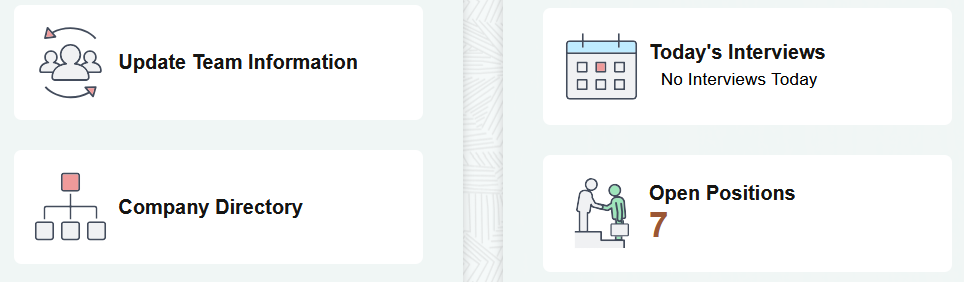

Standard Tiles
Standard tiles are tiles with image and text or tiles with live data. However, the visual presentation of these tiles can be changed by applying appropriate styles. For example, tiles can be displayed as a collection with a separator line, a tile can span the width of a section; a tile can display secondary text in addition to the main text.
Example of standard tiles.
Standard tiles
