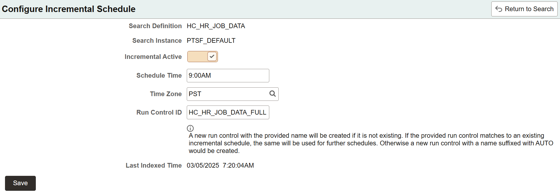

Use the Configure Incremental Schedule page to activate or deactivate incremental indexing for a specific search definition and to specify any additional information required for scheduling incremental indexing of the search definition.
Access the Configure Incremental Schedule page by selecting .
The search page displays search definitions as well as their schedule and last scheduled time status, enabling you to take necessary action on search definitions.
This example illustrates the fields and controls on the Configure Incremental Schedule page. You can find definitions for the fields and controls later on this page.
Field or Control |
Description |
Search Definition |
Displays the search definition’s name. |
Search Instance |
Displays the search instance's name. |
Incremental Active |
Enable the Incremental Active button to schedule incremental indexing at the specified time. |
Schedule Time |
Specify the time for initiating incremental indexing. |
Time Zone |
Select the preferred execution time zone. |
Run Control ID |
By default the last run control from a successful indexing is displayed. However, you can provide a run control of your choice. If the given run control doesn't exist, the system automatically creates a new incremental run control. |
Last Indexed Time |
Displays the date and time when the index was scheduled successfully. |
Index By Data Partition |
Displays whether the Search Framework partitions the application data using the Index By Data Partition option. This field is populated when data partition run control is available. |
Number of Partitions |
Displays the number of partitions. This field is populated when data partition indexing is enabled in the search definition. |

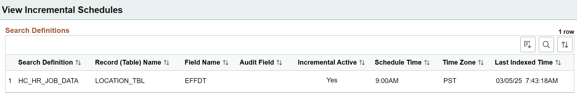

Use the View Incremental Schedules page to view the data related to incremental indexing. This page provides a comprehensive view of the information retrieved from the Configure Incremental Indexing and Configure Incremental Schedule pages.
Access the View Incremental Schedules page by selecting .
This example illustrates the fields and controls on the View Incremental Schedules page.
