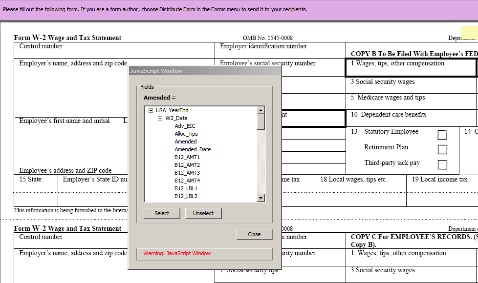

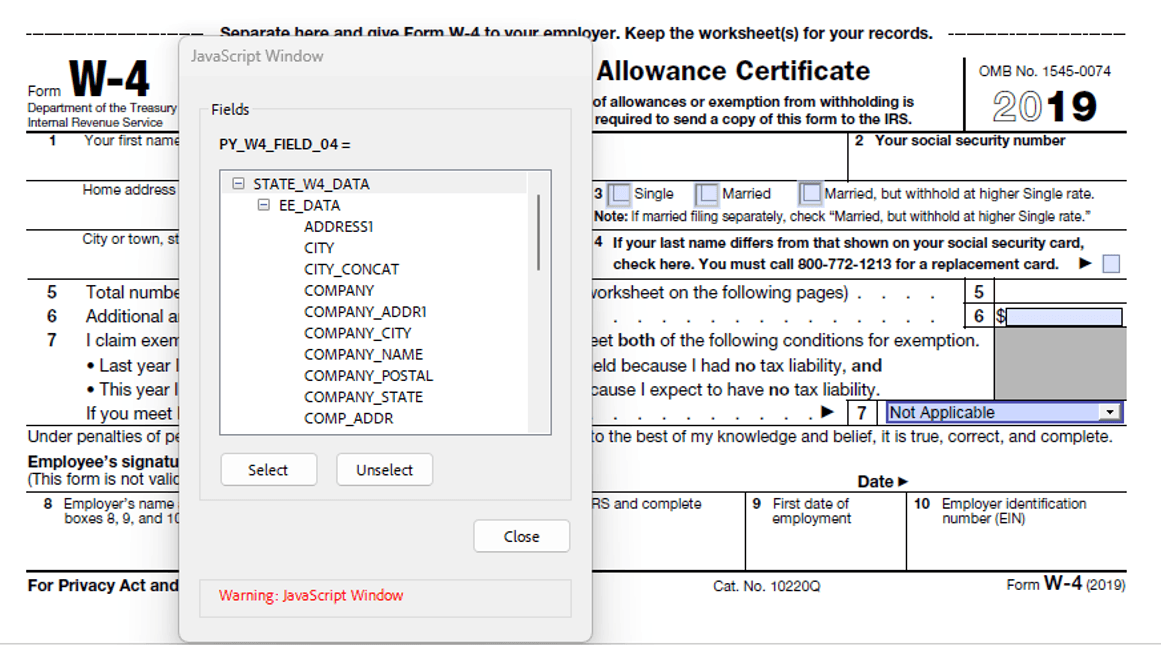

Visually map the data tags to the form’s field tags.
The mapping exercise is performed offline within the Adobe Acrobat application.
Save the file.
The generated file name indicates the type of mapping, as previously defined in step 2.
Upload the mapped PDF file on the page by selecting the map fileUpload button.
When uploaded to the server, the mapping information is stored in the database along with the PDF form template.
Note: If the PDF template’s field names are the same as the data source's data tag names, then no mapping or uploading of a map file is required.
Note: PDF file security has to allow editing and saving for the mapping to be completed. The ability to perform these functions depends on the Adobe version that you are working with.
Note: If no map file exists for your PDF file, selecting the Preview button on the page will not show any data because the form fields names do not match XML data tag names.
BI Publisher and Adobe
BI Publisher provides the following features within Adobe:
A visual indication of the PDF form fields that have been mapped.
A dark blue outline appears around the mapped form fields.
Display of the mapped field tag name when the cursor hovers over the PDF form field.
A pop-up dialog box containing an XML tag list that you can select from to insert the field tag when you click the PDF form field.

This example illustrates the mapping of form fields on a PDF file.
