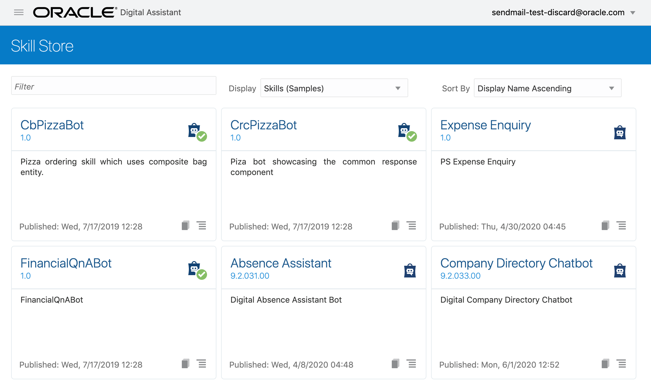

A typical Skill Store page in ODA
Use the Pull/Install option to install the skill in your ODA instance.

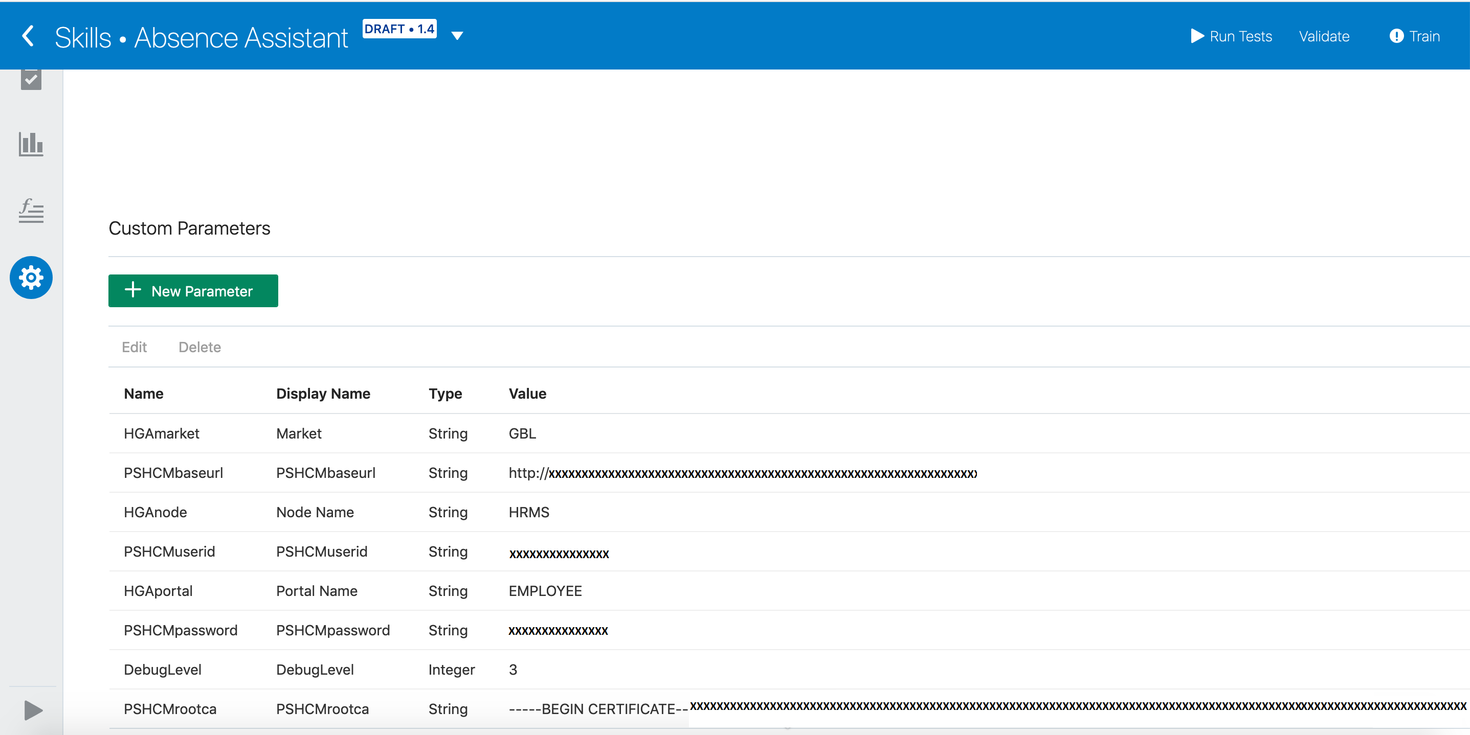

Access the configuration settings option of the cloned skill
Under Custom Parameters add the following parameters
 Name  |
 Display Name  |
 Type  |
 Value  |
 Add the Base URL name in the format PS <pillar> baseurl For example the base URL name for the HCM area can be PSHCMbaseurl.  |
 Create a display name in accordance with the PeopleSoft application . For example, the display name for HCM area can be HCM Base URL  |
 Add type as String  |
 Enter the URL of the application service. It is in the format https://<server>:<port>/PSIGW/RESTListeningConnector/<node>/PTCB_APPL_SVC.v1  |
 Add the proxy user name in the format PS <pillar> userid  |
 Add the display name for the proxy user  |
 Enter the proxy user name.  |
 Add the proxy password name in the format PS <pillar> password  |
 Add the display name for the proxy user password  |
 Enter the password of the proxy user.  |
Note: Delivered skills have the names already configured. Users need to update the Value field for them. It is recommended to also add the custom parameter DebugLevel with Type as Integer and value as 3.
Configure skill to point to PeopleSoft service.
