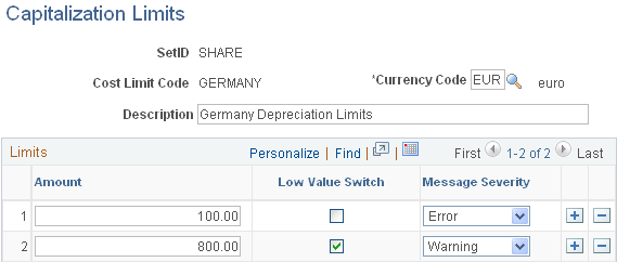

Use the Capitalization Limits page (DEPR_CAP_LIMIT) to specify asset value minimums and associate warning or error actions with assets whose values fall below those limits.
Navigation:
PeopleSoft Asset Management supports low-value asset processing by providing a capitalization limit table where you can specify asset value minimums and associate warning or error actions with assets whose values fall below those limits. Additionally, you can set the limit at which an asset is marked as a low-value asset.
This example illustrates the fields and controls on the Capitalization Limits page. You can find definitions for the fields and controls later on this page.
After you have set up the necessary capitalization limits, select Table Lim (table limit) and the correct code as the capitalization limit method on the Business Unit/Book Definition page in the Establish Business Units - Asset Management Definition component.
When you add assets to that business unit and book combination, Asset Management checks the capitalization limits against the amounts that are stored by code in the capitalization limit table.
In Germany, assets marked as low value should be depreciated in one year.
PeopleSoft Asset Management provides the PROGWG asset profile that is defined with depreciation attributes that are appropriate for German low-value asset processing. These include depreciation using the straight-line method and a useful life of 12 periods. Also, Asset Management provides the German First Day Last Period depreciation convention that you can use to generate one accounting entry for the annual depreciation for a low-value asset.
Low-value assets can be retired in mass using the Auto-Retire feature to satisfy the requirement that low-value assets be fully depreciated and retired after the first year of service.

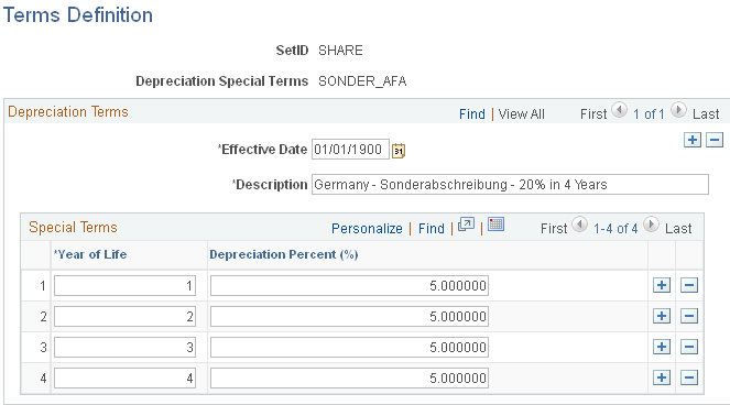

Use the Terms Definition page (DEPR_TERMS_DEFN) to define special depreciation terms for accelerated depreciation and associate the terms at the asset or book level.
Navigation:
PeopleSoft Asset Management supports special depreciation methods that are used in Germany, such as accelerated depreciation, by enabling you to define special terms and associate them at the asset and book level.
This example illustrates the fields and controls on the Terms Definition page. You can find definitions for the fields and controls later on this page.
After you have defined special terms, associate them with an asset or book by selecting the Special Depreciation check box on the Depreciation Information page in the Asset ExpressAdd component.
