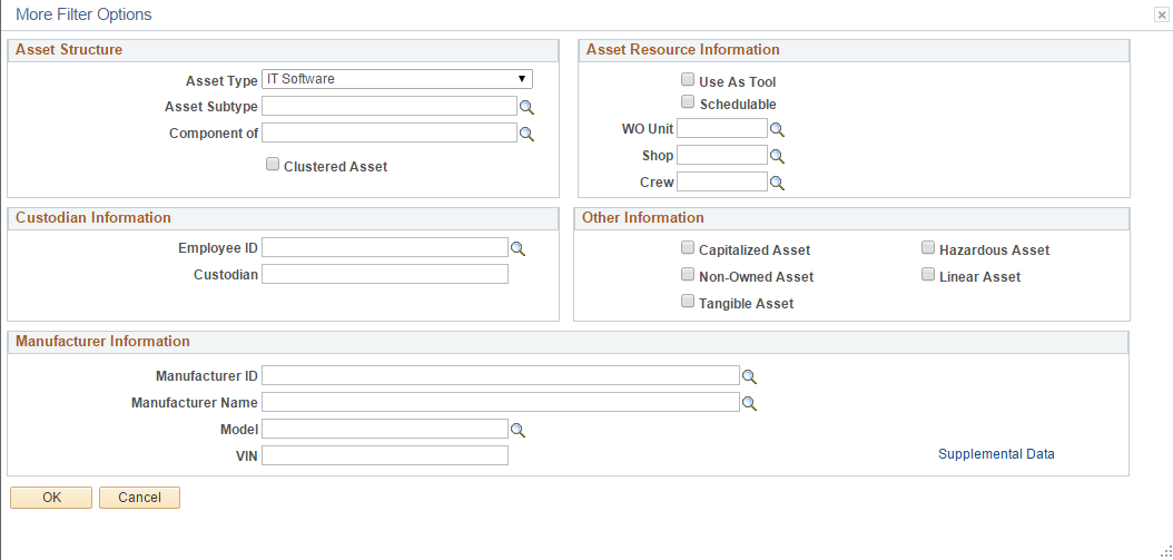

Access the Additional Search Criteria - More Filter Options page by clicking the Additional Search Criteria link.
This example illustrates the fields and controls on the Additional Search Criteria - More Filter Options page.

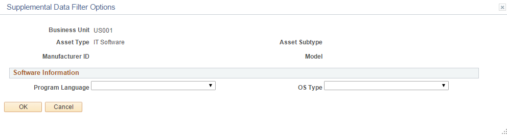

In addition to search fields such as Employee ID, Capitalized Asset, and Manufacturer ID, you can click the Supplemental Data link to access software specific search fields on the Additional Search Criteria - Supplemental Data Filter Options page. You must select one of the following Asset Types to enable the Supplemental Data link:
IT Hardware
IT Software
Equipment
Property
Facility
Intangible
Other.
This example illustrates the fields and controls on the Additional Search Criteria - Supplemental Data Filter Options page.

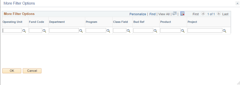

Access the ChartField Search Criteria - More Filter Options page by clicking the ChartField Search Criteria link.
This example illustrates the fields and controls on the ChartField Search Criteria - More Filter Options page.
