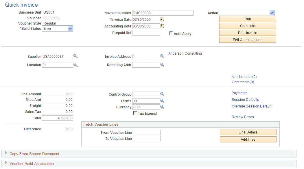

This example illustrates the fields and controls on the Quick Invoice page for complete worksheets. You can find definitions for the fields and controls later on this page.
General Invoice Information
You must enter a supplier ID, invoice number, invoice date, and total amount. Other fields are optional. If you leave the optional fields blank, the Voucher Build process completes the voucher according to the defaults that you set up in the PeopleSoft Payables control hierarchy or the session defaults.
Note: If financial sanctions validation is enabled at the installation level, and the supplier has a financial sanctions status of Review or Blocked, the system displays a warning message that the supplier selected is currently under financial sanctions review. You can save the quick invoice, however, the system does not allow payments to suppliers with a financial sanctions status of Review or Blocked.
Field or Control |
Description |
Print Invoice |
Click to create the invoice in a PDF file format. The system opens a new window where you can view and print the invoice. |
Calculate (calculate on-demand balancing) and Difference |
Click to perform on-demand balancing validation, which calculates the difference between the invoice lines plus the applicable charge amounts (miscellaneous, freight, and tax amounts) and the gross invoice amount. This amount appears in the Difference field when the voucher is out of balance. The system populates the Difference field with 0.00 when the voucher is in balance. |
Edit Combinations |
Click to perform on-demand combination edit validation, which audits ChartField combinations. |
Attachments (n) |
Click to add or view attachments related to this quick invoice. Attachments are available after the quick invoice becomes a regular voucher. See Installation Options - Multiple Attachments Page to define the maximum attachment upload limit for various products. |
Comments (n) |
Click to enter comments for a quick invoice to explain payment schedules, issues with the supplier, or anything else that you need to document the invoice. Any comments that you enter in this field are meant for your reference only. You can enter up to 254 characters for a comment. If you exceed 254 characters, the system displays a warning message that it can save only 254 characters and truncates the message. Comments are available after the quick invoice becomes a regular voucher. The system displays (0) if no comment is attached to this voucher. The system displays a number if there is one or more comments associated to this quick invoice. |
Line Amount |
Displays the combined total of the invoice line amounts. |

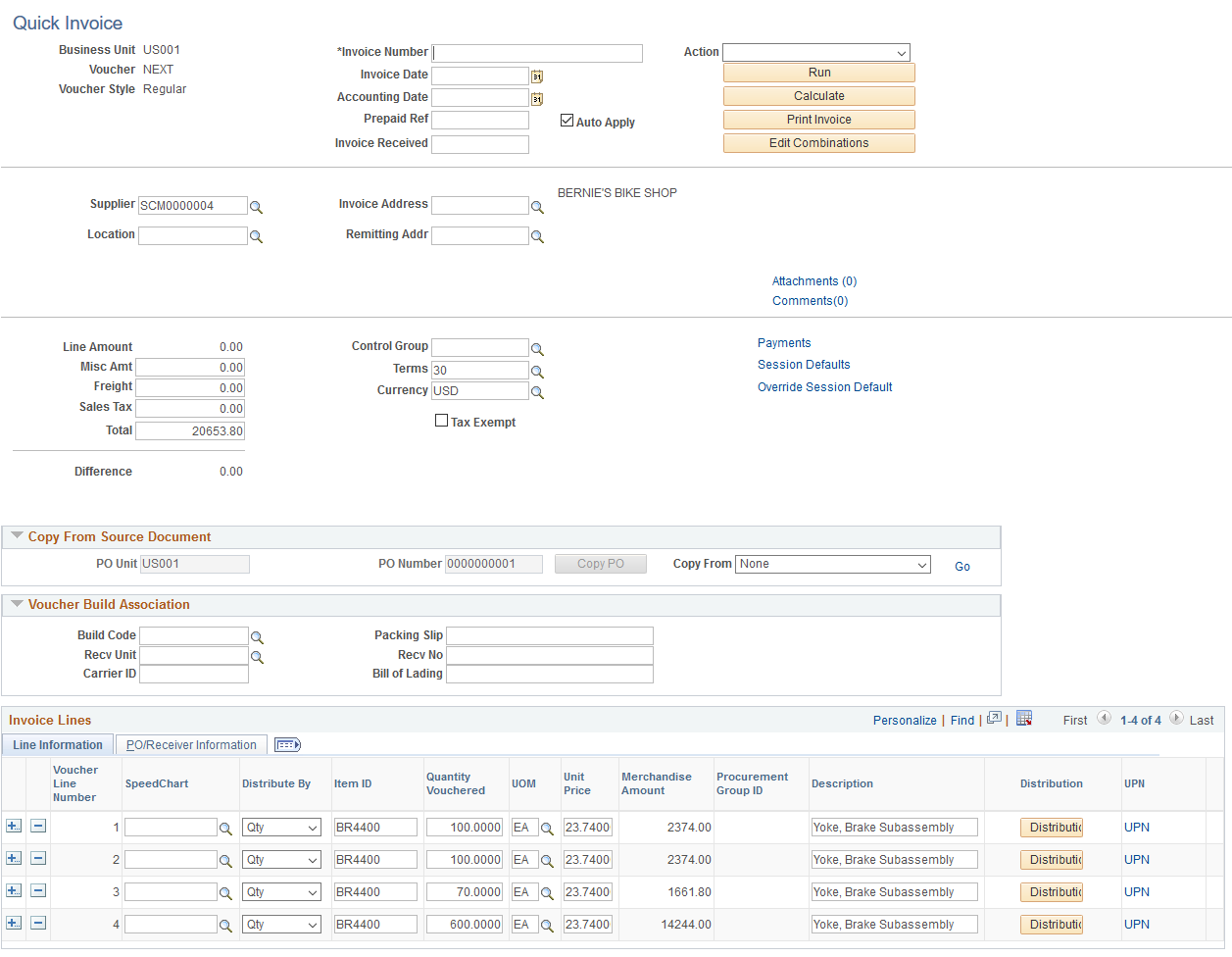

Copy From a Source Document
In add mode, this group box provides fields for indicating purchase orders or receivers that you want to copy to the voucher or that you want the Voucher Build process to build into a voucher.
In update/display mode, this group box also includes fields for delimiting the number of voucher lines that appear in the Voucher Lines scroll area.
See Quick Invoice Page.
PeopleSoft Payables enables you to copy entire source documents, or portions of them, saving data entry time and reducing potential input errors. Select the UPN hyperlink to view the details of the UPN This hyperlink is available whenever a voucher is created by copying from a source document. When an quick voucher is created without copying from a source document, the UPN link is hidden. Likewise, when a quick invoice is created using the simple template, the UPN link is hidden.
Note: When an Item ID field is left blank, the UPN fields are cleared, and after the Voucher Build process is run, the UPN fields reverts to the default information from the Source document. When there are any changes to the Item or to the UOM, the UPN fields reverts to the default information based on the Item ID and UOM entered.
Note: When copying a source document into a Quick invoice, the UPN details are rendered as display-only for both, Item Source document, and also for Description only Source document.
Important! If you intend to copy information from a purchase order or a receiver, do not begin by entering information on the add and search page. Leave these fields blank. Also ensure that the line entry default is one (1).
Note: The fields in this group box are not available for entry if the voucher style is Prepaid. You cannot copy a purchase order or receiver to a prepaid voucher.
Any values that you enter in this group box are copied to the voucher and distribution lines, where you can override them.
See Voucher Build Processing Logic for Associating Voucher Lines with Purchase Order and Receiver Lines.

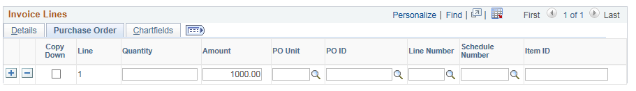

Invoice Lines
Most of the fields in this scroll area are identical to those in the Invoice Lines scroll area on the Invoice Information page in the Voucher component. Any differences are documented here.
Note: The purchase order- and receiver-related fields in this scroll area are not available for entry if the voucher style is Prepaid.

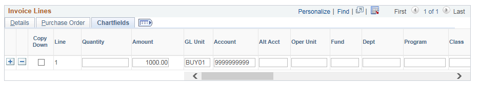

This example illustrates the fields and controls on the ChartFields page.

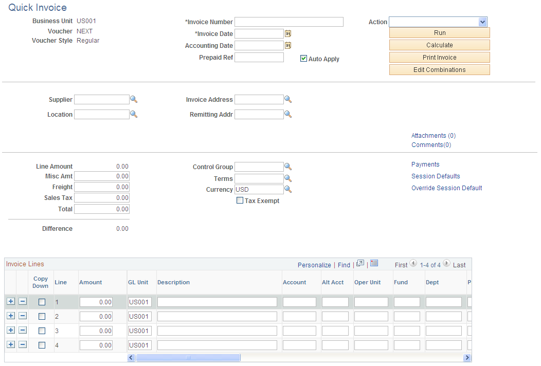

Use the Quick Invoice (simple worksheet) page (VCHR_HEADER_QV2) to enter and update invoice header, line, and distribution information for the Voucher Build process to build into a voucher.
The simple worksheet requires minimal voucher data entry. You can only enter the simple worksheet in update/display mode if you have not yet run the Voucher Build process for the voucher.
Navigation:
Select Simple in the Quick Invoice Template field on the Add Search page.

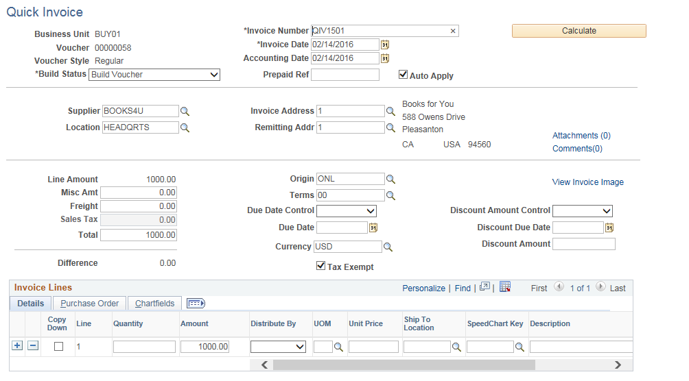

This example illustrates the fields and controls on the Quick Invoice page for simple worksheets. You can find definitions for the fields and controls later on this page.
Note: Descriptions of many of the fields on this page can be found in the discussion of the Quick Invoice complete worksheet page and in other topics.

Prepaid Ref (prepaid reference) and Auto Apply (automatically apply payment) |
Enter a prepayment reference and select to have the system automatically apply the payment to a subsequent invoice with that prepayment reference. See Entering Prepayment Vouchers Using the Quick Invoice Entry Component. |
Invoice Lines
Enter the extended amount and distribution information for each voucher line. You can enter one combined distribution line per voucher line. You can select the Copy Down check box on a distribution line to copy that line's General Ledger business unit and ChartField values to new distribution lines.

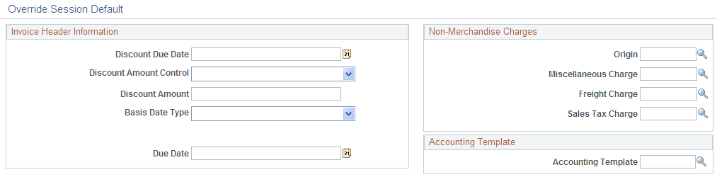

Use the Override Session Default page (VCHR_HDR_QV_SEC) to override optional voucher header defaults for the current quick invoice.
Navigation:
Click Override Session Default on the Quick Invoice page (complete or simple worksheet).
This example illustrates the fields and controls on the Override Session Default page. You can find definitions for the fields and controls later on this page.
Note: The fields that appear in the Non-Merchandise Charges group box—and the presence of the Non-Merchandise Charges group box itself—depend on the display options selected on the Session Defaults page for your session. The Miscellaneous Charge, Freight Charge, and Sales Tax Charge fields do not appear if you are entering a prepaid voucher.

Discount Amount Control |
Specify whether or not to accept the default payment terms or to enter your own due date and discount information. Values are: Terms: The system uses the calculated discount amount. The system calculates the discount amount according to the payment terms, due date, and discount due date that you enter here. If you leave these blank, the system calculates the discount amount according to the payment terms that are populated by default through the PeopleSoft Payables control hierarchy. User: The system uses the discount amount that you enter in the Discount Amounts field. |
Note: The system does not use any discount amount you enter here if you select Terms as the discount amount control value.
Note: Discount terms fields are grayed out if you are entering a prepaid voucher. If you enter discount terms or multipayment terms in the Terms field for a prepaid voucher, the voucher will fail voucher build processing.

Use the Quick Invoice page for a complete or simple worksheet in update/display mode.
Navigation:
Note: All quick invoice vouchers staged by the Voucher Build process appear in the complete worksheet. Those entered in the Quick Invoice Entry component and not yet processed by Voucher Build appear in the worksheet of entry.
This example illustrates the fields and controls on the Quick Invoice page for a complete worksheet in update/display mode, before inserting or fetching voucher lines.
The Quick Invoice Entry component is used for reviewing and updating vouchers staged for review by the Voucher Build process, as well as for correcting vouchers that have Voucher Build process pre-edit errors. For this reason, the Quick Invoice Entry component provides the following special functions when accessed in update/display mode:
When you access the page, voucher lines are not called up and the Invoice Lines scroll area does not appear; this enables you to open a voucher with a large number of lines without taking unnecessary processing time.
To view existing voucher lines, enter a range of voucher lines in the From Vchr Line and To Voucher Line fields and click the Search button to view and update the lines in the Voucher Lines scroll area.
The default from and to values are the first and last lines in the voucher; to view all lines in a voucher, simply click Search.
To insert a voucher line without calling up existing lines, click the Insert button to display the Invoice Lines scroll area, where you can add voucher line information.
Note: Once you've inserted a voucher line, you must save the voucher and access it again through the search page to fetch additional voucher lines.
