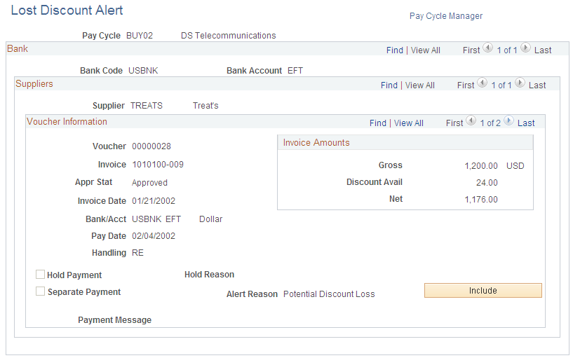

Use the Lost Discount Alert page (PYCYCL_DSCNT_ALRT) to view scheduled payments that you have not included in the current pay cycle with earned discounts that you may lose if you don't pay them before the next payment date.
Navigation:
Click the Discount Lost link on the Pay Cycle Manager page.
This example illustrates the fields and controls on the Lost Discount Alert page. You can find definitions for the fields and controls later on this page.
This page alerts you to any discount lost on a pay cycle. If you selected the Include Lost Discount check box on the Payment Selection Criteria - Preferences page for the pay cycle, then all payments with potential lost discounts are automatically paid in the pay cycle, and this page is not applicable. You must view this page after Payment Selection has run and before you run Payment Creation to use the Include button to include a payment with a potential lost discount.
Note: All discount alerts are cleared automatically when you rerun a completed pay cycle.
Note: Lost rebates are not tracked and do not appear on this page.
Voucher Information
Field or Control |
Description |
Appr Stat (approval status) |
Displays the voucher scheduled payment approval status. |
Handling |
Displays the payment handling code. You set up payment handling codes on the Payment Handling Codes page. See Payment Sorting. |
Separate Payment |
Specifies whether the scheduled payment is a separate payment and prevents it from being grouped with any other payment. If this option is not selected, the scheduled payment is combined with other scheduled payments that are being paid to a supplier from the same bank account using the same payment method. By default, the system groups all payments for a supplier by the payment method, even if the payments are for different business units. In addition to the standard payment groupings, draft payments have added groupings, such as draft maturity date, sight code, or scheduled payment date. You can overrule the default grouping criteria if you set up the Do Not Mix with Other Business Units option for a particular business unit or when you select the Separate payment option. |
Hold Payment |
Specifies whether the payment schedule is on hold so that it is not picked up by the pay cycle. The hold option can be set manually or by a scheduled process. For example, the withholding process places on hold those vouchers with withholding exceptions. |
Hold Reason |
Displays the reason that the scheduled payment is on hold. |
Alert Reason |
Indicates why the alert was issued for the payment. |
Payment Message |
Shows any payment message for the payment schedule. |
Include |
Click to include the payment in the current pay cycle. This button is active only after you run Payment Selection and before you run Payment Creation. |
Invoice Amounts
Field or Control |
Description |
Gross |
Displays the amount of the payment if a discount is not applied. |
Discount Avail (discount available) |
Displays the amount you are in danger of losing if you do not include this payment in the cycle. |
Net |
Displays the amount of the payment if the discount is taken. |
