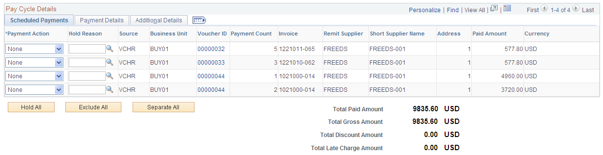

This example illustrates the fields and controls on the Pay Cycle Details page (1 of 2). You can find definitions for the fields and controls later on this page.

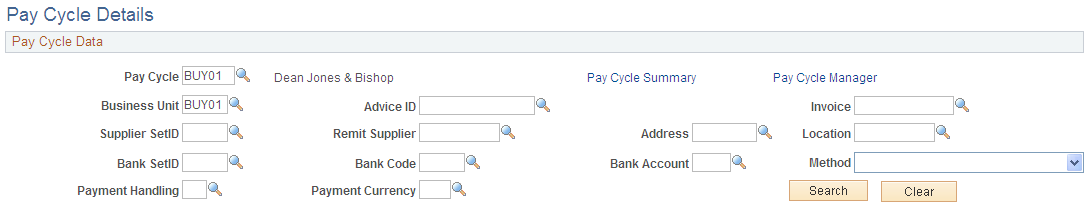

This example illustrates the fields and controls on the Pay Cycle Details page (2 of 2). You can find definitions for the fields and controls later on this page.
Select a pay cycle and click the Search button to view all scheduled voucher payments selected for your current pay cycle. You can limit your search using the other fields. For example, you might want to limit your search to a certain business unit.
Scheduled Payments
You can view selected scheduled payments and take action to hold, exempt, flag as a separate payment, or hold and flag as separate.

Select an action to perform on a selected scheduled payment. This field is available only after you run Payment Selection and before you run Payment Creation. Actions include: Exclude: Excludes the scheduled payment from the pay cycle. Unless you run a future pay cycle with a pay-from date that precedes the payment date on the excluded scheduled payment (and the payment meets the other selection criteria), this payment will not be picked up by a pay cycle again. Hold: Holds the payment from continued processing by the pay cycle. This payment will not be selected by a pay cycle again until you release the hold. Hold & Separate: Places the scheduled payment on hold and separate from any other payments to be paid to the same supplier from the same bank account and payment method. None: Takes no action. The payment remains selected and subject to processing in the current pay cycle run. Separate: Marks the scheduled payment to be paid separately from any other payments to this supplier from this bank account and payment method. Note: The system automatically sets all prepayment vouchers with an action value of None to ensure correct processing. You cannot change this default setting. |

Action Buttons
Field or Control |
Description |
Hold All |
Click to hold all scheduled payments in the pay cycle. These payments will not be selected by a pay cycle until you release the hold. |
Exclude All |
Click to exclude all scheduled payments in the pay cycle. These payments will not be selected by a pay cycle unless that pay cycle has a pay-from date that precedes the payment date on the excluded scheduled payment (and the payment meets the other selection criteria). |
Separate All |
Click to mark all payments in the pay cycle for separate payment. |
