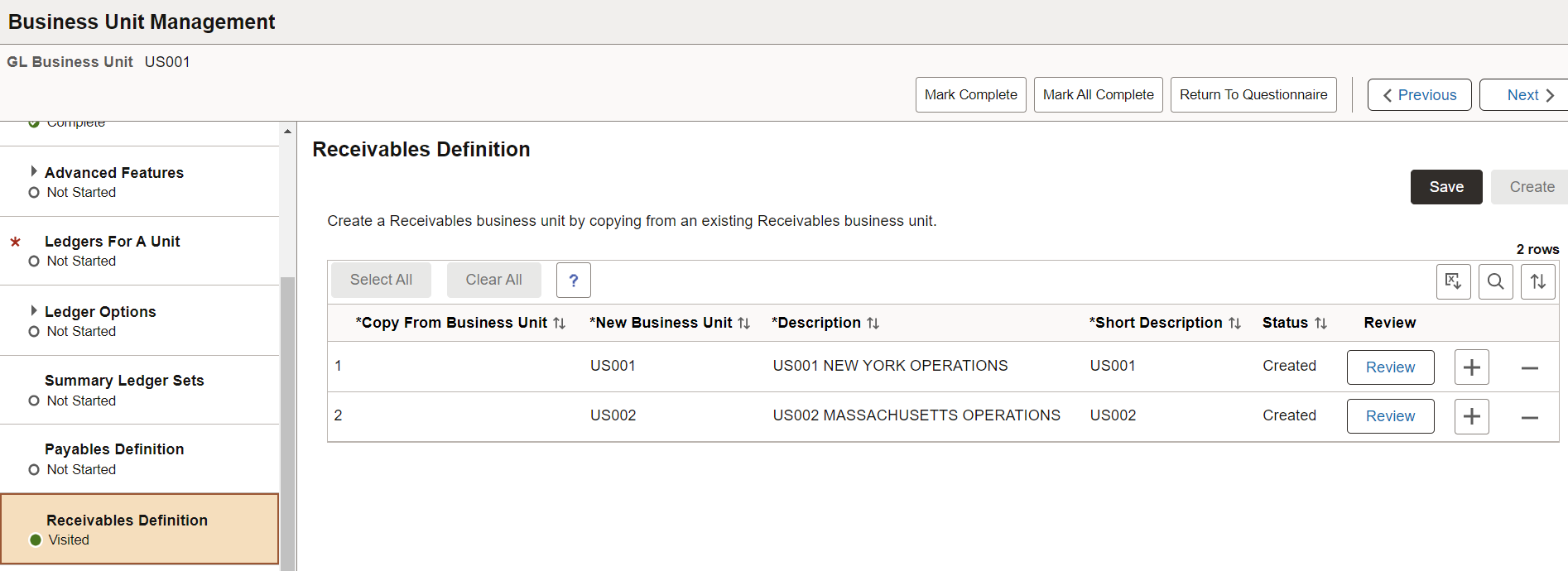

Use the Receivables Definition page (AR_BU_COPY_FL) to search, modify, add, and copy Receivables business units.
Navigation:
This example illustrates the Receivables Definition page.
            See the View Business Unit Management Page for field definitions.
Note: This page allows you to create a new Receivables sub-ledger business unit by copying from an existing sub-ledger business unit. The new sub-ledger business unit is not created until you select the Create button. When the Create button is selected, the Review button is available to proceed to the sub-ledger Questionnaire page. The system then proceeds to the sub-ledger configuration pages.

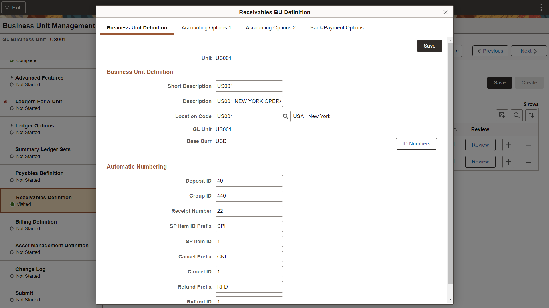

Use the Business Unit Definition page (BUS_UNT_TBL_AR_FL1) to create a Receivables business unit and specify its default numbering options.
Navigation:
This example illustrates the Business Unit Definition page.
            See the Receivables Definition - Business Unit Definition Page for field definitions.

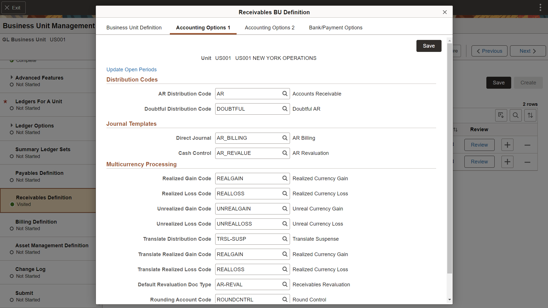

Use the Accounting Options 1 page (BUS_UNT_TBL_AR_FL2) to define the open accounting periods for the business unit, assign a direct journal template to the unit, assign the accounts receivable distribution codes to the unit, and define multi-currency processing options.
Navigation:
This example illustrates the Accounting Options 1 page.
            See the Receivables Definition - Accounting Options 1 Page for field definitions.

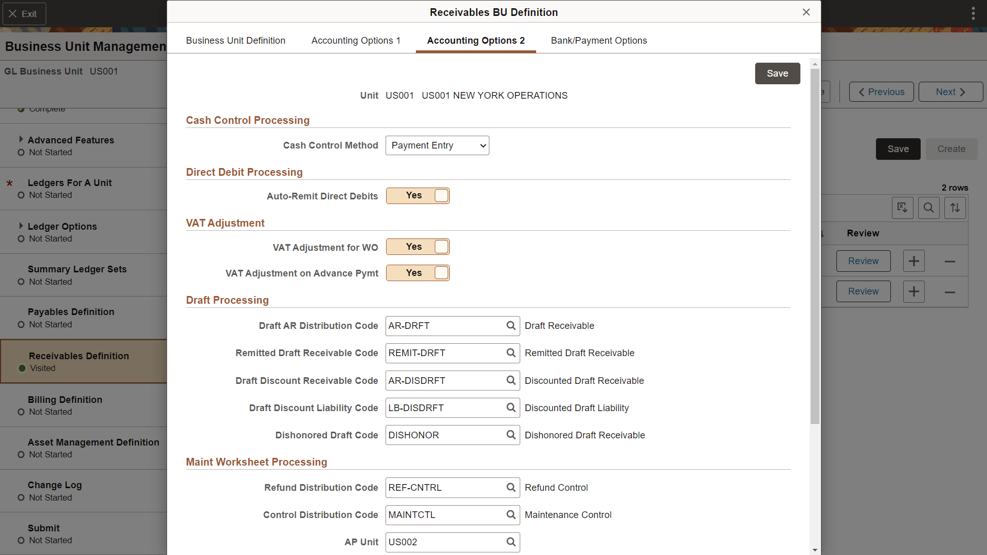

Use the Accounting Options 2 page (BUS_UNT_TBL_AR_FL3) to specify the distribution codes used to create accounting entries for draft processing and refund processing.
Navigation:
This example illustrates the Accounting Options 2 page.
            See the Receivables Definition - Accounting Options 2 Page for field definitions.

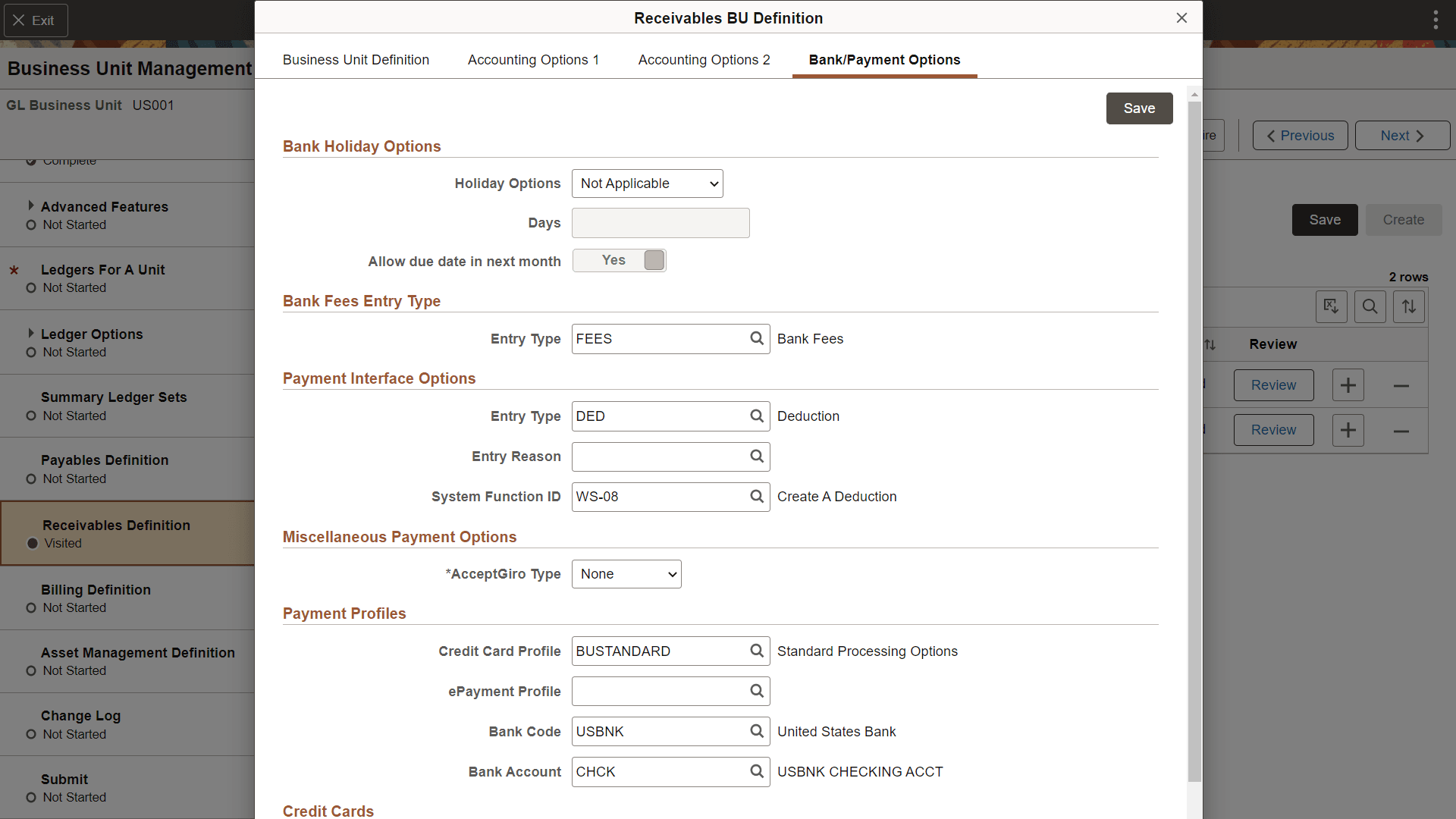

Use the Bank/Payment Options page (BUS_UNT_TBL_AR_FL4) to specify business unit defaults for due dates that fall on holidays.
Navigation:
This example illustrates the Bank/Payment Options page.
            See the Receivables Definition - Bank/Payment Options Page for field definitions.
