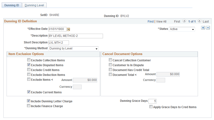

Use the Dunning ID page (DUNNING_TBL) to define dunning IDs and select a dunning method (by level, by days past due, or by action list).
Navigation:
This example illustrates the fields and controls on the Dunning ID page. You can find definitions for the fields and controls later on this page.
Field or Control  |
Description  |
Dunning Method  |
 Select the dunning method. Values are: Dunning by Action List: Based on the rules defined in an action template that the Condition Monitor process uses. If you select this value, the Dunning Level page is not available to define dunning levels. Dunning by Days: Based on a range of the number of days past due, such as 1 to 60 days, 61 to 90 days, and 91 to 9999 days. Dunning by Level: Based on a sequence with a number of days between letters. Note: The Condition Monitor process runs dunning letters when it completes. Always use dunning by action list if you use the Condition Monitor process for collection activities, unless the government requires you to use dunning by level. The Condition Monitor process uses the action templates that you set up to determine the rules for generating the dunning letters instead of the dunning method.  |
Exclude Collection Items, Exclude Disputed Item, and Exclude Deduction Items  |
 Select to prevent items from appearing on dunning letters if they are deductions or marked for collection or dispute on the View/Update Item Details - Detail 1 page.  |
Exclude Credit Items  |
 Select to prevent credit memos, on-account payments, and prepayments from appearing in dunning letters.  |
Exclude Items < (exclude items less than)  |
 Select a monetary limit to prevent items from appearing in dunning letters if the items are under a certain amount. The system uses the rate type for the item to convert the amount that you enter to the item currency for comparison.  |
Exclude Current Items  |
 Select this option to exclude current items and only process past due items. If you do not select this option, both current items and past due items are processed. This option is only available when the Dunning Method is Dunning by Days or Dunning by Level.  |
Cancel Collection Customer and Customer Is In Dispute  |
 Select to prevent the system from generating dunning letters for customers who are marked for collection or dispute on the Credit Profile page.  |
Document Has Credit Total  |
 Select to skip dunning letters with a negative total balance amount.  |
Document Total < (document total less than)  |
 Select and enter a monetary limit to prevent the system from generating dunning letters when the total of items in the letter is less than a specified amount at the correspondence customer level. For example, you might cancel a letter if a customer with a small debit balance belongs to the same correspondence customer as a customer with a larger credit balance. The system uses the rate type for the correspondence customer to convert amounts for comparison purposes.  |
Include Dunning Letter Charge  |
 Select to apply a fixed charge for each letter generated. The charge can be different for each dunning level.  |
Include Finance Charge  |
 Select to impose an overdue charge for past due items in the dunning letter.  |
Dunning Grace Days  |
 Enter the number of extra days to allow for postal service when running the AR Dunning process. Grace days is applicable only if Exclude Current Items is selected.  |
Apply Grace Days to Credit Items  |
 Excludes credit items from the dunning letter when Credit Item Due Date + Dunning Grace Days > As Of Date. This is the system default. Credit items are any items with an item balance amount less than zero, such as on-accounts, prepayments, or credit memos. Deselect this check box so that the system will not apply Dunning Grace Days criteria to any credit items. You must also select the Include in Dunning check box on the credit item's Entry Type page (Set Up Financials/Supply Chain, Product Related, Receivables, Options, Entry Type, Entry Type) to add credit items to dunning letters. The dunning level for credit items is empty, or blank, in dunning reports.  |

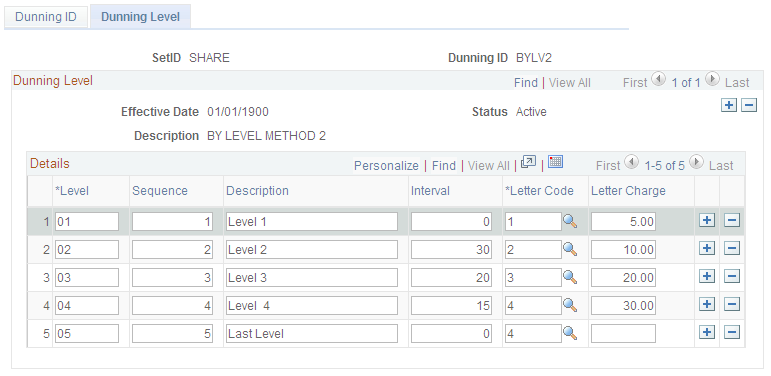

Use the Dunning Level page (DUNNING_LVL_TBL) to define the levels for the dunning method that you selected on the Dunning ID page.
(This page is not available for a dunning by action list method.)
Navigation:
This example illustrates the fields and controls on the Dunning Level page. You can find definitions for the fields and controls later on this page.
The fields that appear on this page depend on the method that you selected and on whether you selected the Include Dunning Letter Charge check box on the Dunning ID page.
Field or Control  |
Description  |
Level  |
 Assign a dunning level. Note: When you set up Dunning Levels, set up the Level 01 interval equal to zero to indicate to the Dunning process that no interval must elapse to advance to the next level based on the first time you run the Dunning process using the Dunning by Level method. For example: Row 1: Level = 01, Interval = 0, Letter Code = 1 Row 2: Level = 02, Interval = 27, Letter Code = 1 (or 2 or 3)  |
Sequence  |
 Assign a sequence number to a level.  |
Start Day, End Day, or Interval  |
 For a dunning method by days, select a start and end day for each level. The first start day for the first level must be 1, and the last end day for the last level must be 9999. For a dunning method by levels, indicate the number of days between levels.  |
Letter Code  |
 Enter the letter code corresponding to the text that you want to send to customers whose outstanding items fall within the category. If you run the Dunning Letters - All Levels (ARX33000) report, the system uses the dunning level for either the oldest or newest item, based on your selection on the Dunning Letters Parameters page.  |
Letter Charge  |
 Specify the charge for each letter that you send. This field is available only if you selected the Include Dunning Letter Charge check box on the Dunning ID page (Set Up Financials/Supply Chain, Product Related, Receivables, Credit/Collections, Dunning Methods, Dunning ID).  |
