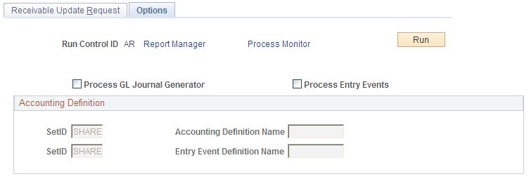

Use the Request Receivables Update - Options page (POSTING_OPTIONS) to select optional processes to run and specify an accounting entry definition for the Journal Generator process and an entry events definition for the Entry Events Generator process.
These options apply to all business units processed by the run control.
Navigation:
This example illustrates the fields and controls on the Request Receivables Update - Options page. You can find definitions for the fields and controls later on this page.
Field or Control |
Description |
Process GL Journal Generator |
Select to run the Journal Generator process, which generates the journals for the general ledger when the Receivables Update process finishes. If errors occurred in the accounting entries, the process will not process the entries. |
Process Entry Events |
Select to run the Entry Events Generator process as part of the Receivables Update process. This field is available only if you selected entry events during installation. |
SetID and Accounting Definition Name |
Select the accounting entry definition that the system should use when it creates the journal header and lines, such as ARDEFN. These fields are available only if you selected the Process GL Journal Generator field. |
SetID and Entry Event Definition Name |
Select the entry event process definition for the system to use when it creates supplemental accounting lines, such as ARUPDATE. These fields are available only if you selected the Process Entry Events field. |

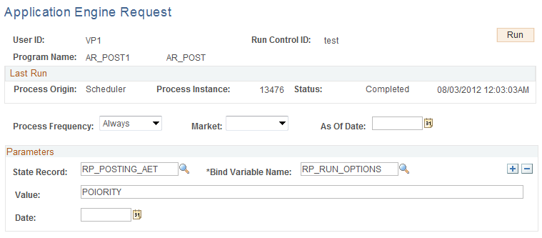

Use the Application Engine Request page (AE_REQUEST) to modify the steps for a run control ID for AR_POST#.
Navigation:
This example illustrates modifying run parameters for the AR_POST1 process on the Application Engine Request page.
Enter the name of the appropriate AR_POST# program, such as AR_POST1.
Use the State Record, Bind Variable Name, and Value fields to define exactly what data to post. This enables you to process smaller units of data. Add as many rows as needed.
Setting PRIORITY Parameters
Enter PRIORITY in the Value field to give priority to groups whose posting action is Batch Priority. PRIORITY is designed to run on a recurrence definition that directs the system to run periodically throughout the day to pick up only new priority groups. You define recurrence definitions by using the Process Scheduler when you indicate how often to run the Receivables Update process (for example, hourly, or daily).
The following table describes PRIORITY and provides sample field values.
Description |
Sample Field Values |
Run PRIORITY as needed. Suppose that you have 10 business units and 5 different run control IDs, each specifying different combinations of business units by user ID. During the day, you want to post groups set to PRIORITY for any of the 10 business units. To do this, add a Receivables Update request with a new run control ID (for example, URGENT) that specifies all 10 business units. Add the PRIORITY run option as a parameter on the Application Engine request for the run control ID you created by adding an additional line. |
Program name: AR_POST#, such as AR_POST1 State record: RP_POSTING_AET Bind variable name: RP_RUN_OPTIONS Value: PRIORITY Note: After you enter the run parameters, assign the Receivables Update request to a Process Scheduler job with a scheduled run recurrence that runs every hour (for example, HOURLY). By selecting the hourly recurrence and initiating this job, direct the system to process all PRIORITY groups each hour for each of the specified business units. You can set up multiple PRIORITY server jobs to run at different intervals, processing a few business units in each job or processing only certain group types. |
Note: You do not need to set up an RP_RUN_OPTIONS for a Batch Standard run control. With standard processing, the system processes groups with either a Batch Priority or Batch Standard posting action. A standard scheduled job processes any priority groups that have not been processed since the last scheduled PRIORITY run.

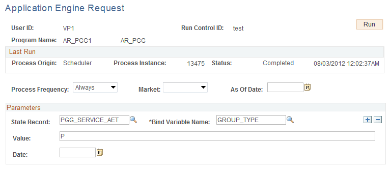

Use the Application Engine Request page (AE_REQUEST) to modify the steps for a run control ID for AR_PGG#.
Navigation:
This example illustrates run parameters for AR_PGG1 on the Application Engine Request page.
Enter the name of the appropriate AR_PGG# program, such as AR_PGG1.
You use the State Record, Bind Variable Name, and Value fields to define exactly what data to process. Add as many rows as needed.
This table shows how you can narrow the scope of what the process posts.
Description |
To generate accounting entries for only group type P. |
State record: PGG_SERVICE_AET Bind variable name: GROUP_TYPE Value: P |
Add a parameter to specify the chunking method. You are limited to chunking by one field only, but you are not limited to specific values. |
State record: PGG_SERVICE_AET Bind variable name: AE_CHUNK_BY Value:
