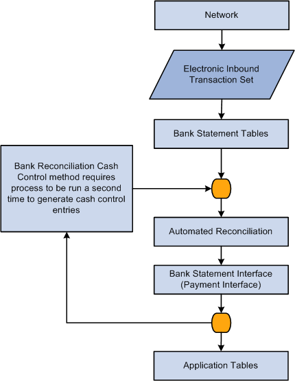

The following diagram illustrates how the Electronic Banking process works in PeopleSoft Receivables. The Bank Statement Application Engine process (BSP_IMPORT) imports the electronic statement and loads the bank statement data from the staging tables to the Bank Statement tables. The Bank Reconciliation Application Engine process (BNK_RECON) runs and reconciles the bank statement at the payment level. Unreconciled payments are loaded into the payment application tables. The Bank Reconciliation Cash Control process must be run twice to generate cash control entries.
Process Flow for Electronic Banking
