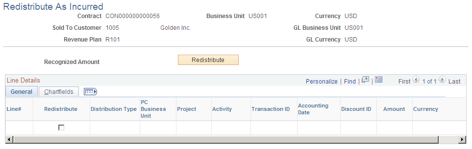

Use the Redistribute As Incurred page (CA_AP_PC_SUMMARY) to redistribute revenue accounting lines that the system has generated for an as-incurred revenue plan.
The system limits redistribution of revenue to departments only.

This example illustrates the fields and controls on the Redistribute As Incurred page. You can find definitions for the fields and controls later on this page.
Redistribute As Incurred Page: General Tab
Field or Control |
Description |
Line # |
Displays the contract line number that you associated with the revenue plan. |
PC Bus Unit (PeopleSoft Project Costing business unit) |
Displays the PeopleSoft Project Costing business unit with which a contract line is associated. Each contract line is associated with only one PeopleSoft Project Costing business unit. Each contract line and projects business unit combination is reflected in as many rows as there are unique ChartField string combinations for the project ID, activity ID, and resource ID. |
Project |
Displays the ID with which this billing is associated. A single project ID can be associated with multiple contracts. |
Activity ID |
Displays the ID with which this billing is associated. Contract lines are linked to projects at the activity level—directly or indirectly. Each activity ID can be associated with only one rate-based contract line. |
Transaction ID |
Displays the ID with which this billing is associated. |
Accounting Date |
Displays the accounting date, which reflects the accounting period in which the entries were booked. |
Amount |
Displays the amount of revenue, in the PeopleSoft General Ledger business unit base currency, that was booked for this row. |
