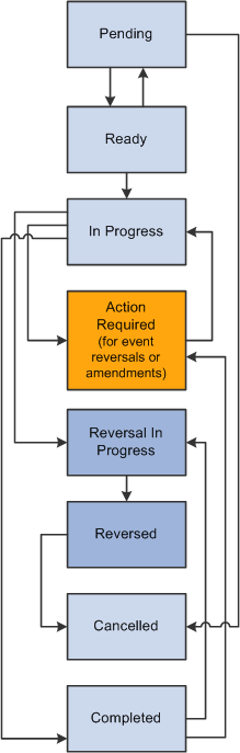

Understanding Revenue Plan Status
There are eight status values for a revenue plan:

Revenue Plan Status Flow
This diagram depicts the flow between revenue plan status values:
The flow between revenue plan status values is depicted

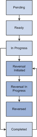

There are seven revenue plan event statuses:
Term |
Definition |
Pending |
Appears by default status when you define a new revenue plan event. Revenue plan events with this status are not subject to system edit checking. |
Ready |
Setting an event to Ready makes it available for processing. The system sets apportionment and percent complete events to a status of Ready by default. |
In Progress |
Appears automatically once the revenue recognition event has been processed by the system by using the Revenue Recognition Application Engine process (CA_LOAD_GL1 for amount-based revenue and PSA_ACCTGGL for rate-based revenue). Events marked with this In Progress status are overlooked by future revenue processes. |
Completed |
Appears for both amount-based and rate-based revenue when you run the Application Engine (CA_LOAD_UPD) process. |
Reversal Initiated |
The system sets this status when you select the Reversal Initiated option and click the Update Event Status button on the Review Revenue - Events page. Selecting this option triggers the system to generate a reversal for the selected revenue plan events the next time that CA_LOAD_GL1 is run. At the same time that the system sets the event status to Reversal Initiated, the system also changes the revenue plan status from In Progress or Completed to Action Required. This indicates that you need to manage the revenue plan events to ensure that you update or define events for event level reversal amounts. |
Reversal In Progress |
The system sets this status when the application engine begins the reversal generation process. |
Reversed |
Appears when you have completed the revenue plan event reversal. You cannot reuse a reversed event (in other words, you cannot set the status back to Pending or Ready). Instead, you must add new events to the revenue plan. Note: You cannot reverse events for as-incurred revenue plans. |
Understanding the Relationship Between the Revenue Plan Status and Revenue Plan Event Status
The ability to edit revenue plan events depends on the status of your revenue plan:
When the revenue plan status is Pending, you can freely edit your revenue plan events.
When the revenue plan status is Ready or In Progress, you can edit revenue plan events with a status of Pending or Ready.
When you reverse an event and the status of the revenue plan changes to Action Required, you can add new revenue plan events or edit revenue plan events with a status of Pending or Ready.
In addition, the following relationships apply:
Once the first revenue recognition event status changes to In Progress, the status of the revenue plan also changes to In Progress.
An amount-based revenue plan cannot be set to Completed by the system until all associated events are either Reversed or Completed and the event totals sum to 100 percent.
A rate-based revenue plan cannot be set to Completed by the user until all associated events, if any, are Completed.
If you reverse a revenue recognition event, the status of the revenue plan changes to Action Required.
Changing a Revenue Plan Event Status to Ready
The process for changing a revenue plan event status from Pending to Ready differs based on the revenue recognition method you are using. The system sets the status of apportionment and percent complete events to Ready upon creation. For milestone and as incurred revenue recognition methods, you can change an event status to Ready from the Review Revenue - Events page. From this page you can view all events matching your search criteria, and then set individual events to Ready (or back to Pending).
For percent complete revenue plans, access the Revenue Plan page, where you can manually update the total percent complete as of the date on which you are making the entry. The system uses this entry to generate the event on the revenue plan. As a result, you must make this entry on the revenue plan itself.
Changing a Revenue Recognition Event Status to In Progress
The revenue recognition event status is moved to In Progress when you run the Revenue Recognition Application Engine (CA_LOAD_GL1 for amount-based revenue and PSA_ACCTGGL for rate-based revenue). The Journal Generator Application Engine books all revenue associated with a revenue plan event to PeopleSoft General Ledger.
Changing a Revenue Recognition Event Status to Completed
When you run the post-Journal Generator process (CA_LOAD_UPD), the system updates the revenue recognition event status to Completed for both amount-based and rate-based revenue. For amount-based revenue, if all events for a revenue plan are booked and the event total equals 100 percent, the system also updates the revenue plan status to Completed. For rate-based revenue, the user must manually update the revenue plan status to Completed. (All revenue recognition events must have a status of Completed.)
Changing a Revenue Recognition Event Status to Reversal Initiated
At the same time that the system sets the event status to Reversal Initiated, the system also changes the revenue plan status from In Progress or Completed to Action Required. This indicates that you need to manage the revenue plan events to ensure that you update and define events for event level reversal amounts.
Changing a Revenue Recognition Event Status to Reversal in Progress
The system sets this status upon the reversal process picking up the events with a status of Reversal Initiated for processing.
Changing a Revenue Recognition Event Status to Reversed
The system sets this status when you run the post-Journal Generator process (CA_LOAD_UPD). You cannot reuse a reversed event (in other words, you cannot set the status back to Pending or Ready). Instead, you must add new events to the revenue plan.
Revenue Event Status Flow
This diagram depicts the flow between revenue event status values:
