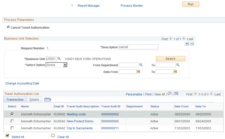

Use the Cancel Travel Authorizations page (EX_BGTCHK_TAUTH) to cancel submitted or approved travel authorizations in batch mode.
Navigation:
This example illustrates the fields and controls on the Cancel Travel Authorizations page.
Business Unit Selection
Field or Control |
Description |
Description |
Enter a description of the defined set of parameters. |
Business Unit |
Select a valid business unit. |
Search |
Click to retrieve transactions based on the criteria specified. If you do not enter any criteria, PeopleSoft Expenses retrieves and displays all eligible transactions. |
Select Option |
Select All to retrieve all eligible travel authorizations. Select Some to select by business unit, department, or date criteria. |
From Department and To |
Enter a value as criteria to select travel authorizations. The system retrieves all travel authorizations with department numbers that fall within the specified range in the criteria. |
Date From and To |
Enter a value as criteria to select travel authorizations. The system retrieves all travel authorizations with dates that fall within the dates specified in the criteria. |
Change Accounting Date |
Click to access the Change Accounting Date page to specify a different accounting date. The accounting date determines which accounting periods the reversals will be recorded in for the travel authorizations processed in this run. This link appears only if the Reversal Date Option on the Installation Options page is set to Current. |
