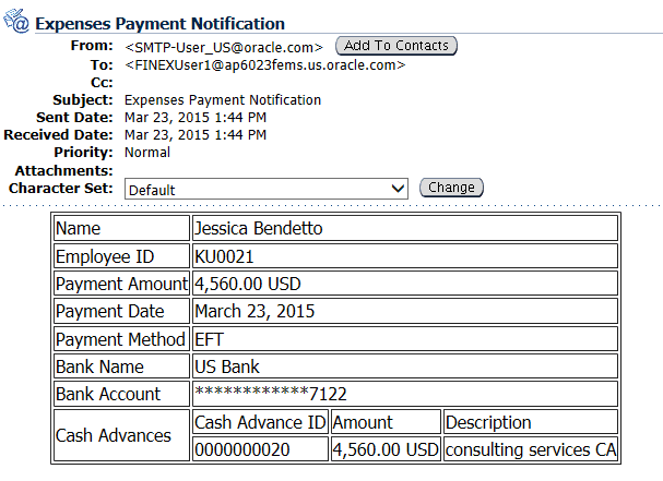

This example illustrates the fields and controls on the Expense Payment Notification. You can find definitions for the fields and controls later on this page.
After the Process Scheduler has run successfully, an e-mail notification is sent to the employee. The e-mail notification contains the following information:

Name  |
 Displays the name of the employee.  |
Employee ID  |
 Displays the employee ID for the employee.  |
Payment Amount  |
 Displays the amount for payment.  |
Payment Date  |
 Reflects the date when the payment was transmitted.  |
Payment Method  |
 Displays the method used to make the payment. PeopleSoft Expenses supports the following payment methods:
 Note: When the payment is done using CHK (System check), the fields Bank Name and Bank Account are not displayed in the e-mail notification.  |
Bank Name  |
 Display the name of the Bank (when the payment is done using ACH (Automated Clearing House) or EFT (Electronic Funds Transfer)).  |
Bank Account  |
 Display the Bank Account ID (when the payment is done using ACH (Automated Clearing House) or EFT (Electronic Funds Transfer)). PeopleSoft Expenses masks the account ID so that only the last 4 digits of the bank account ID are displayed.  |
Expense Report ID or Cash Advance ID  |
 Displays the Expense Report number or the Cash Advance number.  |
Amount  |
 Displays the total amount paid to the employee on each Expense Report or Cash Advance within this payment.  |
Description  |
 Displays the description of an Expense Report or about Cash Advance available under the header of an Expense Report or a Cash Advance.  |

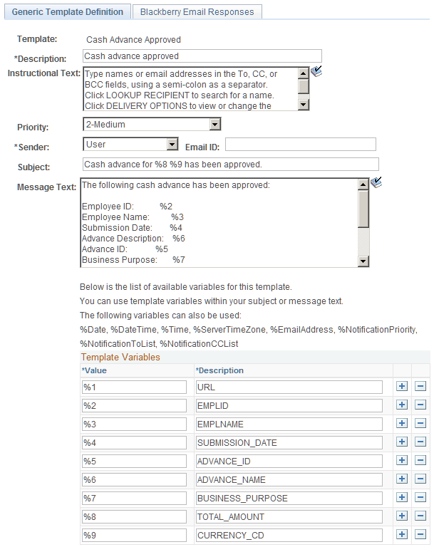

Use the Generic Template Definition page (WL_TEMPLATE_GEN) to set up or modify notifications for the approval process under the Approval Framework.
Navigation:
This example illustrates the fields and controls on the Generic Template Definition page (1 of 2). You can find definitions for the fields and controls later on this page.
Use generic templates to establish common formats for ad hoc notifications.
