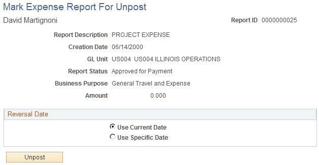

Use the Mark Expense Report For Unpost page (EX_UNPOST_SHEET) to mark expense reports for unposting.
Navigation:
This example illustrates the fields and controls on the Mark Expense Report For Unpost page. You can find definitions for the fields and controls later on this page.
The information on this page comes from the expense report description.
The information on the Mark Expense Report for Close page comes from the expense report description.
Reversal Date
Field or Control |
Description |
Use Current Date |
Select to use the current date on which to reverse the accounting liability entries. |
Use Specific Date |
Select to enter a specific date. When selected, PeopleSoft Expenses opens a field to enter the day on which to reverse the accounting liability entries. |
Unpost |
Click to save the expense report with a status (POST_STATUS_EX) of Mark for Unpost. |

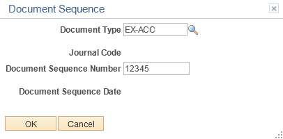

Use the Document Sequence page (TE_SHT_DOCSEQ_INFO) to enter document sequencing information about unposted expenses reports.
Navigation:
Click the Document Sequencing link on the Mark Expense Report for Unpost page.
This example illustrates the fields and controls on the Document Sequence page. You can find definitions for the fields and controls later on this page.
If you use document sequencing, you can enter the document type that is associated with the expense report that you mark for unposting. The unpost process adjusts the document sequence numbering based on the document type that you select.
