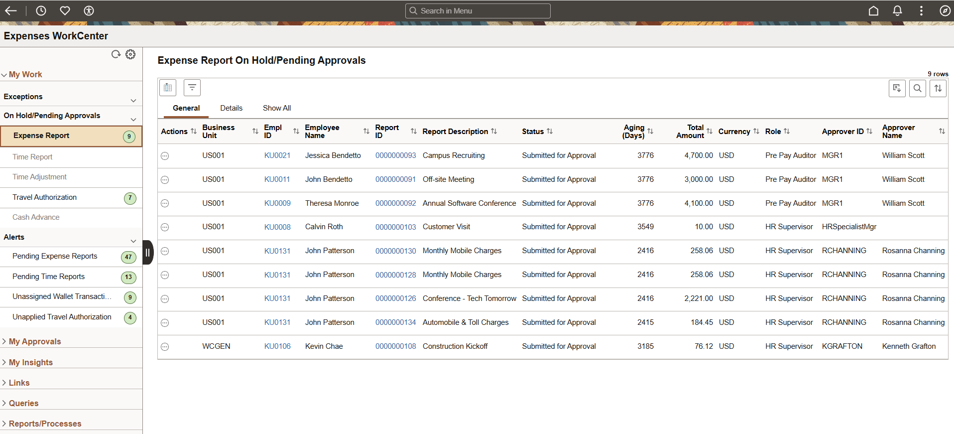

Use the On Hold/Pending Approvals links to review transactions that are pending approval or on hold.
The On Hold/Pending Approval section has the following transactions:
Expense Report
Time Report
Time Adjustment
Travel Authorization
Cash Advance
You have the option to view these transactions in the right pane or to open the transaction in a new window. Select the transaction ID to open the transaction in a new window and view the details.
The Travel and Expenses back office monitors the approval process to ensure the reviewer, approver or auditor complete their task in a timely manner. A back office user assigned to complete the pending/on-hold status can directly access the WorkCenter and complete the approval process or remove the on-hold status.

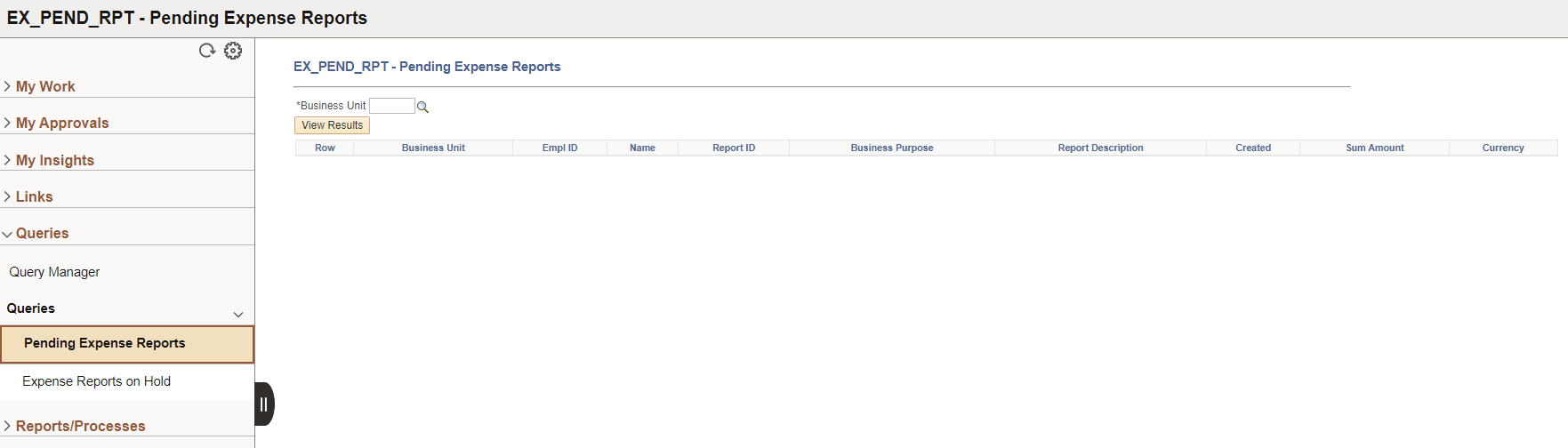

Pending Expense Reports |
Select this option to monitor unused expense reports, notify employees about unused expense reports, or delete a transaction. |

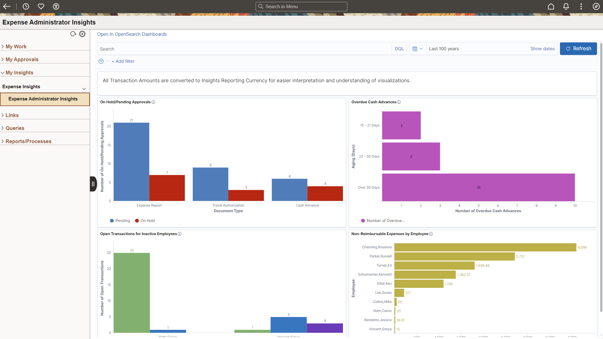

Use the Expenses WorkCenter - My Insights (Fluid) grouplet to access Insights dashboards related to travel and expenses.
Navigation:
From a Fluid Expenses Homepage, select the Expenses WorkCenter tile, and expand the My Insights grouplet.
This example illustrates the fields and controls on the Expenses WorkCenter - Links (Fluid) grouplet.
For additional information about the visualizations, see Analyzing Expenses Using PeopleSoft Insights.

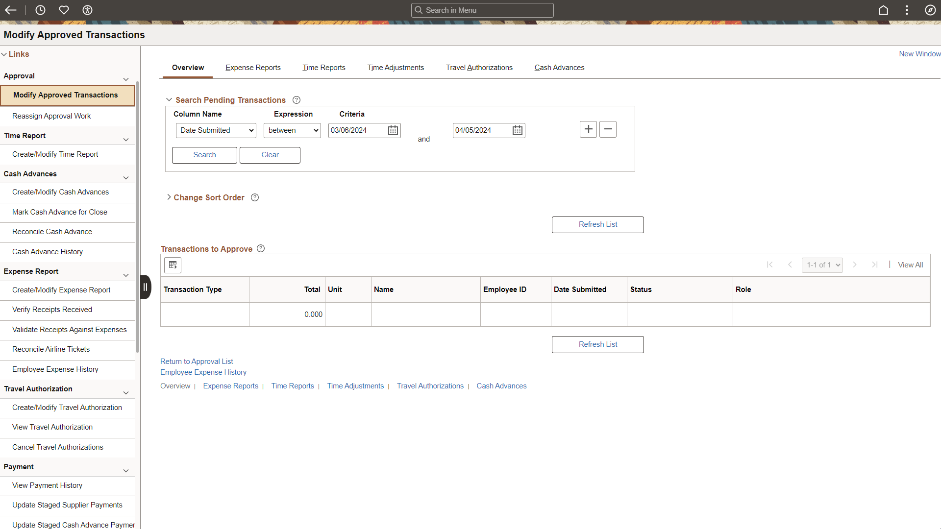

Use the Expenses WorkCenter - Links (Fluid) grouplet to access internal and external links that are frequently used.
Navigation:
From a Fluid Expenses Homepage, select the Expenses WorkCenter tile, and expand the Links grouplet.
These categories are available in this grouplet depending on user security:

Use the Expenses WorkCenter - Queries (Fluid) grouplet to access public and private queries.
Navigation:
From a Fluid Expenses Homepage, select the Expenses WorkCenter tile, and expand the Queries grouplet.
This example illustrates the fields and controls on the Expenses WorkCenter - Queries (Fluid) grouplet.

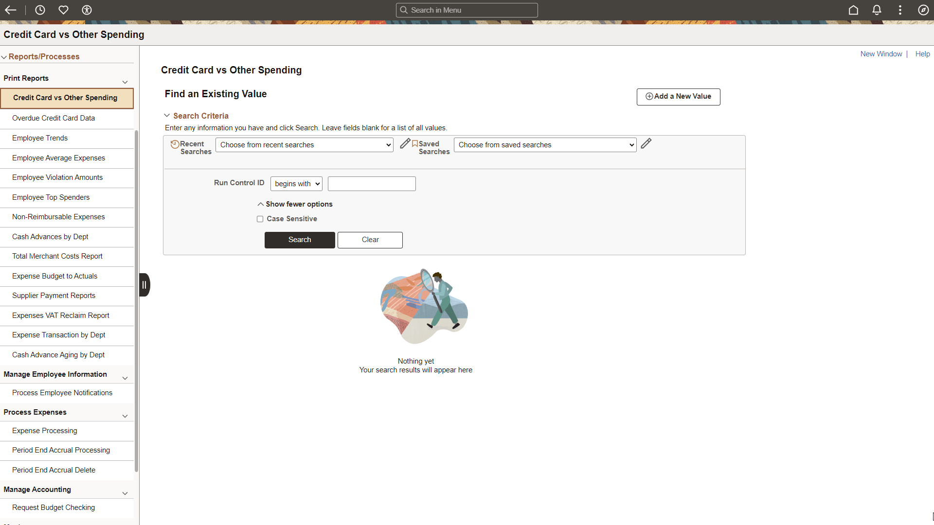

Use the Expenses WorkCenter - Reports/Processes (Fluid) grouplet to access system-defined reports and processes for which you have access.
Navigation:
From a Fluid Expenses Homepage, select the Expenses WorkCenter tile, and expand the Reports/Processes grouplet.
This example illustrates the fields and controls on the Expenses WorkCenter - Reports/Processes (Fluid) grouplet.
