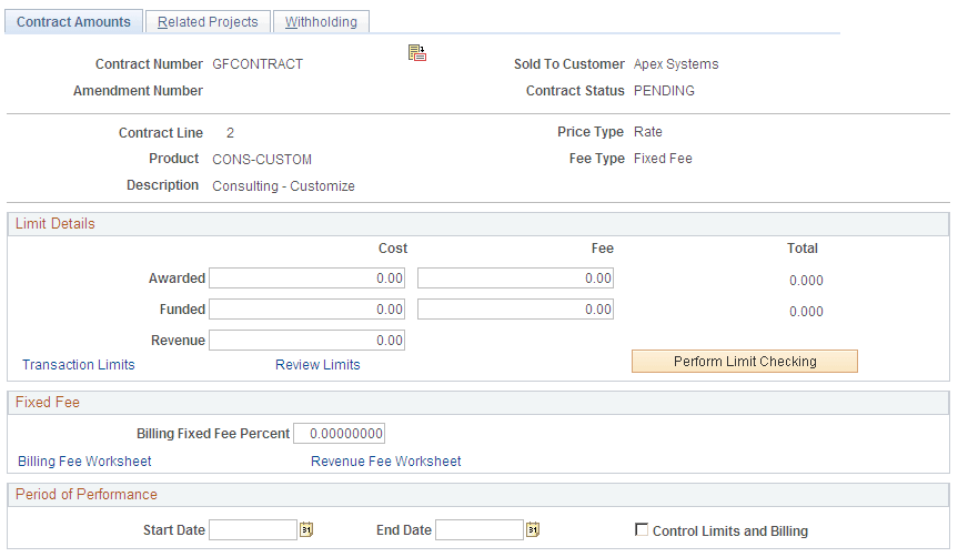

Fixed Fee
Field or Control  |
Description  |
Billing Fixed Fee Percent  |
 Enter the fixed fee percent amount for the contract line. The fixed fee percent is multiplied by the total funded costs to determine the total funded fee amount. The fixed fee amount represent the profit earned on top of total costs for performing the service or creating the product defined on the contract, but is subject to a limit.  |
Revenue Fee Worksheet  |
 Click to access the revenue fee worksheet and define, calculate and manage fixed fee percentages, limit amounts and fee amounts for revenue. This link only appears if you have selected the Separate Billing and Revenue check box on the Installation Options-Contracts page, and after the revenue plan is defined for the contract line.  |

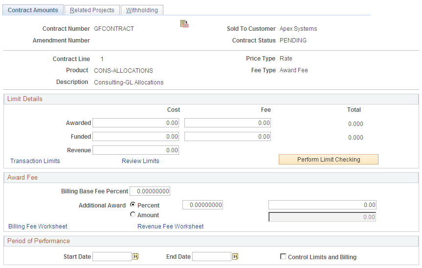

Access the Contract Amounts award fees.
This example illustrates the fields and controls on the Contract Amounts page (award fee type). You can find definitions for the fields and controls later on this page.
Award Fee
Field or Control  |
Description  |
Billing Base Fee Percent  |
 Enter the billing base fee percent amount for the contract line. The billing base fee percent is multiplied by the total funded costs to determine the total funded fee amount. The billing base fee amount represent the agreed upon profit percentage earned on top of total costs for performing the service or creating the product defined on the contract, but is subject to a limit. Note: If no base fee percentage is provided by the government, you can enter zero in this field, and the system will not calculate a base fee amount.  |
Additional Award  |
 Enter the additional award amount or percent available for work completed for this contract line. If you select the Percent option, and enter a percentage, the system multiplies the percentage by the funded cost amount and displays the result in the corresponding field. You can manually override the calculated amount if needed, or select the Amount option and enter the amount in the corresponding field.  |
 Click to access the revenue fee worksheet and define, calculate, and manage award fee percentages, limit amounts and fee amounts for revenue. This link only appears if you have selected the Separate Billing and Revenue check box on the Installation Options-Contracts page, and after the revenue plan is defined for the contract line.  |

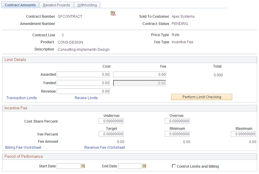

Access the Contract Amounts page for incentive fees.
This example illustrates the fields and controls on the Contract Amounts page (incentive fee type). You can find definitions for the fields and controls later on this page.
Incentive Fee
Incentive fee calculations are based on the funded and revenue limit amounts that you enter on this page. If you leave these fields blank, then the system cannot properly calculate the fee amounts for billing and revenue. Revenue fee limit amounts are only required if you have selected the Separate Billing and Revenue option on the Installation Options-Contracts page.
Field or Control  |
Description  |
Cost Share Percent: Underrun  |
 Enter the cost share underrun percentage that the system uses to adjust the target fee percentage that can be billed. Fee calculations are based on the funded cost amount.  |
Cost Share Percent: Overrun  |
 Enter the cost share overrun percentage that the system uses to adjust the target fee percentage that can be billed. Fee calculations are based on the funded cost amount.  |
Fee Percent: Target  |
 Enter the target fee percent that the system uses to calculate the target fee amount. Fee calculations are based on the funded cost amount.  |
Fee Percent: Minimum  |
 Enter the minimum billable fee percentage for the contract line. Fee calculations are based on the funded cost amount.  |
Fee Percent: Maximum  |
 Enter the maximum billable fee percentage for the contract line. This fee percent is used to calculate the funded fee limit amount by multiplying the maximum fee percent by the funded cost amount.  |
Fee Amount: Target  |
 Displays the calculated result of the target fee percentage multiplied by the funded cost amount.  |
Fee Amount: Minimum  |
 Displays the calculated result of the minimum fee percentage multiplied by the funded cost amount.  |
Fee Amount: Maximum  |
 Displays the calculated result of the maximum fee percentage multiplied by the funded cost amount.  |
 Click to access the revenue fee worksheet and define, calculate, and manage incentive fee percentages, limit amounts, and fee amounts for revenue. This link only appears if you have selected the Separate Billing and Revenue check box on the Installation Options-Contracts page, and after the revenue plan is defined for the contract line.  |

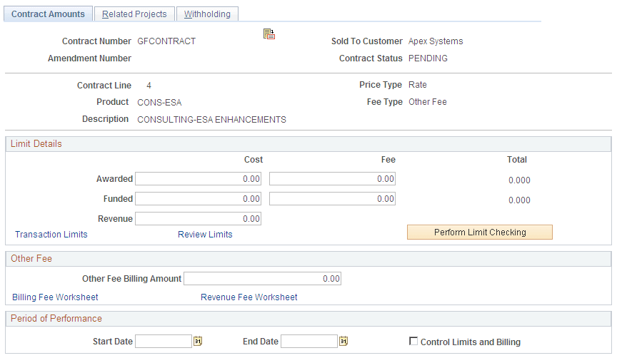

Access the Contract Amounts page for other fees.
This example illustrates the fields and controls on the Contract Amounts page (other fee type). You can find definitions for the fields and controls later on this page.
Other Fee
The fee type of Other is used to track and calculate fees that have no specific attributes. Using this fee type, you can enter a user-defined fee amount that is billed by the system each time that you run the fee process.
Note: You can also use this fee type to enable cost-plus functionality for your contract lines, but not generate fees by assigning the fee type of Other to the contract line and entering a fee billing amount of zero.
Field or Control  |
Description  |
Other Fee Billing Amount  |
 Enter the other billing fee amount for the contract line.  |
 Click to access the revenue fee worksheet and define, calculate, and manage fee limit amounts and fee amounts for revenue. This link only appears if you have selected the Separate Billing and Revenue check box on the Installation Options-Contracts page, and after the revenue plan is defined for the contract line.  |
