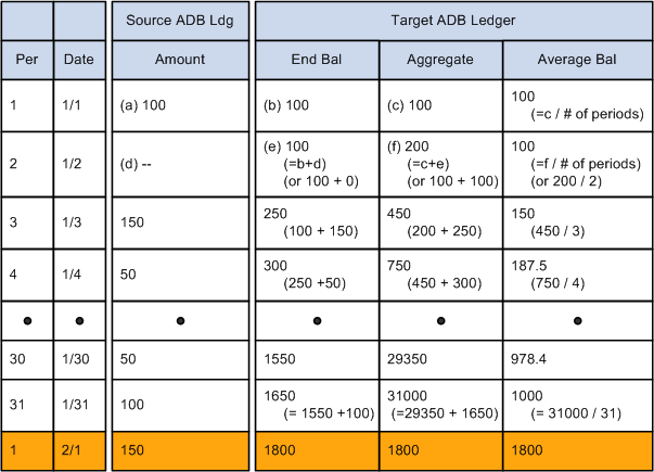

The following two tables illustrate incremental calculation by showing how February 1 is calculated using two different time periods (period types): year to date and month to date.
This table shows how the system calculates February 1 for a YTD (year to date) period.
Incremental Calculation for YTD
The following table shows how the system performs incremental year to date calculations:
Year-to-Date Example: Incremental ADB Calculation

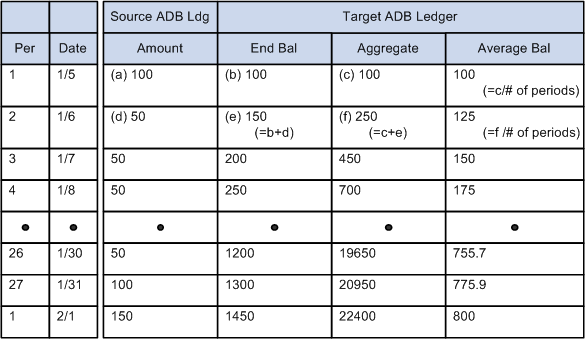

Incremental Calculation for MTD
Month-to-date balances are maintained until the last day of the month. On the first day of the new month, the ending balance of the prior month is carried forward to the beginning of the new month and the aggregate balance starts over. MTD is for the month only and the calculation does not include any amounts from any other period.
The following table shows how the system calculates February 1 for a MTD (month to date) period:
Month-to-Date Example: Incremental ADB Calculation
