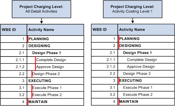

This diagram illustrates the activities that are available for charging based on the project charging level. In each example, the red vertical bars align with the activities to which to you charge:
These two diagrams provide examples of charging at the activity level one and at the activity detail level.
