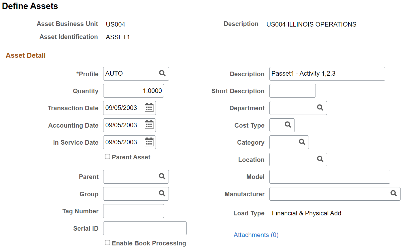

Use the Define Assets page (PC_AM_DEFN) to specify basic information about a project asset.
Navigation:
This example illustrates the fields and controls on the Define Assets page. You can find definitions for the fields and controls later on this page.
Some of the fields that appear in this topic are defined in the Common Elements Used to Manage Assets topic.
Note: PeopleSoft Project Costing can create capitalized rows and distribute them without integrating with PeopleSoft Asset Management. You can use the PeopleSoft Asset Management Loader tables, but you must create a custom process that PeopleSoft does not support to extract data from the tables.
When an asset definition is created in PeopleSoft Asset Management, information such as depreciation method, useful life, category, or group asset ID are inherited from the asset profile. You can override default values from the profile on this page.
Field or Control |
Description |
Transaction Date |
Enter the date that the asset transaction occurs. This date is used as the default value for the transaction date override on the Manual Capitalization Review page. The transaction date of an adjustment that you make after an asset is created must be equal to or greater than the previous transaction date. |
Accounting Date |
Enter the date for which the asset transaction is accounted. This date is used as the default value for the accounting date override on the Manual Capitalization Review page. |
Parent Asset |
Select to indicate the asset as a parent asset. |
Cost Type |
Enter the cost type for the asset. The Cost Type field (COST_TYPE) resides in the Project Transaction table as well as in the PeopleSoft Payables and PeopleSoft Purchasing systems that feed data to PeopleSoft Project Costing. Breakdown by cost type can occur for assets that are created from those transaction rows if the installation option Cost Type from Transaction is selected. If the Cost Type from Transaction installation option is not selected, only the cost type that you enter in this field is included with the asset. Note: To ensure data integrity in PeopleSoft Asset Management, after you specify the Cost Type from Transaction option during installation, do not change it. |
Model |
Enter the model identifier that is assigned to the asset. |
Load Type |
Displays the transaction load type that PeopleSoft Asset Management uses to determine the types of transactions that occur when the Load Transaction into Asset Management process loads rows into the Asset transaction tables. |
Interface Status |
Displays the status of the integration from PeopleSoft Project Costing to Asset Management, such as Pending or Generated. |
Enable Book Processing |
Select to enable the asset's transaction costs to be tracked by book in the PeopleSoft Asset Management system. |
Attachments |
Click to access the Define Asset Attachments page where you can add/ remove attachments. The number of attachments added to an asset is displayed next to the Attachments link. Note: For PeopleTools release 8.59 and later, you can select multiple files (maximum limit is 20) at a time to be included as attachments. |

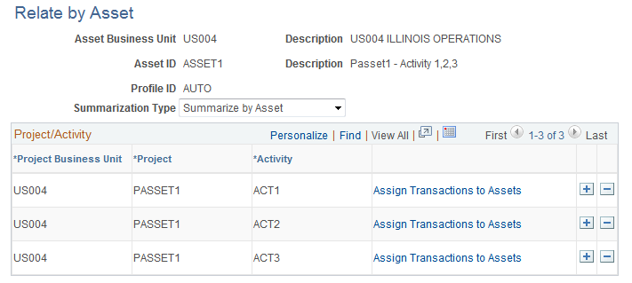

Use the Relate by Asset page to associate projects and activities to an asset for manual capitalization.
Navigation:
. Click the Relate by Asset link on the Relate by Project page
Note: You can relate a single asset to multiple projects and activities.
This example illustrates the fields and controls on the Relate by Asset page. You can find definitions for the fields and controls later on this page.
This page displays an asset's view of the data and it is used to associate an asset with project activities. Add rows to associate the asset with additional project activities.
Field or Control |
Description |
Assign Transactions to Assets |
Click to access the Assign Transactions to Assets page, which contains a list of assets for assignment to transactions. This link appears when you save the row. |

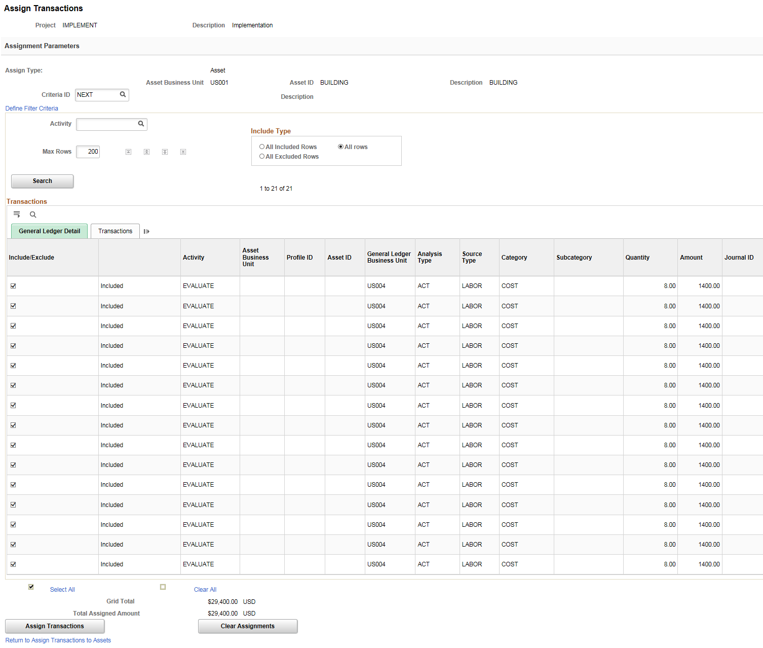

Use the Assign Transactions page (PC_AM_RESOURCES) to assign or clear transactions to a profile or asset.
View transactions that are eligible for asset assignment.
Navigation:
Click the Assign Transactions link on the Assign Transactions to Assets page after you save the row.
This example illustrates the fields and controls on the Assign Transactions page. You can find definitions for the fields and controls later on this page.
Use this page to:
Assign a group of transactions to a profile or an asset.
Clear a group of transactions from the profile or asset.
View transactions that are eligible or ineligible for asset assignment based on specific criteria.
Selectively override the criteria for individual transactions.
Field or Control |
Description |
Criteria ID |
Select a value or create a new criteria ID. To create a new ID, either enter a new ID or keep the default value of NEXT and let the system assign the criteria ID. |
Define Filter Criteria |
Click to access the Selection Criteria component, where you can view and edit existing filter criteria that determine which project activity costs to include in the asset. Note: The system determines which transactions are eligible for assignment based on the filter criteria and the value of the Asset Management Distribution Status field . Only transactions that have not been distributed to PeopleSoft Asset Management are eligible for assignment by using the Assign Transactions page. Transactions with an Asset Management distribution status value of D (distributed) are not eligible for assignment. |
Activity |
Enter an activity to display only the transactions that are associated with the specified activity. To display all transactions that are associated with the project, leave the Activity field blank. |
Max Rows (maximum rows) |
Enter the maximum number of rows to appear in the Transactions grid. This may result in fewer rows appearing in the grid than the number of transactions that are actually assigned to the asset. |
Include Type |
Select a filter that operates in conjunction with the Activity and Max Rows fields to determine the rows that appear in the grid. Available options are: All Included Rows: Displays transactions that meet the selection criteria and any manually included rows to be processed. All Excluded Rows: Displays transactions that do not meet the criteria or are manually excluded and are not to be processed. All Rows: Displays all transactions that meet the selection criteria. |
Search |
Click to retrieve all transactions that match the selected criteria and Include Type option. |
Note: The Activity, Max Rows, and and Include Type fields define only which rows appear in the grid. These fields are used for viewing only, whereas the Criteria ID field is used to filter rows. For example, assume that the filter criteria returns transaction rows with activities of PLAN, DEVELOP, and BUILD. You can enter a value of PLAN in the Activity field to view only the transaction rows in the PLAN activity. If you click the Assign Transactions button, the system stamps the asset information on all transactions from the PLAN, DEVELOP, and BUILD activities that the system returned based on the criteria ID.
Field or Control |
Description |
Include/Exclude |
Select check box to include or exclude transactions for asset capitalization. Initially when transactions are loaded for the first time, the Include/Exclude check box is selected by default for all transactions. After changes are done and saved for this field, the values are retained. In the subsequent column corresponding status will be displayed. |
Save |
Click to store the selections that are on this page. |
Warning! You must save the selections on this page before you click the Assign Transactions or Clear Assignments buttons. Otherwise, you will lose any unsaved actions when the assign or clear event occurs.
Field or Control |
Description |
Grid Total |
Displays the total value based on the Transactions grid output. |
Total Assigned Amount |
Displays the total amount that will be assigned for capitalization. |
Assign Transactions |
Click to assign and stamp an asset business unit, profile ID, and asset ID in the Project Transaction table for eligible transactions. This process defines how the system distributes project costs to assets. Note: When you click the Assign button, the system stamps and assigns all eligible rows, not just rows that are visible in the Transactions grid. You must relate assigned rows to the asset before they can be used to create an asset. You can assign a row then relate it to the asset after the asset is already created. Rows that are sent to an existing asset are treated as adjustments in the asset management system. Note: This button is not applicable for all rows excluded from processing. |
Clear Assignments |
Click to clear the asset business unit, profile ID, and asset ID from the grouped transactions. Note: This button is not applicable for all rows excluded from processing. |
Apart from the fields included for General Ledger Detail, there are additional fields such as Voucher, Supplier ID, PO ID, Report ID, Time Report ID, Work Order, Empl ID, and Invoice included for Transactions. Click the Transactions tab to access these fields.
Note: If an activity has transactions with a pending action, no additional transactions can be assigned to that activity until the pending transactions are interface to Asset Management. In other words, you must interface pending transactions to Asset Management before assigning additional transactions to the same activity.

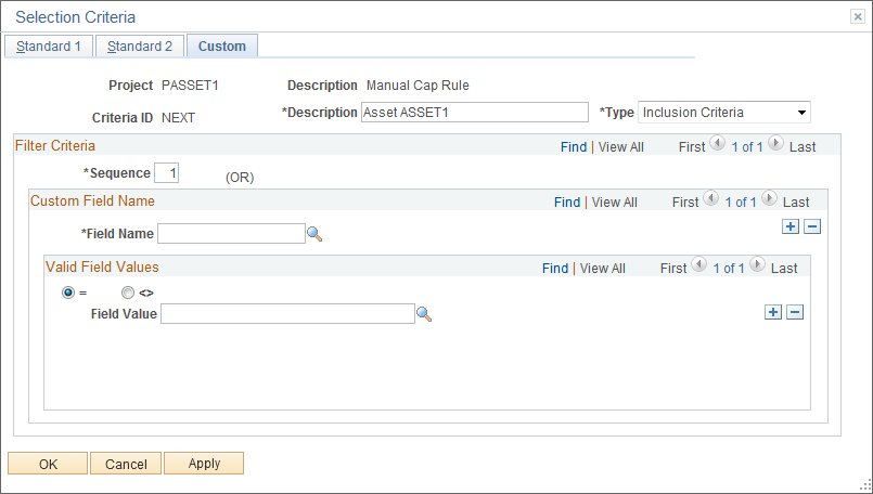

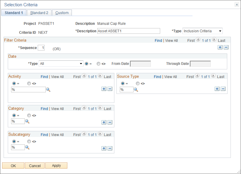

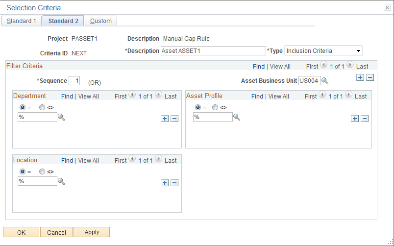

Use the Define Filter Criteria - Standard 1 page (PC_SEL_CRITERIA1) to define selection criteria for date, activity, and transaction fields.
Navigation:
Click the Define Filter Criteria link on the Assign Transactions page.
This example illustrates the fields and controls on the Define Filter Criteria - Standard 1 page. You can find definitions for the fields and controls later on this page.
Define criteria to determine what transactions are eligible to select transactions for asset assignment. You must define filter criteria each time that you create a new project for the manual capitalization process. The system stores manual capitalization filters at the project level, and the express capitalization filters at the project business unit level.
Field or Control |
Description |
Type (criteria) |
Choose to Include or Exclude transactions that meet the criteria. |
Sequence |
Enter the sequence number. A row that does not meet the criteria that is in sequence 1 is still included if it meets the criteria in a subsequent sequence. For each sequence, all field values must be met for the system to include a transaction row. |
Type (date) |
Select Accounting Date, Transaction Date, or the default value of All. |
= or <> |
Choose the operand to specify if transactions are included in the selection criteria if their date is equal to (=) or not equal to (<>) the selected date range. |
From Date and Through Date |
Select a date range if the date type is Accounting Date or Transaction Date. These fields are not available if you select a date type of All. |
Activity, Source Type, Category, and Subcategory |
Select operands and enter valid values for this project. |
Use the Define Filter Criteria - Standard 2 page (PC_SEL_CRITERIA2) to define selection criteria for department, activity location, and asset profile.
This is an extension of the Define Filter Criteria - Standard 1 page.
Navigation:
Select the Standard 2 tab on the Define Filter Criteria - Standard 1 page.
This example illustrates the fields and controls on the Define Filter Criteria - Standard 2 page. You can find definitions for the fields and controls later on this page.
Field or Control |
Description |
Description (criteria) |
Enter a description in the field or leave the default description from the Define Filter Criteria - Standard 1 page. |
Department |
Select from the list of departments that are defined for this business unit and project. |
Location |
Specify the location of each activity when defining the activity. This field refers to the location of the activity, not the location of the asset in PeopleSoft Asset Management. If you exclude location from the selection criteria, the system excludes all transactions that are associated with the activity. |
Asset Profile |
Select from the list of asset profiles that are based on the value in the Asset Business Unit field. |
Use the Define Filter Criteria - Custom page (PC_SEL_CRITERIA3) to include or exclude transaction fields from the criteria definition.
Navigation:
Select the Custom tab on the Define Filter Criteria - Standard 1 or Standard 2 page.
This example illustrates the fields and controls on the Define Filter Criteria - Custom page. You can find definitions for the fields and controls later on this page.
Field or Control |
Description |
Custom Field Name |
Select a field from the drop-down list box that is unique from the fields that are available on the Define Filter Criteria - Standard 1 and Standard 2 pages. |
Valid Field Values |
Select the operand to specify if the field name and its associated value is included (=) or excluded (<>) from the definition. |
