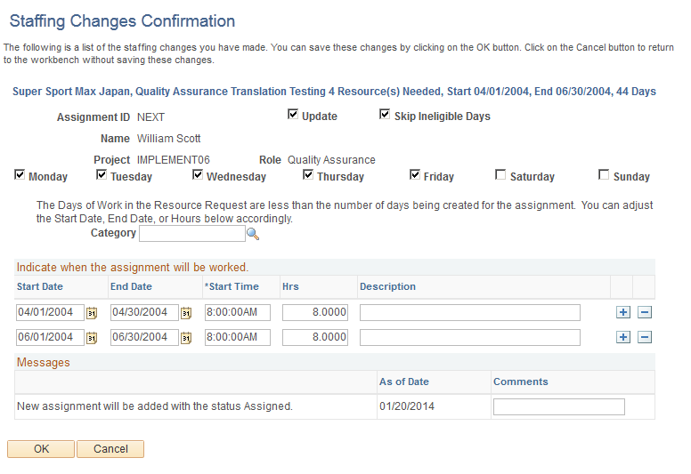

Staffing Changes Confirmation Page |
RS_SCWB_CONF_MSG |
View actions and modify default values before committing changes. Add comments for assignment activity. |

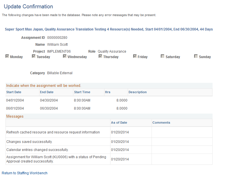

Update Confirmation Page |
RS_SCWB_CONF_MSG |
Confirm actions. |

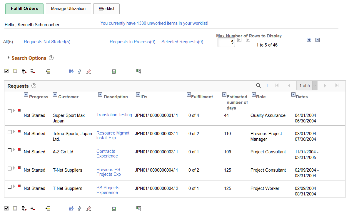

Requests
Upon entering the workbench, the scroll area displays a summary-level, collapsed row for each open resource request on a service order that is assigned to you. For each request, you can view:
Visual indicators that depict how close the current date is to the requested start date for requests.
Resource request fulfillment progress.
Summary information about the service order and resource request.
Visual Indicators
Each resource request row in the work space has a visual indicator that depicts how close the current date is to the requested start date for the request. This helps determine which requests need your attention first.

Resource Request Summary Rows
Rows in the Requests scroll area are collapsed when you enter the page. These rows provide resource request summary information.
Field or Control |
Description |
Click to expand or collapse individual resource request rows. Expanded rows display information about resources who are associated with a resource request. |
Click to sort the list of resource requests by the corresponding column heading in ascending or descending order. |
Progress |
Displays resource request fulfillment progress. In Process: At least one assignment—in any status—exists for this resource request. Not Started: No assignments exist for this resource request. |
Customer |
Displays the customer name that appears on the service order that is associated with this resource request. |
Description |
Click the resource request description link to access the Order Summary page to view or modify the service order or resource request. To return to the Staffing Workbench, click Save on the Order Summary or Resource Requests page, or click Return to Staffing Workbench. |
IDs |
Displays a concatenation of the business unit ID, service order ID, and resource request line ID. |
Fulfillment |
Displays the number of requested resources that are fulfilled, and the total number of resources requested. Note: For a requested resource to be treated as fulfilled, the resource assignment status must be Assigned. If you use PeopleSoft Services Procurement, and if a service requisition exists for this resource request, the requested quantity and number of requests that are filled or canceled in Services Procurement appear in this column. |
Days |
Displays the number of work days required to complete the project. |
Role |
Displays the project role that is specified on the resource request. |
Dates |
Displays the start and end dates of the request. If multiple date ranges are indicated on the request, this column displays the earliest start and latest end dates of those indicated date ranges. |

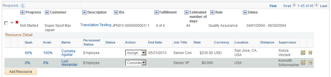

When you expand resource request summary rows, they display basic information about resources who are associated with the resource request, the resource's factor fit scores for the request, the resource's assignment status, and a link to the assignment, if applicable.
A resource may appear in the expanded row if:
An assignment for the resource exists for the resource request.
You are considering the resource for the resource request.
Resource Matching returns the resource in a search.
You retrieve bids and recommendation for the resource request.
You add this resource to the resource request row.
A more detailed discussion of the information that appears for each resource row is discussed in the Evaluating Candidates section of this topic.

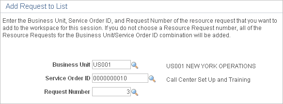

Add Resource Request to Grid
Click Add Request to List to search for specific resource requests to populate the Requests scroll area.
This example illustrates the fields and controls on the Staffing Workbench - Add Request to List page. You can find definitions for the fields and controls later on this page.
Field or Control |
Description |
Business Unit |
Enter the business unit of the service order that you want to locate. You must enter the business unit before you enter other values; it determines the valid service order IDs. |
Service Order ID |
Enter the service order. You can search for the service order by the person who is responsible for staffing it, customer ID or name, description, project, service order ID or status, or by the user ID of the individual who created the order. |
Request Number |
Enter a request number, or click the adjacent Lookup icon to view and select a resource request. If you don't select a value, the system adds all open resource requests that are associated with the selected business unit–service order combination to the Requests scroll area when you click OK. |

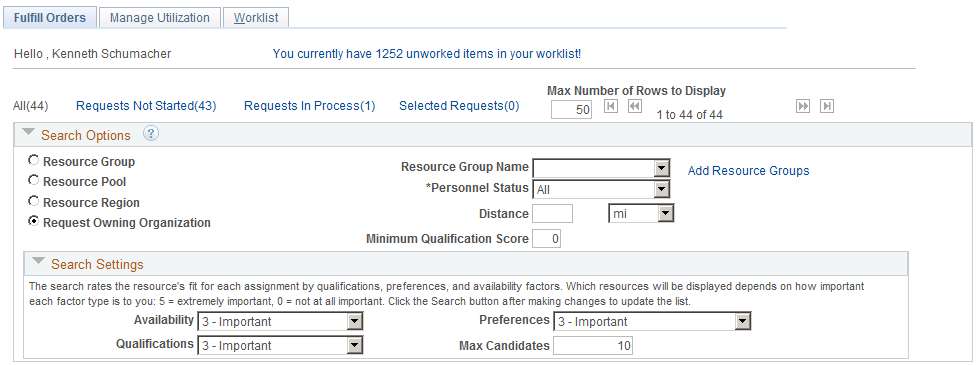

Expand the Search Options and Search Settings collapsible group boxes on the Staffing Workbench - Fulfill Orders page.
This example illustrates the fields and controls on the Search Options and Search Settings collapsible group boxes on the Staffing Workbench - Fulfill Orders page.
Note: Search options and search settings apply only when you click Search for Resources for selected Requests to perform a search by using Resource Matching.
To populate the workbench with resources based on the resource's factor fit scores for this request:
In the Search Options collapsible group box, specify the search options to direct your search to a Resource Group, Resource Pool, Resource Region,or the Request Owning Organization that is specified on the service order.
You can also specify Personnel Status, Distance and Minimum Qualification Score.
The Minimum Qualification Score option filters out all those Resources in the search results that do not meet the minimum qualification score specified. Only those Resources having a qualification score greater than, or equal to the specified minimum qualification score will be displayed in the search results.
If you select Resource Group, enter the Resource Group ID.
If you allow non-employees to be resources, select to include all personnel statuses, or just employees or non-employees, in your search.
In the Search Settings collapsible group box, assign the relative priorities to the Availability, Preferences, and Qualifications factor family fit scores for this search session, and identify the Max Candidates (maximum candidates) for the system to return.
Select the resource request rows for which you want to search for resources.
Click Search for Resources for selected Requests.
If selected resource requests are matched with resources based on the specified search options and the resources' factor fit scores, the resources appear in the Requests scroll area with the row expanded and a visual indicator that the corresponding resource was returned in the search results from Resource Matching.
The priorities that you specify during the search session are included in each resource's overall fit score calculations. The resources appear in descending order of their overall fit score, which measures how well a resource fits the specified qualifications, availability, and preferences; accounting for the organization's priorities; and the priorities that you specify during the search session. If you change the priorities and search again, Resource Matching recalculates overall fit scores, which potentially changes the order of resources.
Note: Because the qualification score is a combination of the resource's qualification and preferences fit scores, changing the relative priorities of qualifications and preferences may result in a change in the resource's qualification score shown in the workbench. If you only want to see the qualification score in the workbench, set the preferences search setting to 0 - Not at all important. The actual values of Qualifications, Preferences, and Availability will appear in the Job Scorecard. Those values are not affected by the search settings.
See Overall Fit Score.

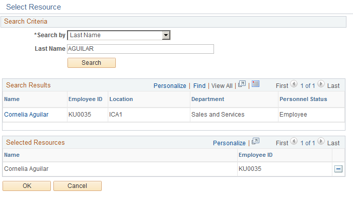

Click Add Resource on a corresponding resource request row to access the Select Resource - Resource Search page.
This example illustrates the fields and controls on the Select Resource - Resource Search page.
To directly add resources to the Resources grid for a resource request:
Search for a resource by employee ID or name.
Select one or more resources from the search results to move to the Selected Resources grid.
Continue searching and selecting resources as needed. Delete rows from the Selected Resources grid as needed.
Click OK.
The selected resources appear in the Requests scroll area beneath the resource request summary row.

Resources who meet the search criteria for a resource request appear under the resource request summary row.
This example illustrates the fields and controls on the Expanded Requests scroll area on the Staffing Workbench - Fulfill Orders page. You can find definitions for the fields and controls later on this page.
If selected resource requests are matched with resources based on the specified search options and the resource's factor fit scores, the resources appear in the Requests scroll area with the row expanded. You can click Selected Requests to hide all other resource request rows from view.
Expanded rows display basic information about resources, the resource's factor fit scores for the request, the assignment status (if applicable), and a link to the resource profile and job scorecard.
Field or Control |
Description |
Qual. (qualification) and Avail. (availability) |
Displays the qualification and availability fit scores, which indicate how closely the resource's profile and schedule match the resource request. The qualification fit score is composed of the qualification and preferences factor family fit scores. Click either fit score link to access the Job Scorecard for <Resource> page and view details about requirements that are included in the resource's fit score calculation for each factor family. Note: The qualifications, preferences, and availability scores represent the actual scores of the resource for the request. The scores that appear on the workbench may vary from the Job Scorecard. The scores that appear on the workbench are based on the specified search settings and may vary depending on the relative weights that you define for the settings. |
Name |
Click the resource name link to open the resource profile in a new page. To return to the Staffing Workbench, either close the resource profile page or click in the Staffing Workbench page. |
Personnel Status |
Displays the resource's personnel status from the Personal Data table (PERSONAL_DATA). This column appears only if you allow non-employees to be established as resources. |
Status |
Displays the assignment status and provides a link to the assignment if the resource is assigned to the resource request. Click the status link to access the Assign Resource page to view or update the assignment. To return to the Staffing Workbench, either close the assignment page or click in the Staffing Workbench page. Note: The search settings that you specify on the workbench do not impact the job scores of the resources that appear in the Requests scroll area with a value in the Status column. This field is blank if a resource is associated with the request through a bid or recommendation, or was placed on the workbench as a result of Resource Matching, or a direct search. |
Action |
Select the appropriate action to take on this resource. Available values are based on the resource's current assignment status for this resource request and your user role security. Values are: Assign: Select to assign the resource for this resource request. The assignment appears on the confirmation pages for you to edit and verify. Based on assignment approval workflow options that you specify at implementation, the assignment is automatically routed to the resource manager and project manager for approval after you save and confirm the actions on the workbench. The next time you refresh the Staffing Workbench and this resource request appears in the Requests scroll area, the resource's assignment status will be Pending Approval. The assignment remains in a pending status until it is approved or canceled. If assignment approval workflow is not enabled, or if the user that creates the assignment is the required approver, the assignment can be saved in a status of Assigned without triggering assignment approval workflow. Note: Assignments that you create from the Staffing Workbench are based on the resource schedule, not the project schedule. Cancel: Select to cancel an existing assignment. Consider: Select to associate the candidate with the resource request as someone whom you are considering as a possible match. This is not an assignment status. Interview, Propose, or Reserve: Select to create an assignment for the selected resource as soon as you save the actions on the workbench. The assignment appears on the confirmation pages for you to edit and verify. Complete: Complete an assignment that is in an Assigned status. See Assignment Statuses. |
Job Title |
Displays the resource's job title from the Job table (JOB). |
Rate |
Displays the resource's bill rate and currency as specified for the resource's employee ID on the Rates by Employee table (PC_RATE_EMPL). If no bill rate is specified for the employee ID, the value is the rate that is associated with the job code in the Job Code Rates table (PC_RATE_JOBC). If neither value exists, the bill rate value is 0.00. |
Location |
Displays the location of the resource from the Personal Data record. |
Supervisor |
Displays the name of the resource's supervisor from the Job record. |
Click the View resource assignment list icon to access the Assignments for <Resource> page in a new page and view the resource's current assignments, bids, recommendations, and assignment history. This information is useful for evaluating the true availability of candidates, as there may be assignment activity that does not appear on their schedule or that impacts their availability score. Close the browser to return to the workbench, or leave the Assignments for <Resource> page open and click the workbench page. |
Click the View monthly calendar icon to access the resource's monthly schedule in a new page and view the assignments and appointments schedule. Close the browser to return to the workbench, or leave the schedule open and click the workbench page. |
Click the Request Schedule Gantt Chart icon to access the Request Schedule Gantt Chart view on the Staffing Workbench - Fulfill Orders page.
This example illustrates the fields and controls on the Request Schedule Gantt Chart view.
Both the Requests scroll area and the Gantt chart view contain open resource requests that appear in the active filter—all requests, requests not started, requests in process, or just selected requests. If you select a filter while viewing the Requests scroll area and then switch to the chart view, the same filter is used to display resource requests in the chart. If you are in the chart view and you select a new filter, then revert back to the Requests scroll area, the newly selected filter applies.
The request schedule Gantt chart displays:
Resource request schedules for the next quarter beginning with the current date, with navigation icons to move to the previous or next quarter.
The customer name, service order description, business unit, and resource request ID.
Chart bars that represent the request days of work, start and end dates, and the lag time between the request period days and days of work.
Gray bars that represent any period of time that falls outside of the overall date range.
Blue bars that represent the resource request days of work.
Red bars that represent the lag time between the overall date range and the days of work.
Move your mouse across a blue or red bar to view alternate text about the resource request days of work and the number of resources who are needed.
Click a resource request chart bar to return to the Requests scroll area with the Selected Requests filter active and the resource request row selected and expanded.

When you save the actions on the Staffing Workbench, the Staffing Changes Confirmation page appears and explains the changes to be made for every selected resource request. When you accept the changes, the Update Confirmation page appears and confirms that the changes were successful.
Use these pages to confirm that:
An assignment is created for an action of Assign, Interview, Propose, or Reserve for a resource who is not already assigned to this resource request.
If assignment approval is required, the status of the assignment changes to Pending Approval.
The status of an existing assignment for a resource is changed according to the specified action.
Any workflow that is associated with the status change is invoked when you confirm the staffing changes.
Assignment history is updated when you confirm the staffing changes.
This example illustrates the fields and controls on the Staffing Changes Confirmation page. You can find definitions for the fields and controls later on this page.
Note: The information that appears on the Staffing Changes Confirmation page and Update Confirmation page differs based on the source of the action. If you initiate an action from the Staffing Workbench - Fulfill Orders page, the resource request description appears at the top of the update section on the confirmation pages. If you initiate an action from the Staffing Workbench - Manage Utilization page, the resource description appears at the top of the update section on the confirmation pages.
The system displays a summary of the changes for each resource request row that is selected at save time. If there are no changes for a selected row, the message No actions indicated for this Resource Request appears.
You can modify the assignment values that appear on the Staffing Changes Confirmation page.
Field or Control |
Description |
Update |
Select to confirm the change and update the assignment, resource request, resource schedule, and other workflow. Deselect this check box to cancel the updates. The check box is selected by default. |
Skip Ineligible Days |
If you select this value, then you can create an assignment for a resource with ineligible days within the date range. An error message will be displayed if you try to create an assignment with ineligible dates in the specified date range and do not select this value. This field is only available for edit at the time of assignment creation. |
Monday, Tuesday, Wednesday, Thursday, Friday, Saturday, and Sunday |
View the default or existing work days for the assignment, and modify them as needed by selecting or deselecting the appropriate check boxes. A message appears if the number of assignment days is more or less than the number of requested days. You can adjust the date range and hours on the Staffing Confirmation page to synchronize the schedule on the assignment and the resource request. If you use PeopleSoft Resource Management without PeopleSoft Program Management, and you select the Do not schedule assignments on Holidays option on the Installation Options - Resource Management page, the system does not schedule assignments on days that have tasks with a Scheduled Holiday task category. |
Category |
Enter the task category that appears as the category on the resource assignment. The default value is based on the value in the Category field on the resource request. You can modify the default task category value on the Staffing Changes Confirmation page. If the service order originated on the Manage Generic Resources page in PeopleSoft Program Management, and you modify the default task category value on the Staffing Changes Confirmation page, the new value appears in the Category field on the Resource Details page in PeopleSoft Program Management. In this situation, the new value also appears in the Category field on the resource request. |
Start Date and End Date |
View the default or existing dates for the assignment, and modify them as needed. To accommodate a noncontiguous schedule, add a row for each nonconsecutive start and end date range for a single assignment. |
Start Time and Hrs (hours) |
View the default or existing start time and hours for the assignment, and modify them as needed. |
Description |
Enter a description of the date range. |
OK |
Click to save the specified actions and access the Update Confirmation page. |
Update Confirmation
Use the Update Confirmation page (RS_SCWB_CONF_MSG) to confirm actions.
Navigation:
Click OK on the Staffing Changes Confirmation page.
This example illustrates the fields and controls on the Update Confirmation page.
Verify the changes and confirm that they occurred as expected. Click Return to Staffing Workbench to return to the Requests scroll area and view your changes.
New assignments for the resources in the Requests scroll area now appear with an active link in the Status column under the associated resource request summary row. Assignments that are created in the Staffing Workbench are populated with values from the resource request, and the system places the resource on the assignment with the designated action status. You can click the status link to access the Assign Resource page and view or modify the assignment.
Note: If you select the action Assign and assignment approval is required, the next time that you view the resource's assignments or refresh the Staffing Workbench, the resource's assignment status will be Pending Approval. The assignment remains in a pending status until it is approved by the required approver or canceled.
