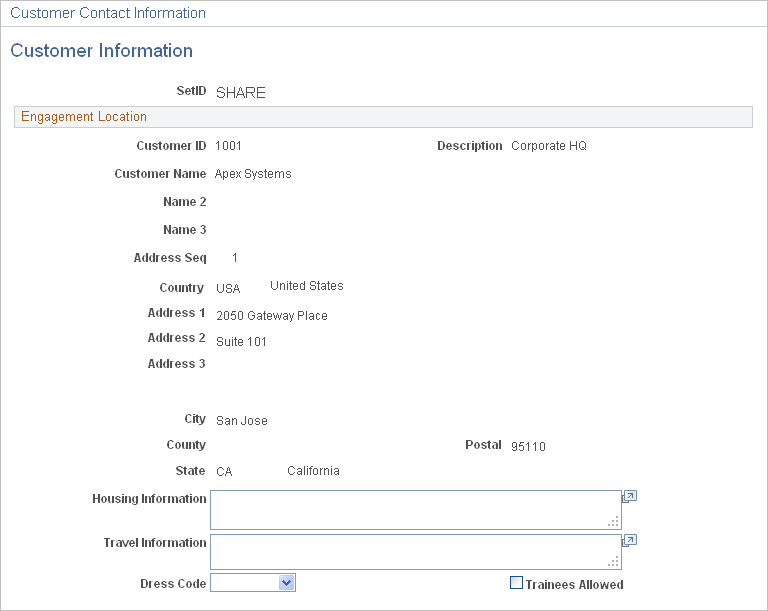

Use the Customer Information page (RS_CUST_INFO1) to view customer profiles, or add information that is specific to PeopleSoft Resource Management.
Navigation:
Click Location Details on the service order's Order Summary page.
Click Change Location/Contact Information in the Resource Requests in this Order scroll area, and click Location Details on the Service Order - Location and Contact Details page.
Click Location Details on the Order Summary page.
Click Location Details on the Assign Resource page.
This example illustrates the fields and controls on the Customer Information page. You can find definitions for the fields and controls later on this page.
Field or Control |
Description |
Housing Information |
Enter housing information that is specific to this customer location. For example, enter local hotel names or the maximum rate that the customer will pay. |
Travel Information |
Enter travel information that is specific to this customer location. For example, enter expenses that are not covered. |
Dress Code |
Enter the dress code that is observed at the project location. Values are B. Casual (business casual), Casual, and Formal. |
Trainees Allowed |
Select this option if this location permits trainees. A trainee is usually a non-billable resource who is observing, for evaluation purposes, the resource that is assigned to a project. |
