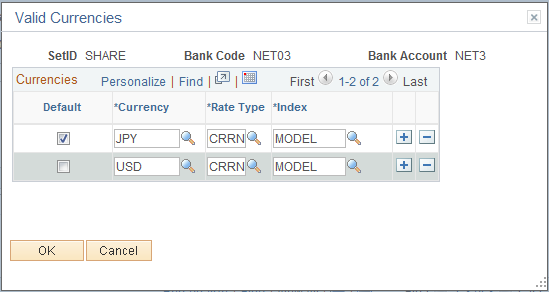

Use the Netting Accounts - Valid Currencies page (BANK_ACCT_CURR_SEC) to define all the valid currencies for a netting bank account, both default currency and secondary currencies.
For nets involving multicurrency processing, you must define these values for the automatic multicurrency netting adjustment process.
Navigation:
Click the Currencies icon in the Valid Account Currencies region on the Netting Accounts page.
This example illustrates the fields and controls on the Netting Accounts - Valid Currencies page. You can find definitions for the fields and controls later on this page.
Define the default currency for the netting bank account.
If you use this netting bank account in multicurrency nets, also define all necessary "convert into" currencies. This ensures that the automatic multicurrency netting adjustment process correctly calculates the associated accounting entries. In the example, note the bank account is a Japanese bank defined with Japanese yen (JPY) as the default valid currency and U.S. dollars (USD) as a second valid currency.
