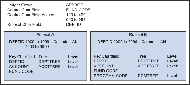

Budget definitions are defined by a single control ChartField, which is the ChartField that the Budget Processor considers when determining whether a given transaction line is subject to the rules associated with a particular budget definition. For example, if you select DeptID as the control ChartField for the budget definition, you can then identify specific departments over which the Budget Processor enforces budgetary control, and other departments that are exempt from budgetary control.
When the Budget Processor receives a transaction with a ChartField value that is a control ChartField value for a budget definition, the Budget Processor applies the processing rules for that budget definition (unless you override some of those rules at the level of the control ChartField value, individual budget, or source transaction type).
Key ChartFields and translation trees determine how the Budget Processor identifies the correct budgets for a transaction that is submitted for budget checking.
Key ChartFields
When you set up control budget definitions, you specify budget keys, which are the ChartFields that you require for budget journals and source transactions to identify budgets for budget checking. .
Budget journals and source transactions that do not have values for budget key ChartFields will fail posting and budget checking unless you select one of two other Value Required options. You can instruct the budget processor to bypass transaction lines if key ChartFields other than Account are set to Not Required. Setting the Value Required option to Optional allows you to maintain budget rows with blank values for the same budget key structure that was not possible in prior releases.
The Control ChartField and the Ruleset ChartField are always required as keys for all Rulesets. Each ruleset in a budget definition can have its own set of additional budget keys.

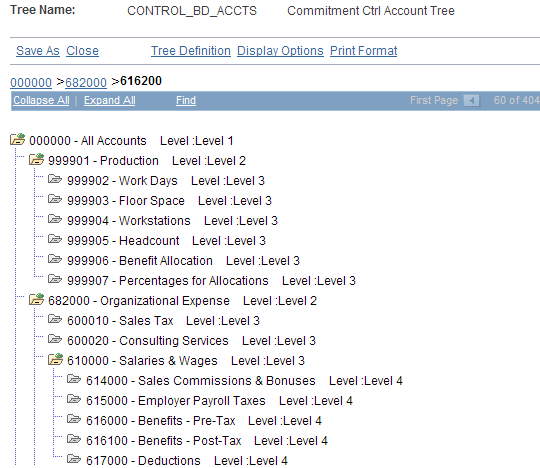

Accounts Tree Example
The following example illustrates how tree levels translate data.
Sample Translation Tree
The sample translation tree contains the following levels, beginning with the level 1 node:
Level 1: Node 000000
Level 2: 999901 and 682000
Level 3: 999902−999907, 600010−600020, 610000, and 616200−621000
Level 4: 614000−617000
When you define a control budget definition, you enter the tree level at which you want to define budgets for each key ChartField. Suppose that you want to budget at account ChartField level 3 for the sample translation tree. You enter tree level 3 for account on the Keys and Translations page. All account values found at level 3 and levels 2 and 1 above it are then valid for budget journals, and all source transaction account values below level 3 roll up for budget checking to the budgets that you define at that level. Budget Journal processing validates against the translation rules that you established in your budget definition in the tree to ensure that you selected the correct value for the budget account.
On the Control ChartField page, you can also choose whether to include all control ChartField values at your budgeting level or to exclude some. These are the results that depend on your choices:
If you select the All Values option, then all control ChartField values at or above the tree level that you entered on the Keys and Translations page are valid for budgeting and budget-checking.
Source transactions with any value for the control ChartField are budget checked.
If you deselect the All Values check box, you must enter each value that you want to be valid for budgeting on the ChartField Values grid.
Only source transactions with values that translate to the values in the list are budget checked.
For example, assume that you are budgeting at level 3. You deselect the All Values check box and enter the values 999901 and 610000 onto the ChartField Values grid. The following results occur:
If a purchase order has the level-4 account 614000, then the Budget Processor translates the account to 610000 by using the tree and level information that you entered on the Keys and Translations page.
The Budget Processor checks account 610000.
If a second purchase order has the level-3 account 616200, the Budget Processor translates the account to itself.
Because 616200 is not one of the level-3 accounts that you entered as valid for budget checking, the Budget Processor does not budget check this transaction.

By using rulesets, you can apply different calendars to different budgets within a budget definition.

Key ChartFields required for budget journals and source transactions.
Translation tree and level at which you budget for the key ChartFields.
Budget period calendar, which specifies valid budget periods.
You can, for example, budget at a higher translation level for a few of the budgets in your budget definition. You can also have some budgets in a budget definition that require an additional key ChartField, such as program ID or project ID, for tracking purposes.
For this reason, budget definitions include subsets, called rulesets. Each ruleset defines a different set of keys, translations, and budget period calendar.
Each budget definition has a Ruleset ChartField, the values of which are used by the Budget Processor to determine which Ruleset each source transaction line should reference. You define the Ruleset ChartField values that apply to each ruleset. The system automatically creates a default ruleset, which is used for any Ruleset ChartField values that you do not explicitly assign to a ruleset.
The following example illustrates the use of rulesets:
The appropriation budget definition in the preceding Using rulesets example requires two rulesets, because departments 2000 to 6999 require program codes on budget journals and source transactions for tracking purposes, whereas departments 1000 to 1999 and 7000 to 9999 do not require program codes. In all other respects, the appropriation budgets for these departments use the same processing rules (except for the attributes that you can override below the ruleset level).
If you have only one set of budget keys, translation rules, and budget calendar for a budget definition, use the default ruleset as your single ruleset, with the control ChartField as the Ruleset ChartField. You need, in that case, to enter any data onto the Ruleset page. If Budget Processor cannot find a ruleset with the values matching the transaction, the default ruleset is used, provided the transaction is subject to control in that ledger.
Note: Rulesets must be mutually exclusive and complete so that no multiple or missing setup parameters exist for a single ChartField value. When you save the Keys and Translations page, the Ruleset ChartField list is edited to ensure that no overlaps exist. When the Ruleset ChartField itself is translated, the system ensures that no node is split across two different rulesets.
