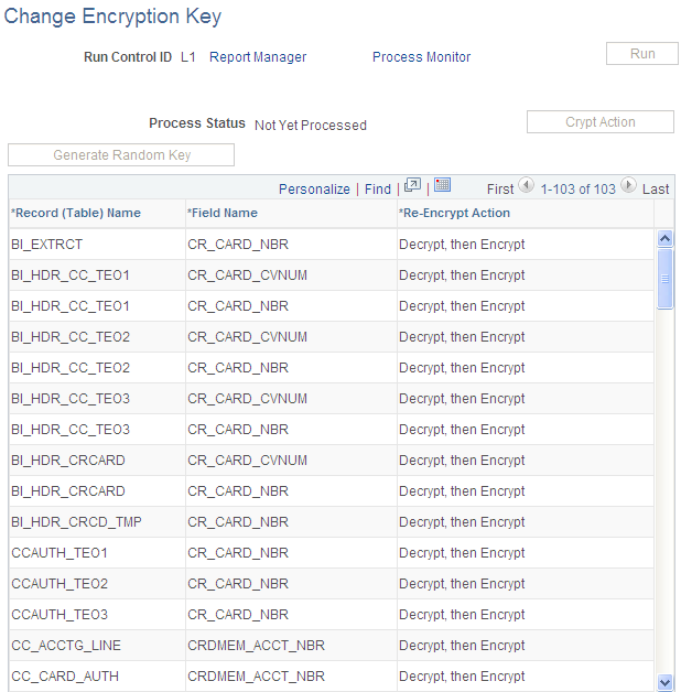

Use the Change Encryption Key page (FS_CC_CNVRT) to change the key used to encrypt credit card numbers.
Run the utility to re-encrypt credit card numbers using a new encryption key.
Navigation:
This example illustrates the fields and controls on the Change Encryption Key page. You can find definitions for the fields and controls later on this page.
Important! The Change Encryption Key page will not be enabled if the Upgrade Credit Card Numbers (FS_CC_CNVRT) process has not been run or is currently running. Once the upgrade process has completed, the Change Encryption Key page will be enabled.
Field or Control |
Description |
Crypt Action |
Click the button to toggle the values in the Re-Encrypt Action column in the grid. |
Generate Random Key |
Click to have the system generate a random key in the format needed by the encryption algorithms used for credit card encryption and decryption profiles. If you want to modify the generated key or enter your own, you must format it as a 24-byte hex string. The first two characters must be 0x and the remainder must be exactly 48 characters consisting of a combination of numeric digits and the lowercase letters a through f. |
Record (Table) Name |
Displays the record name. |
Field Name |
Displays the field name. |
Re-Encrypt Action |
Values include:
