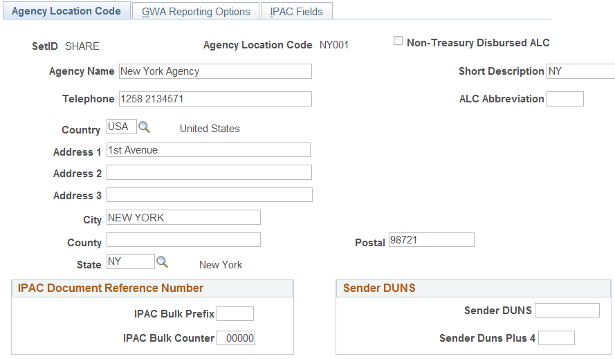

Use the Agency Location Code page (AGENCY_LOC_CD ) to define agency location codes by SetID for federal payment schedules and reporting purposes and provides for ALC name, location, address, and telephone information.
Navigation:
This example illustrates the fields and controls on the Agency Location Code page.
Field or Control |
Description |
Agency Location Code |
Enter an 8-digit numeric value for the ALC. |
Non-Treasury Disbursed ALC |
Click if the ALC does not use the US Treasury to carry out payments or if the ALC is authorized to create its own payments outside the U.S. Treasury. Note: If you set this option incorrectly for an ALC and save it, the incorrect ALC and option remains because you cannot delete the rows online. You must define a new ALC with the appropriate option. |
IPAC Document Reference Number
IPAC (Intra-governmental Payment and Collection system) is designed to transfer funds between government agencies and provide the capability to include descriptive information related to each transaction. This descriptive information assists with monthly reconciliation.
Field or Control |
Description |
IPAC Bulk Prefix |
Enter a 3-digit alphanumeric prefix to be used by PeopleSoft in creating unique document reference numbers (to differentiate from the Department of Treasury document reference numbers) for those Agency Location Codes that are used to send payments and collections. |
IPAC Bulk Counter |
Enter the beginning number from which to increment the sequential counter for the document reference number. |
See Processing Outbound IPAC Transactions.
See (USF) Submitting Transactions Between Agencies Using the IPAC System.
