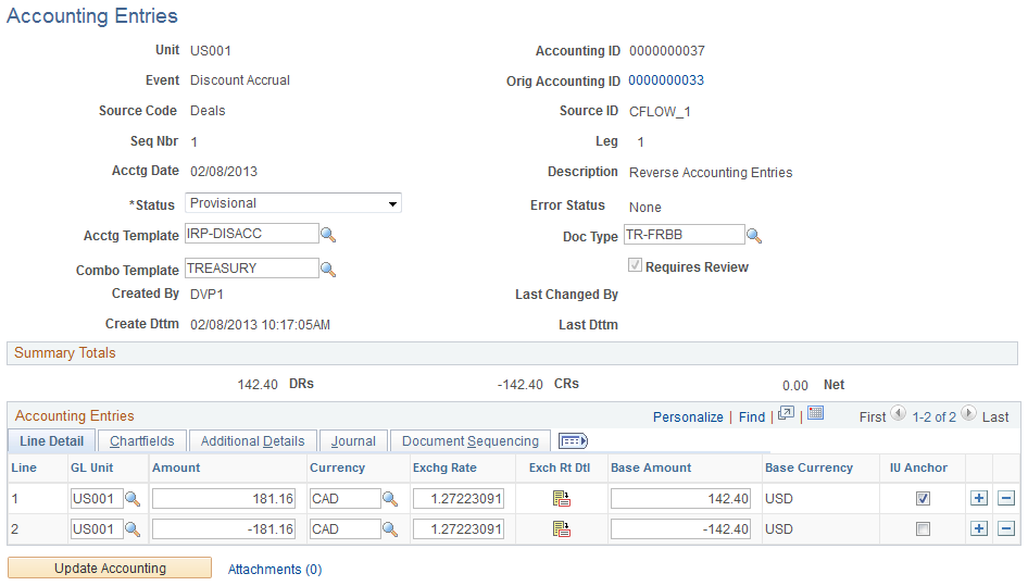

Use the Accounting Entries page (TRA_ACCTG_LINE) to review and adjust automated accounting entries.
Create manual accounting entries online.
Navigation:
This example illustrates the fields and controls on the Accounting Entries page. You can find definitions for the fields and controls later on this page.

Accounting ID  |
 Displays the ID of the accounting entry.  |
Orig Accounting ID  |
 Indicates the entry is a reversal entry. Click the link to view the original accounting entry in a separate window. The Description field also identifies whether the entry is a Reversal Accounting Entry.  |
Event  |
 Displays a descriptive label for the accounting entry, based on the source code value.  |
Source Code  |
 Displays the accounting entry source, as processed by the Automated Accounting process, or entered on a manual accounting entry.  |
Source ID  |
 Displays the unique identification number on the source side for the accounting entry.  |
Acctg Date (accounting date)  |
 Displays the date that the entry was processed through Automated Accounting, or entered as a manual accounting entry.  |
Status  |
 Indicates the current condition of the accounting entry. Values are: Provisional: The entry is not finalized. You can make any required changes. Error: An error exists within the accounting entry. The system assigns this status—you cannot select it. When you correct an error, change the status to Provisional. After the status has been changed to Provisional, use the View/Approve Entries page to change the status to Final. The entry is then ready for the Journal Generator process—you do not need to reprocess it. Final: The entry is ready for Journal Generator processing and is free from errors. Until the entry is processed through the Journal Generator process, you can continue to make changes to it, even if the status is Final. When the Journal Generator processes the entry, the distribution status changes to Distributed, indicating that it has been posted to a General Ledger journal and no further modifications can be made.  |
Acctg Template (accounting template)  |
 Displays the name of the accounting template that is attached to the accounting entry. If the accounting template is missing or inactive, Automated Accounting sets the accounting event status to Error. You can reset the Error status for accounting events that have valid templates and reprocess the accounting entries. Note: If you use General Ledger, you can automatically reverse any unrealized gain/loss accounting that is generated by Treasury Management at the next accounting period. You need to create a journal template for this type of treasury accounting and enable the feature for automatic journal reversal. You must assign this journal template to the treasury accounting template for General Ledger to perform the automatic reversals.  |
Error  |
 Indicates the error source of an automated accounting entry. Values are: None: No error condition exists. This appears when the status is provisional or final. Unbalanced: Debits do not equal credits, or debits and credits are not equal, but refer to different General Ledger business units. CF Combo Error (ChartField combination error): The ChartField generated is invalid. No Exchange Rate: The currency exchange rate for the applicable currency pair is missing. The base amount could not be converted to the accounting entry currency. Account Not Specified: The account was undefined, and the amounts cannot be distributed. IU Processor Error: The centralized processor encountered an error. Review the accounting entries, correct any errors, and click the Update Accounting button to regenerate accounting.  |
Requires Review  |
 Select this check box to require review of the accounting entries. A check box that is selected and grayed-out indicates that the Review Required check box was already selected on the Template page on which this was based or the Review Manual Updates check box was selected on the Treasury Options page for the Treasury business unit and the accounting entry has been manually updated.  |
Update Accounting  |
 Click this button if you edit any of the information in the Accounting Entries grids to run the centralized interunit processor. Note: If you are editing information only in the page header (Status field or Requires Review check box), do not click the Update Accounting button. When you click the Update Accounting button on the Accounting Entries page, the system determines whether the Review Manual Updates check box has been selected on the Treasury Options page associated with the Treasury Business Unit. If the Review Manual Updates check box is selected for the business unit, the system sets the accounting event status to Provisional and selects the Requires Review check box.  |
VAT (value-added tax)  |
 Click this link to access the Treasury VAT Information page (TRV_ACCTG_LINE_VAT). The VAT link appears for VAT-applicable accounting entries.  |
Integration Status  |
 Displays the status of the integration between Treasury and JD Edwards General Accounting. This field appears only if the integration is enabled on the Installation Options - Treasury page. Values are:
 Note: If an entry must be resent, the integration status can be changed to Pending unless the integration status is already displayed as Posted. See Installation Options - Treasury Page. See JD Edwards Application Integrations with PeopleSoft Applications, "Using the PeopleSoft Treasury with JD Edwards General Accounting Integration."  |

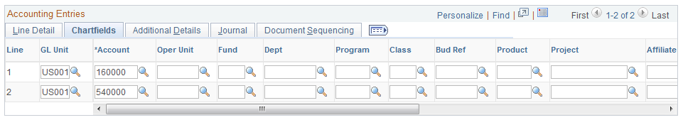

ChartFields Tab
Select the ChartFields tab.
This example illustrates the fields and controls on the Accounting Entries page - Chartfields tab. You can find definitions for the fields and controls later on this page.
Field or Control  |
Description  |
Stat (statistic)  |
 If a statistics code is set for this accounting line on the template, the code appears here. You can edit this field. Select a statistics code—the associated unit of measure (UOM) appears for the selected code. You must also enter a statistic amount with which to measure the statistic.  |
IBAN  |
 Displays the international bank account number (IBAN) in addition to the local, domestic bank account number when the country has been set up to display the IBAN on the IBAN Formats Page.  |
Important! If a ChartField combination editing error occurs, an Errors column will appear after the Line # column. An X link will appear next to an transaction line with a ChartField combination error. You click the X link to access an Accounting Entries secondary page, which contains a grid that describes the error message for each transaction. You can click on a transactions Line # link and access the accounting transaction with the ChartField combination error, and fix the problem. See the Accounting Entries subtopic in this section for additional details.
See ChartField Values.

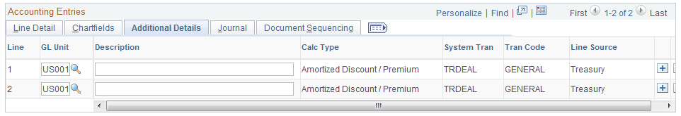

Additional Details Tab
Select the Additional Details tab.
This example illustrates the fields and controls on the Accounting Entries page - Additional Details tab. You can find definitions for the fields and controls later on this page.
Field or Control  |
Description  |
Line Source  |
 Displays either Treasury for accounting lines that are generated by the treasury accounting program, or System IU for accounting lines that are generated by the centralized processor.  |

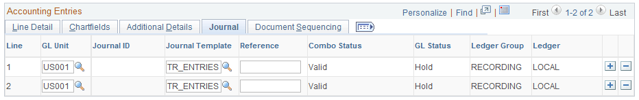

Journal Tab
Select the Journal tab.
This example illustrates the fields and controls on the Accounting Entries page - Journal tab. You can find definitions for the fields and controls later on this page.
Field or Control  |
Description  |
Combo Status  |
 Indicates whether the ChartField combination that the system built based on the accounting template is Valid or Invalid.  |
GL Status (General Ledger status)  |
 Provides information about the posting status of the entry. Possible values include:
Ledger Group  |
 Indicates the general ledger group that is associated with the General Ledger Unit on the accounting line.  |
Ledger  |
 Indicates the general ledger that is associated with the General Ledger Unit on the account line.  |
On the Accounting Entries page, the Source Code, Source ID, Event, and Accounting Template fields are optional.

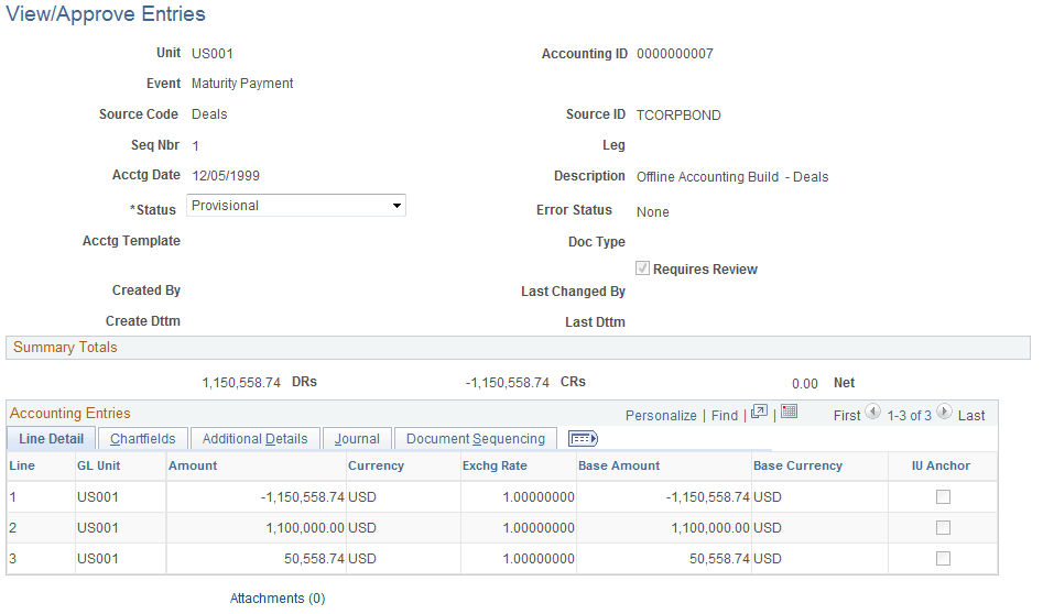

Use the View/Approve Entries page (TRA_ACCTG_LINE) to approve accounting entries that are awaiting review.
Navigation:
This example illustrates the fields and controls on the View/Approve Entries page. You can find definitions for the fields and controls later on this page.
Field or Control  |
Description  |
Status  |
 Initially displays the status of accounting entries that are displayed in the Accounting Entries grid. Values are:
Note: Use PeopleSoft Security functionality to identify which users have access and approval privileges to provisional accounting entries. You can define permission lists and accessible pages for a specific userID. See the product documentation for PeopleTools: Security Administration.

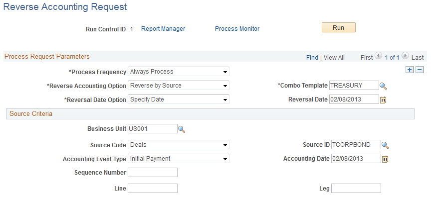

Accounting entries that need to be reversed can be identified using various identifiers, such as Accounting ID, Source, and Payment ID. The Reverse Accounting Entries Application Engine process (TR_RVSL_DRVR) does the following:
Selects the accounting data (header, lines, and VAT).
The reversal accounting entry is not linked to a fiscal period.
Reverses the amounts and reset certain statuses and fields (for example, Journal Generator links).
Assigns a new accounting ID to each selected header, lines, and VAT.
The process does not reset the accounting event status associated to the original accounting entry.
Calls document sequencing and ChartField combination editing, when applicable.
Populates the accounting tables with the new data (header, lines, and VAT).
Checks for errors (for example, combination edit, unbalanced entries) and updates the accounting header.
Logs messages summarizing the entries (including type of errors, number of entries created).
When deactivating a deal, you can automatically reverse the accounting entries on the Undo Deal Utility page. When you select the Reverse Accounting check box, you can use additional options to specify the Reversal Date Option and Combo Edit Template. The TRX_UNDO_DEAL Application Engine process uses the entered parameters and calls the Reverse Accounting process. When you create cumulative MTM accounting entries for deals, the Treasury Accounting Application Engine program (TR_ACCTG) processes cumulative fair value adjustments then initiates reverse accounting to reverse previous fair value adjustment accounting entries. For more information, see the documentation for the Deal Analytics page.
When an already accounted external transaction is unreconciled using semi-manual reconciliation, the system triggers the TR_RVSL_DRVR process to reverse the accounting entries. The external transaction status is set as Void to ensure that there is only one valid BSP transaction corresponding to the source Bank Statement transaction.

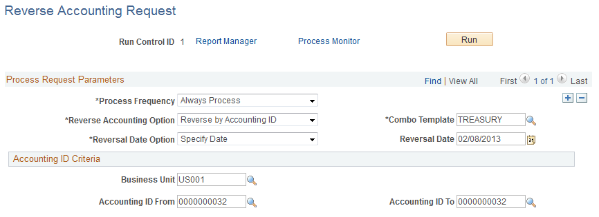

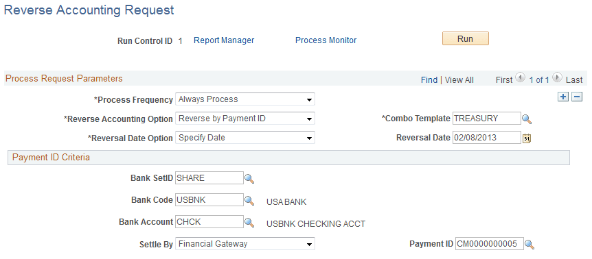

Use the Reverse Accounting Request page (REV_ACCTG_REQ) to run a process to create reversal accounting entries.
Note: Accounting entries can be reversed only one time.
Navigation:
This example illustrates the fields and controls on the Reverse Accounting Request page.
Field or Control  |
Description  |
Reverse Accounting Option  |
 Select from these values:
 The page will render differently depending on the selected Reverse Accounting Option. Each option has different criteria for identifying the accounting entries to be reversed.  |
Combo Template  |
 Specify a combination editing template.  |
Reversal Date Option  |
 Select the date to use as the accounting date for the reversal accounting entries. The Reversal Date field is available for input when the reversal date option is Specify Date. Select a reversal date from these values:
Accounting ID Criteria
This section appears when you select Reverse by Accounting ID in the Reverse Accounting Options field.
This example illustrates the fields and controls on the Reverse Accounting Request page to reverse by Accounting ID.
Field or Control  |
Description  |
Business Unit  |
 Enter a business unit. This is a required field.  |
Accounting ID From and Accounting ID To  |
 Identify one or more accounting IDs to be reversed. Accounting entries for the accounting ID range will be reversed. Accounting ID From is a required field.  |

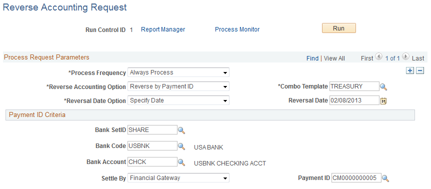

Payment ID Criteria
This section appears when you select Reverse by Payment ID in the Reverse Accounting Options field.
This example illustrates the fields and controls on the Reverse Accounting Request page to reverse by Payment ID.
The following fields are required:
Field or Control  |
Description  |
Bank SetID  |
 Enter the bank SetID.  |
Bank Code  |
 Enter the bank code.  |
Bank Account  |
 Enter the bank account.  |
Settle By  |
Payment ID  |
 Enter the ID for the payment to be reversed.  |
Source Criteria
This section appears when you select Reverse by Source in the Reverse Accounting Options field.
Accounting entries created for a source for a specific accounting date can be reversed.
This example illustrates the fields and controls on the Reverse Accounting Request page to reverse by source values. You can find definitions for the fields and controls later on this page.
Business Unit, Source Code, and Source ID are required fields for all sources.
Field or Control  |
Description  |
Business Unit  |
 Enter a business unit.  |
Source Code  |
 Select from the values that appear in the following table.  |
 Source Code Values  |
 Criteria Used Identify Accounting Entries  |
 Bank Transfers EFT Requests Hedges Interest  |
 Source ID Accounting Event Type Accounting Date  |
 Deal Fees EFT Fees Facility Fees Investment Pools LC Fees  |
 Source ID Accounting Event Type Accounting Date Sequence Number  |
 Deals  |
 Source ID Accounting Event Type Accounting Date Sequence Number Line Leg  |
Field or Control  |
Description  |
Source ID  |
 Enter the source ID.  |
Accounting Event Type  |
 Select an accounting event type from the list. The values available in the Accounting Event Type list depend on the Source Code selected.  |
Accounting Date  |
 Enter the accounting date.  |
Sequence Number  |
 Enter a sequence number. The Sequence Number value is for multiple like events on the same date (that is, same Business Unit, Source Code, Source ID, Accounting Event Type, and Accounting Date). For example, two Deal Interim Principal Payments or two Deal Fees.  |
Line  |
 Enter a deal line to be reversed, if desired.  |
Leg  |
 Enter a deal leg, if desired.  |
