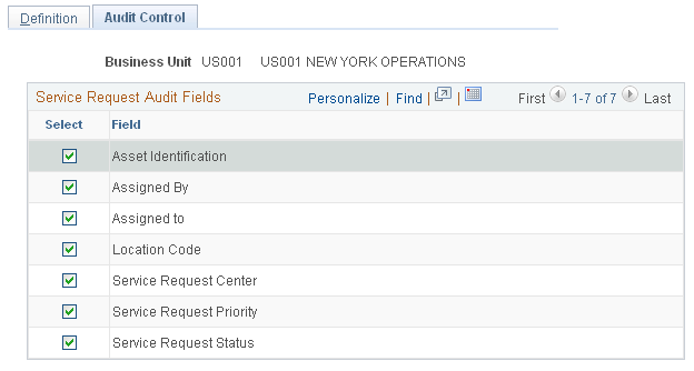

Use the Audit Control page (WM_AUDIT_CNTRL) to specify fields in a service request to audit.
Navigation:
Select the Audit Control tab.
This example illustrates the fields and controls on the Audit Control page. You can find definitions for the fields and controls later on this page.

Service Request Audit Fields |
Select the service request fields in which you want to audit changes. The fields include:
