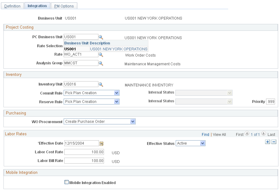

BUS_UNIT_TBL_WM2 |
Identify Project Costing, Inventory, and PeopleSoft Purchasing integration parameters. |

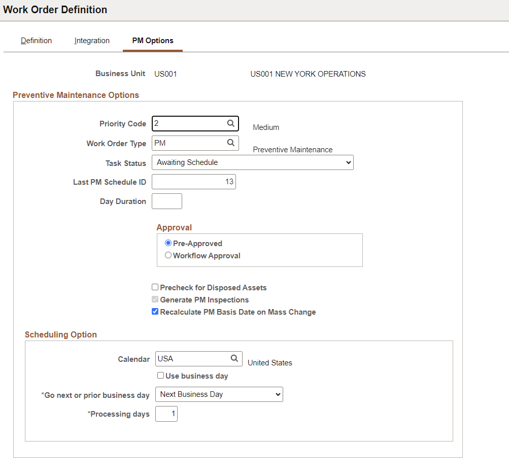

BUS_UNIT_TBL_WM3 |
Identify parameters specific to Preventative Maintenance Work Orders. |

The Integration page in which you identify specific options that enable a business unit to integrate with Project Costing, PeopleSoft Inventory, PeopleSoft Purchasing, and PeopleSoft eProcurement, define default labor rates for resources, and enable mobile integration.
The Project Costing Business Unit is a required field.
Note: The Inventory business unit and commit rule are only required if you plan to integrate and use PeopleSoft Inventory with PeopleSoft Maintenance Management.
The PM Options page defines specific options that enable you to use this business unit to enter and process preventive maintenance work orders.
The required fields on this page are Priority Code, Work Order Type, and Task Status.

Use the Integration page (BUS_UNIT_TBL_WM2) to identify Project Costing, Inventory, and PeopleSoft Purchasing integration parameters.
Navigation:
Select the Integration tab.
This example illustrates the fields and controls on the Work Order - Integration page. You can find definitions for the fields and controls later on this page.
Project Costing
This section links any work order associated with this business unit to PeopleSoft Project Costing so that PeopleSoft Project Costing can serve as the cost repository for all work order costs, which includes the calculation and capitalization costs of assets. PeopleSoft Project Costing also calculates chargebacks and sends them to the appropriate GL business unit.
Field or Control |
Description |
PC Business Unit (Project Costing business unit) |
Enter or select the Project Costing business unit that you want to use to track costs incurred for work orders associated with this work order business unit. This is a required field. Note: You can use this Project Costing business unit to set up the Resource Management business unit that is required for setting up resources in PeopleSoft Maintenance Management. |
Rate Selection |
Select one of the following values:
Rate |
Select a rate plan or a rate set from PeopleSoft Project Costing to use as the default value in the work order task for calculating chargebacks. If you select Rate Set, select from a list of values, which are user-defined in PeopleSoft Project Costing. For example:
If you select Rate Plan, select from a list of values, which are user-defined in PeopleSoft Project Costing. For example:
Analysis Group |
Defines the PeopleSoft Project Costing analysis group that is used by the Cost Collection process in PeopleSoft Maintenance Management to gather costs from PeopleSoft Project Costing into PeopleSoft Maintenance Management. Note: Analysis Groups are set up in PeopleSoft Project Costing. |
See Analysis Groups.
Inventory
These fields only display if Inventory is installed.
Field or Control |
Description |
Inventory Unit |
Enter or select an Inventory business unit if you plan to issue parts from PeopleSoft Inventory to work orders. This business unit appears in the Inventory Requirements - Default Settings and in the Inventory Schedules - Default Settings fields of the work order. This is the only Inventory business unit that can issue parts directly to the work order. The SetID for the work order business unit must match the SetID for the Inventory business unit. The system runs an edit to ensure that these SetIDs match. In addition, you can only use an Inventory business unit in which the GL business unit is the same as the GL business unit in the work order. Note: You should enter this field if you plan to use PeopleSoft Inventory with PeopleSoft Maintenance Management. |
Inventory Commit Rule |
Select the rule that describes when to place demand on inventory for inventoried items. This selection serves as an indicator to the scheduler and to PeopleSoft Inventory that items specified in a work order associated with this business unit will place demand on inventory based on your selection of one of these rules. Select one of the following:
Note: This is a required field if you enter an Inventory business unit in the Inventory Unit field. |
Internal Status |
If you selected Work Order Status Change, select one of the internal work order statuses that triggers the commitment of items in PeopleSoft Inventory, which include:
Work Order Reservation Rule |
Select one of these reservation rules to reserve inventory parts (items). Inventory parts (items) must be committed before they can be reserved. Important! The system edits the commit and reservation rule combination to ensure that the items are committed at the same time or before they are reserved. The system also filters the values that apply to the work order based on the setup of these values in the work order business unit, shop, or shop/type.
Internal Status |
If you selected Work Order Status Change, select one of the internal work order statuses that triggers reservation of items in PeopleSoft Inventory for the work order, which include:
Priority |
Enter a number from 1- 999 for PeopleSoft Inventory to use to sort and prioritize demand. The number you enter here serves as a default value in the Inventory Schedules grid. |
Purchasing
PeopleSoft Maintenance Management requires the installation of PeopleSoft Purchasing to enable users to obtain materials, tools, labor, and other goods and services by creating either a requisition or a purchase order directly from the work order or work order workbench. You can also create a requisition or purchase order in PeopleSoft Purchasing and link it to a work order. If you prefer to use PeopleSoft eProcurement, you can create a requisition directly in PeopleSoft eProcurement from the work order or you can load and stage scheduled rows and create requisitions, which can be accessed in PeopleSoft eProcurement.
Field or Control |
Description |
Work Order Procurement Option |
Select one of these values:
Labor Rates
Field or Control |
Description |
Effective Date and Status |
Enter or select the date from which you consider these labor rate values either Active or Inactive. |
Labor Bill Rate |
Enter the hourly bill rate for labor to use to calculate the billable labor amount based on the labor hours entered at the work order task level. |
Labor Cost Rate |
Enter the hourly cost rate for labor to use to calculate the actual labor costs for any labor performed and tracked via a work order. |
Note: You can override these rates for a specific shop at the shop level, as well as associate specific crafts and craft labor rates with a shop.
GIS Integration
Field or Control |
Description |
GIS Integration Enabled(Geographic Information System integration) |
Select this check box to enable integration with ESRI GIS for a selected business unit. You can view the location of a work order task on an ESRI map by clicking a Map It button on the Work Order, Requirements and Schedules pages of the work order, the Work Order Workbench, and the Technician Workbench. |
Mobile Integration
Field or Control |
Description |
Mobile Integration Enabled |
Select this check box to display Mobile Tasks Updated Pending links appears on the above Work Order, Express Work Order or Work Order Completion components, and to display the Mobile Public check box on the Task Search page associated with the Technician Workbench. |
Use the PM Options page (BUS_UNIT_TBL_WM3) to identify parameters specific to Preventative Maintenance Work Orders.
Navigation:
Select the PM Options tab.
This example illustrates the fields and controls on the Work Order - PM Options page. You can find definitions for the fields and controls later on this page.
Field or Control |
Description |
Priority Code |
Select H (High), M (Medium), or L (Low) to appear as the default priority in any preventive maintenance work order that the application automatically creates for this business unit. This is a required field. Important! This default value appears for all work orders except for work orders that you create for a project for a Project Costing-managed project. See Setup and Processing of Preventive Maintenance Work Orders. |
Work Order Type |
Select the work order type that you want to use as the default value in any preventive maintenance work orders that the application generates for this business unit. This is a required field. |
Task Status |
Select the work order task status for a work order task that you want to appear as the default value for any preventive maintenance work orders created during Preventive Maintenance processing that are associated with this business unit. You can select any user-defined work order task status except for those that you defined for the internal statuses of complete, closed, and canceled. This is a required field. |
Last PM Schedule ID |
This identifies the last number used to create a preventive maintenance schedule and automatically increments each time a new preventive maintenance schedule is created. See Setup and Processing of Preventive Maintenance Work Orders. |
Day Duration |
Enter a duration value in hours. This value should not be greater than twenty four. For example, if the day duration is eight hours, the PM work order duration is forty eight hours, and if the start date is 04/05/2012, the period is calculated as forty eight divided by eight, which is six. Hence, end date would be 04/11/2012. |
Enable Workflow Approval |
Click the Workflow Approval radio button to enable the workflow approval process. |
Precheck for Disposed Assets |
Select to deactivate any active PM Schedules and Maintenance Loop structures corresponding to assets in ‘Disposed’ status. |
Recalculate PM Basis Date on Mass Change |
Select to enable the Recalculate Basis Date check-box by default on the PM Schedule Mass Update page. |
Scheduling Option
Field or Control |
Description |
Calendar |
Select a business calendar to use in determining valid business days for preventive maintenance work orders that are generated for this business unit. Selecting this option enables you to avoid scheduling preventive maintenance work orders on holidays or weekends. |
Use business day |
Select the check box to consider only business days for scheduling and skip weekends and holidays. Note: In the Business Calendar page you can configure the days in a week that you want to be considered as normal business days. |
Go next or prior business day |
Select day for the next update. There are two options:
If the calculated date falls on weekend or holiday then based on the option selected the next or prior business date will be considered for scheduling. |
Processing days |
Enter number of days to increase or decrease from the calculated due date. |
