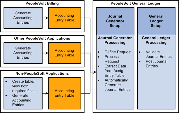

The following process flow illustrates how the Load GL Accounting Entry process fits into the overall journal entries generating process.
You must populate the PeopleSoft Billing Accounting Entry table (BI_ACCT_ENTRY) with accounting entries before you can create PeopleSoft General Ledger accounting entries.
The Load GL Accounting Entries process (BILDGL01) populates the Billing Accounting Entry table with accounting entries that the Journal Generator eventually picks up. The process selects for processing all bills in the specified range selection that have a status of INV and that have finished the Billing Currency Conversion process and the Pre-Load process.

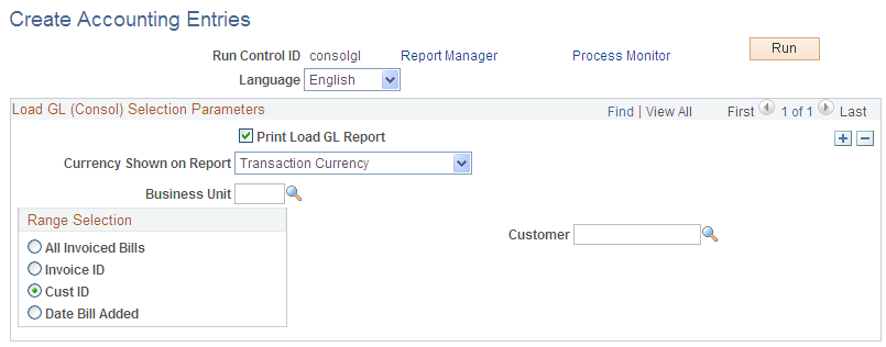

To run the Load GL Accounting Entries process for regular invoices, access the Load GL Accounting Entries page (Billing, Generate Invoices, Non-Consolidated, Create Accounting Entries, Load GL Acctng Entries, Load GL Accounting Entries); for consolidated invoices, access the Load GL for Consolidated Bills page (Billing, Generate Invoices, Consolidated, Create Accounting Entries, Consolidated Load GL, Load GL for Consolidated Bills).
After you define the run controls and access the Process Scheduler page, select the Curr Con Preload & Load GL job, which runs several processes at once. If you run the processes individually, you must run them one at a time and run Currency Conversion first, followed by the Pre-Load process.
Use the GL Accounting Entries Report page (RUN_BI_GL) to regenerate GL Accounting Entries reports listing all accounting entries that are processed in a specified accounting date range.
Navigation:
| Field or Control | Description |
| Business Unit | If you do not specify a billing business unit, the system processes all invoices within the specified accounting date range for all billing business units. When you run this process for consolidated invoices, this field refers to the consolidated header's business unit. |
| Start and End Accounting Date | The accounting date for an invoice is specified in the Acctg Date field on the Standard Billing - Header - Info 1 page. The value in the end date must be greater than the value in the start date, or the system generates an error message upon saving. Click the Reset to Current Date button to populate the Start Date and End Date fields with the current date. |
| Currency Shown on Report | Determine whether to print the currency that is shown on the report in transaction or base currency. |

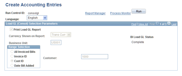

Displaying Load GL Requests that Process Successfully
The system updates the status on the Load GL Process table to indicate that processing is complete before it carries out the last SQL Commit command for the corresponding request. After all requests for a run control are processed, the system deletes all records in the Load GL Process table for the corresponding run control. When multiple requests are all processed successfully, the Load GL Accounting Entries and Load GL for Consolidated Bills pages are displayed.
This example illustrates the fields and controls on the The Load GL for Consolidated Bills page when multiple requests are processed successfully.
In this scenario, the system does not display the BI Load GL Status and Restart Process Instance fields. If the system processes successfully all requests within a run control, the parameters for the request are available to edit.

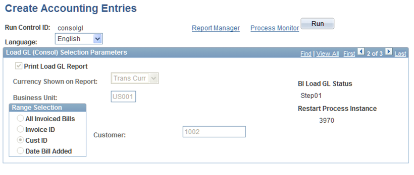

Displaying Load GL Requests That Terminate
The run control may contain a Load GL request that does not process successfully. On the Load GL Accounting Entries or the Load GL for Consolidated Bills page, the BI Load GL status indicates that the process is Complete for those requests that process successfully. The parameters for requests that process successfully are not available for edit when succeeding requests within the run control terminate.
This example illustrates the fields and controls on the Displaying the updated BI Load GL status as Complete, and the parameters that are not available for edit.
If a request terminates after a SQL Commit command, the Load GL process saves the process instance and process status number on the Load GL Process table. The Load GL Accounting Entries or the Load GL for Consolidated Bills page displays the BI Load GL status of the aborted request and the Restart Process Instance number. All other request parameters are unavailable for entry.
This example illustrates the fields and controls on the Displaying the BI Load GL status of the aborted request and the Restart Process Instance number.
All requests not processed, those that follow a terminated request, can be modified. You cannot delete a Load GL process request that must be restarted.
Restarting a Terminated Request
Although the system does not perform validation edits to ensure that you do not include in a second Load GL process request those invoices from a terminated request, you must use the original run control to restart the process. The system marks invoices that are included in an aborted process with the process instance of the aborted request. Although the system allows you to create a new run control to create general ledger entries for the same invoices, initiating this new run control does not produce any general ledger entries.
The system uses the process status number in the Load GL Process table to determine where to restart the request. It restarts a terminated process from the appropriate process status S01 through S99. If the system restarts a request from status S99, you get duplicate copies of the report if the process terminates after the report is printed.
You can check the Message Log to verify the stage from which a request is restarted.
Note: You cannot add a new Load GL process request to a run control ID that requires a restart. The Load GL process does not include any new invoices that become eligible between the request abort and the request restart, even if these invoices meet the existing run control selection criteria.
