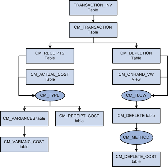

This diagram illustrates the cost flow for a lot controlled item.

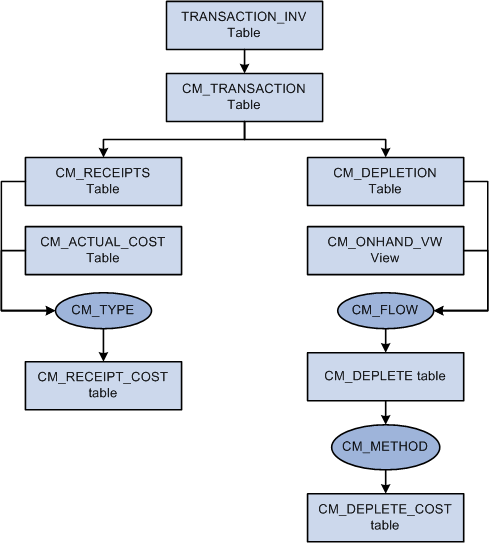

This diagram illustrates the cost flow for a FIFO or LIFO item.

This diagram illustrates the cost flow for a perpetual and periodic average cost item.

This diagram details the standard cost method used in PeopleSoft Cost Management. For this example, this information is used:

This diagram illustrates the cost flow for a standard cost item.
