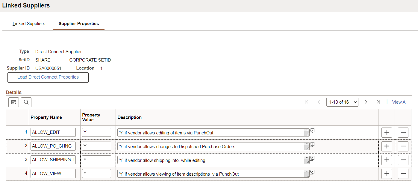

Now, navigate to Supplier Properties tab and click Load Direct Connect Properties button. It loads all the OBN punchout properties on the Details table. Enter the values for the following properties.
Property Name
Property value
ALLOW_EDIT
Y
ALLOW_PO_CHNG
Y
ALLOW_SHIPPING_EDIT
Y
ALLOW_VIEW
Y
CATEGORY_ID
Default category for this vendor.
LOAD_PORTAL
N
OBNPassword
Enter the Password corresponding to the Buyer account in OBN.
OBNUserName
Enter User Name corresponding to the Buyer account in OBN.
CATEGORY_SETID
Default SETID for this vendor.
Note: CATEGORY_ID and CATEGORY_SETID are mandatory fields.

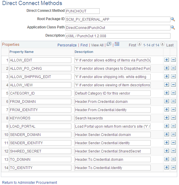

To set up direct connect, use the Direct Connect Methods (PV_DC_TYPE) component.
Use the Direct Connect Methods page (PV_DC_TYPE) to define Direct Connect integration methods and standards.
Navigation:
eProcurement, Administer Procurement, Maintain Supplier Integration, Direct Connect Methods
This example illustrates the fields and controls on the Direct Connect Methods page. You can find definitions for the fields and controls later on this page.
Field or Control |
Description |
Direct Connect Method |
Identifies the type of connection to the supplier's website. Delivered options include:
Root Package ID |
Identifies the PeopleSoft application package used for this direct connect method. |
Application Class Path |
Identifies the PeopleSoft application class within the above application package. |
Properties |
Lists property values that the system uses for this direct connect method. |

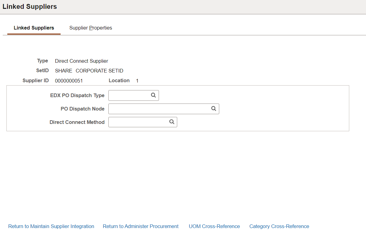

Use the Linked Suppliers page (PV_MS_SEC_SUPPLIER) to associate supplier ID, supplier location, and the direct connect node together.
Navigation:
This example illustrates the fields and controls on the Linked Suppliers page. You can find definitions for the fields and controls later on this page.
Use this page to associate suppliers to nodes and then associate suppliers and nodes to their direct connect method. Then use the Supplier Properties tab to store authentication and behavioral properties specific to the method for this supplier and node.
Enter these field values that are specific to Direct Connect Suppliers that use PUNCHOUT:

Enter the supplier ID established for your direct connect supplier. The SetID field and the Location field are also part of the supplier definition. |
The options are:
Field or Control |
Description |
Direct Connect Node |
Enter the node established for this supplier. Note: This field appears if the Direct Connect Method is EXCH_ORACLE, PUNCHOUT, ROUNDTRIP, or ROUNDTRIP_MP. |
OBN Buyer Node and Sync Supplier |
Enter the node established for OBN supplier. Once the OBN Buyer Node is entered, click Sync Supplier to load the list of suppliers. Properties configuration is required to load the suppliers. Navigate to Supplier Properties tab to enter the required information. Note: This field appears if the Direct Connect Method is PUNCHOUTVIAOBN. OBNUserName and OBNPassword are required to load supplier information. |
Use the Supplier Properties page (PV_MS_SEC_SUP_NV) to set up supplier properties, which determines how the supplier interacts with the direct connect method.
Navigation:
Select the Supplier Properties tab from the Linked Suppliers page.
This example illustrates the fields and controls on the Supplier Properties page.
Use this page to set up or change properties for a direct connect supplier connection. Before defining properties, you should have already discussed descriptions for the fields with the supplier. For example, the authentication paths should be familiar to you because the supplier should have communicated the values they require for these paths in the XML.

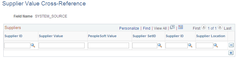

To set up direct connect, use the Supplier Value Cross-Reference (PV_MERCHANT_XREF) component.
Use the Supplier Value Cross-Reference page (PV_MERCHANT_XREF) to map field values between supplier fields and your fields by creating a cross-reference between the item categories and the values that are returned by Punchout direct connect suppliers.
Navigation:
This example illustrates the fields and controls on the Supplier Value Cross-Reference page. You can find definitions for the fields and controls later on this page.
When using direct connect, there are times that the data sent by the supplier needs to be translated to the desired data value for the PeopleSoft database. Use this page to map PeopleSoft eProcurement values to values with the same meaning but with different field names that the supplier uses. The most common use of this mapping is when a unit of measure, such as dozen is described by PeopleSoft as DZ and the supplier as DOZ.
There are several fields that might need to have some translation, or mapping, done. These fields may include:
Unit of Measure
Currency code
Country Code
Category ID
Supplier ID
Translation always occurs after the item data is received from the supplier and transformed into the PV_DC_ITEMS (Direct Connect Items) message format. On each line of this message, every field in the PV_DC_REQ_LINE (Direct Connect Requisition Line) record is examined to determine if translation is required. The system then queries the data within the Supplier Values Cross-Reference page to determine if the field name and value passed need translation. If the system finds translation is needed, the field is updated with the corresponding PeopleSoft Value.
If no data is sent by the supplier for a particular field, you can assign default values. These values are configured on the Supplier Properties page.
The system uses values that you define on this page both for sending and receiving direct connect supplier data. You can add or change the cross references. Before you access this page, you first select the field to which the mapping applies.
Field or Control |
Description |
Supplier ID |
Select the supplier node for which this mapping is to apply. |
Supplier Value |
Enter the value that the supplier uses to describe this field. |
PeopleSoft Value |
Enter the value that PeopleSoft uses instead of the direct connect supplier value. |
Supplier SetID, Supplier ID and Supplier Location |
Select the values for the supplier that you want the system to use when a supplier sends data to PeopleSoft eProcurement. |
