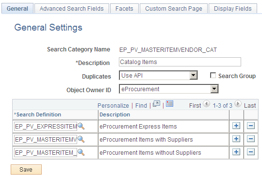

Search Category
The Search Category is the highest level object in the Search framework. It is comprised of one or more Search Definitions. All the searches in the application are performed against Search Categories. In the search criteria if one particular search category is not specified then Search Framework searches across all categories defined in the Search Framework instance. For global search it is necessary to set up search categories as Search Groups.
The search category used in eProcurement for all searches is EP_PV_MASTERITEMVENDOR_CAT.
This example illustrates the fields and controls on the Search Category page.
The eProcurement search category is exposed to global searches. All available items in the Search Framework repository is displayed in the search result for global search. However, related action and item detail are only available to the items that the requester has access to based on the catalog security setup.
Note: A new search category called EP_CATALOG_ITEMS was created for global searches. This search category has the same search definitions as EP_PV_MASTERITEMVENDOR_CAT.
