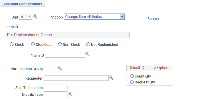

Use the Maintain Par Locations page (CART_MASS_MAINT) to modify header or item information for multiple par locations.

This example illustrates the fields and controls on the Maintain Par Locations page. You can find definitions for the fields and controls later on this page.
To perform par location mass maintenance:
Enter a business unit and select an update action: Add Item, Change Header Attributes, Change Item Attributes, Delete Item, or Replace Item.
Click the Search link to transfer to the selection criteria page, then enter criteria for the par locations to be updated.

Enter the header or item information to be updated, using the group box in the center of the page.
The values that you enter in this group box override existing values on the par location records; any fields that you leave blank retain the previously defined values.
Note: The fields in this group box vary depending upon the action that is being performed.
The entries here do not update any outstanding requisitions, purchase orders, or material stock requests.
For the Change Header Attributes and Change Item Attributes actions, you can clear entries when you click the Reset button.
Select par locations to be updated.
The grid at the bottom of the page displays the par locations that match the selection criteria. Select the check box next to each par location that you want to update. To update all of the par locations that appear, click Select All; to clear all selections, click Deselect All.
