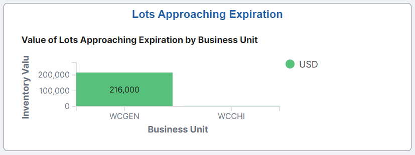

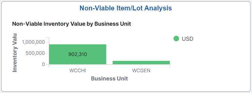

PeopleSoft Inventory has these tiles associated with Insights dashboards:
Lots Approaching Expiration Date, see Item Lots Approaching Expiration Date Dashboard
Non-Viable Item Lot Analysis, see Non-Viable Item Lot Analysis Dashboard

This example illustrates the Lots Approaching Expiration tile.
This example illustrates the Non-Viable Item/Lot Analysis tile.
