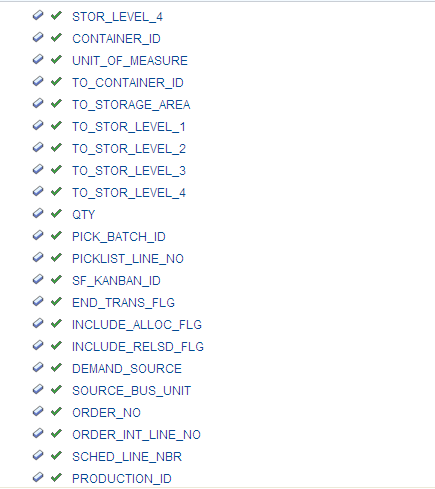

Use the Message Definition page (IB_MESSAGE_BUILDER) to view the fields to be used by the service operation within PeopleSoft Integration Broker. This is a setup step that is not repeated for each transaction request.
Navigation:
This example illustrates the fields and controls on the View the fields included in the message used by the INVENTORY_TRANSFER service operation (1 or 2). You can find definitions for the fields and controls later on this page.
This example illustrates the fields and controls on the View the fields included in the message used by the INVENTORY_TRANSFER service operation (2 or 2). You can find definitions for the fields and controls later on this page.
In order to correctly populate your incoming data, review the message definition. Message definitions provide the physical description of the data that is being sent, including; fields, field types, and field lengths. Messages do not contain any processing logic. All processing logic is defined in service operations, using service operation handlers. In this section, consider some important fields in the INVENTORY_TRANSFER message.
Field or Control |
Description |
TRANSACTION_CODE |
Transaction codes determines the type of action to be performed, including: 0601 - Item Transfer: Transfers loose items from one material storage location to another. This transaction is useful for inventory consolidation in a warehouse where some items are not tracked in containers. For example, you can move the last five cases of inventory so that a received pallet can be put away into the original material storage location. Using this transaction code, you can choose to transfer available stock, allocated stock, or a combination of both. For allocated stock, you can choose the stock to be transferred using the Original Location group box, or select a specific allocation using the Inventory Allocations group box or the Production Allocations group box. When transferring allocated stock, keep in mind, that a partial transfer could occur leaving allocated stock in two separate material storage locations. For example, 20 units of item A could be allocated to order ID 999. A transfer transaction could move 15 allocated units to another location but leave 5 allocated unit in the original location. 0602 - Container Transfer: Transfers a full storage container from one material storage location to another. By moving a container (a full pallet, for example) to another location, you can consolidate inventory in your warehouse. Using this transaction code, you can choose to transfer a storage container that contains stock that has been allocated to a demand line. You can transfer a container with available stock, allocated stock, or a combination of both. When transferring a container with allocated stock, be sure to select the Include Allocated Qty check box for pre-allocated and lot-allocated stock and the Include Release Qty check box for released stock. Using this transaction code, you can choose to transfer a container with available stock, allocated stock, or a combination of both. 0603 - Associate Item to a Cntr (associate an item to a container): Transfers loose items into a storage container. You can build a new container, or you can add items to an existing container. If the container is empty before the new items are added, you can enter the putaway location on the same transaction. If the container already has items in it, use the Container Transfer transaction to move the container to the destination location. You cannot transfer allocated stock into a container. 0604 - DeAssociate Item From a Cntr (deassociate an item from a container): Transfers items from a storage container to a material storage location. You can also use this transaction to move inventory from a storage container in a secondary material storage location to a fixed picking bin location that does not have a storage container. This transaction reverses the associate item to a Container transaction. You cannot transfer allocated stock out of a container. 0605 - Item/Cntr to Item/Cntr (item/container to item/container): Transfers items from one storage container to another. If the destination container is empty, you can add items to the container and move the container to another material storage location simultaneously. For a storage container that already has items in it, use the Container Transfer transaction. You cannot transfer allocated stock using this transaction code. 0606 - Cntr/Cntr Full Transfer (container to container full transfer): Transfers all contents of one storage container into another storage container. You cannot transfer allocated stock using this transaction code. 0607 - Debuild Full Container: Transfers all items from a storage container to a material storage location. You cannot transfer allocated stock using this transaction code. |

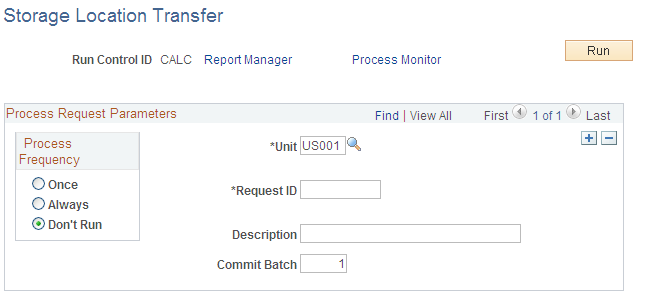

Use the Storage Location Transfer page (BCT_INV_REQTRFR) to establish run control parameters for the Inventory Transfers process and load material storage location transfer data staged by third-party applications using the Inventory Transfer EIP.
Navigation:
This example illustrates the fields and controls on the Storage Location Transfer process page. You can find definitions for the fields and controls later on this page.
These third-party applications include electronic data collection systems and warehouse management systems.
Field or Control |
Description |
Unit |
Enter the Inventory business unit to receive the transfer transactions. |
Commit Batch |
Enter a commit batch number. This field controls database commit level processing. Enter the number of rows that you want to process before a database update is performed. If you do not want to do intermittent commits, then set the commit batch field to zero (no intermittent commits) or a number that is larger than the normal number of rows that are usually processed. You may need to try different commit batch numbers to achieve the maximum level of performance while minimizing database locking. |
The Storage Location Transfer process verifies that the following criteria are met:
The business unit must be active and cannot be closed to material movement.
If you set up the business unit to generate new storage containers automatically, you can create a new container when you enter a new storage container ID.
If the business unit does not allow the automatic generation of new storage containers and you enter a new container ID, the transaction results in an error.
The originating storage container ID must exist in the system.
The originating and destination locations must both be valid material storage locations that are not closed.
If the item already exists in the location, the item's status fields (status type, available status type, reason code, and retest date) must be identical.
If the status fields are not identical, the item is rejected. The only exception to this rule occurs when either the originating or the destination location is on hold. If either location is on hold for a non-lot-controlled item or a lot-controlled item with an open status, the system moves the item, and the item's status fields change to those of the destination location. Lot-controlled items with a non-open status always retain their status fields no matter where they are moved.
A valid item, lot, serial, and staged date must exist for the original location.
When you add an item to a single-item storage container, the item ID must be the same as that for the container.
If the container has not been assigned a specific item ID, the system verifies that no other items are currently stored in the container. If the system assigned another item ID to the storage container, the transaction results in an error.
If negative quantities are not allowed, the transfer quantity must be less than or equal to the available quantity at the originating location.
A serialized item can never go negative even if negative quantities are allowed.
For Container to Container Full Transfers (0606) and Debuild Full Container (0607) transaction codes, the storage container cannot contain any allocated quantities. For Container Transfers (0602), the container to be moved can contain allocated quantities as long as the Include Allocated Qty or the Include Released Qty flags are selected for the transaction.
If the destination material storage location is a fixed picking bin and the UOM Conversion Flag for electronic data collection transactions is set to use the entered UOM, the entered UOM must equal the fixed picking bin UOM.
If the UOM Conversion Flag for electronic data collection transactions is set to convert the UOM to the standard UOM, the standard UOM must be equal to the fixed picking bin UOM. Similarly, if the UOM Conversion Flag for electronic data collection transactions is set to convert the UOM to the stocking UOM, the default stocking UOM must be equal to the fixed picking bin UOM.
If the UOM Conversion Flag is set to convert the UOM to the standard UOM or to the stocking UOM, you can enter any valid UOM for the item. If the flag is set to use the entered UOM, you must use a valid stocking UOM for the item.
