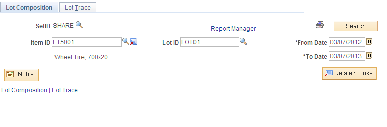

Use the Review Lot Trace/Composition - Lot Composition (inquiry) page (INV_LOT_COMP_INQ) to view receiving transaction history detail for a specific item-lot combination across the inventory and manufacturing business units.
Navigation:
This example illustrates the fields and controls on the Review Lot Trace/Composition - Lot Composition inquiry page. You can find definitions for the fields and controls later on this page.
If the installation includes PeopleSoft Manufacturing, the components that make up a specific lot-controlled assembly item appear.
The grids display data from all of the receipts across your enterprise, including stocking transactions generated by purchasing receipts, interunit transfer receipts, RMA receipts, manufacturing production ID and completions, and WIP receipts.
If a search from this page returns data that includes lot-controlled components, you can click the component's lot ID link to access the Lot Trace page (without losing the original lot composition search results) and perform a concurrent lot trace search that displays one level of parent item information. The Lot Trace page is populated with parent item data for the lot-controlled component. To return to the original composition search results, select the Lot Composition tab or click the Lot Composition link. Alternatively, you can perform a lot composition search for another item-lot combination row, and the previous search results are discarded.
The transaction group name appears for each tab on this page.

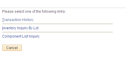

Use the Lot Composition Transfer page (INV_LOT_COMP_POPUP) to access associated inquiry pages where you can view additional information for the parent item-lot combination and its lot-controlled components.
Navigation:
Click the Page Links button on the Review Lot Trace/Composition - Lot Composition page.
This example illustrates the fields and controls on the Lot Composition Transfer page. You can find definitions for the fields and controls later on this page.
Primary Access Links
These links return information relating to the parent item for which you are searching on the header of the Review Lot Trace/Composition - Lot Composition page or relating to the component item in the grid, depending on which link you click.
Field or Control |
Description |
Item Lot Information |
Click to access the Lot Composition - Item Lot Information page to view additional information about a lot-controlled parent item in a selected business unit. |
Component Lot Information |
Click to access the Component Lot Information page, where you can view detailed information about the component item-lot combination in a selected business unit. The Component Lot Information page is only available if the row being selected has a component listed with a lot ID. |
Navigational Links
Field or Control |
Description |
Inventory Inquiry by Lot |
Click to access the Inventory Inquiry by Lot page to view current inventory information by component item and lot. |
Component List Inquiry |
Click to access the Production Selection page to view component list details for the production ID or schedule. |
Transaction History |
Click to access the Transaction History inquiry page to view all inventory transactions for the lot-controlled component item at the business unit level. |

Use the Review Lot Trace/Composition- Lot Trace (inquiry) page (INV_LOT_TRACE_INQ) to view where a specific item-lot combination has been used, shipped, or issued across all of the inventory and manufacturing business units.
Navigation:
This example illustrates the fields and controls on the Review Lot Trace/Composition - Lot Trace inquiry page. You can find definitions for the fields and controls later on this page.
If the installation includes PeopleSoft Manufacturing, you can display the parent item information for a specific lot-controlled component item.
The grid displays data from all of the inventory shipment and issue transactions across your enterprise, including; customer, interunit, VMI, work order, and return-to-vendor shipments, plus material issued to the shop floor.
If a search from this page returns data that includes lot-controlled parent items, you can click the parent's lot ID link to access the Review Lot Trace/Composition - Lot Composition page (without losing the original lot trace search results) and perform a concurrent lot composition search that displays one level of component item information. The Lot Composition page is populated with component item data for the lot-controlled parent item. To return to the original lot trace search results, select the Lot Trace tab or click the Lot Trace link. Alternatively, you can perform a new lot trace search for another item-lot combination row and the system discards the previous search results.
The transaction group name appears for each tab on this page. The following table lists which transaction groups are included as data sources for lot trace inquiries:

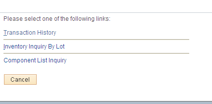

Use the Lot Trace Transfer page (INV_LOT_TRC_POPUP) to access associated inquiry pages to view additional information for the component item-lot combination and for its lot-controlled parent items.
Navigation:
Click the Page Links button on the Review Lot Trace/Composition - Lot Trace page.
This example illustrates the fields and controls on the Lot Trace Transfer page. You can find definitions for the fields and controls later on this page.
Field or Control |
Description |
Click this link to access the Lot Trace - Item Lot Information page, where you can view basic information for the lot-controlled parent or end item in a selected business unit. Lot trace functionality searches up one level at a time, when you are tracing where a component is used or shipped, you are viewing its end-use or parent-item details—no further component information is visible at this level. |
Parent Lot Information |
Click to access the Parent Lot Information page to view more information about a lot-controlled parent item in a selected business unit. |
Multiple Output Information |
Click to access the Multiple Output Information page to view production details for all output for the production ID. |
Navigation Links
Field or Control |
Description |
Click to access the Inventory Inquiry by Lot page to view current inventory information by parent item and lot. |
Click to access the Production Selection page to view component list details for the parent item-lot combination. |
Output List Inquiry |
Click to access the Displaying Production Output Mix Information page to view output list details for the production ID. |
Click to access the Transaction History inquiry page to view all inventory transactions for the lot-controlled parent item at the business unit level. |
