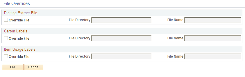

 Review or change the file directory and file name for the picking extract file, item usage labels, or carton labels. The default values are set on the Setup Fulfillment-Electronic Fulfillment page.  |

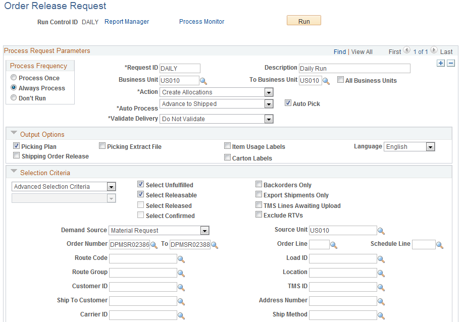

Use the Order Release Request page (RUN_IN_FULFILL_RLS) to enter search parameters and settings to release demand lines to the released state and generate picking plans, picking extract files, generate item usage and carton labels, and launch the Shipping Order Release EIP.
Navigation:
This example illustrates the fields and controls on the Order Release Request process page (1 of 2). You can find definitions for the fields and controls later on this page.
This example illustrates the fields and controls on the Order Release Request process page (2 of 2). You can find definitions for the fields and controls later on this page.
Field or Control  |
Description  |
Business Unit and To Business Unit  |
 If this run control should process one PeopleSoft Inventory business unit, enter the unit in the Business Unit field. If you want to process a range of business units, enter the starting unit in the Business Unit field and the ending business unit in the To Business Unit field. The system processes all Inventory business units, sorted alphanumerically, that fall between the starting and ending unit.  |
All Business Units  |
 Select to process all PeopleSoft business units in this run control.  |
Action  |
 Defines the action to be taken by the Order Release process. The options are:
Auto-Processing Option  |
 Select the auto processing option to move your orders downstream to the desired state. Options include:
Auto Pick  |
 Select this check box to use the pick action Create Allocations and to automatically set the Confirm Flag to yes. If the confirmed flag is set to yes, then the line can advance to a confirmed, shipped, or depleted state without going through picking feedback.  |
Validate Delivery  |
 Select an option to validate the deliveries in this process run. The process confirms that the attributes of the delivery and the demand lines that are assigned to the delivery are still valid. The process looks for demand lines on the delivery that do not match the values in the delivery key fields defined on the Inventory Definition - Business Unit Options: Delivery Management page used to build a delivery. For example, if the carrier ID must be the same for all demand lines on the delivery but not all the demand lines have the same carrier ID, then the process produces an error. The process also recalculates the total weight and volume, total number of containers, and total number of packages. The options are:
 See Understanding PeopleSoft Delivery Management and Freight Calculations.  |
Defer Depletions  |
 Select the value of Override to Yes or Override to No to change the value of the Defer Depletions field on each demand line selected by this page. When this field is left blank, the default value is derived from the Carrier page; if there is no default value on the Carrier page then the system uses the default value on the Setup Fulfillment-Shipping page. This field does not display if you have selected the value of Do not use this feature on the Setup Fulfillment-Shipping page. For more information in the Defer Depletions feature, go to the "Shipping Inventory" topic, "Delaying the Billing and Costing of Inventory Shipments" section. See Delaying the Billing and Costing of Inventory Shipments.  |
Output Options
Select the reports and files to generate when the Order Release process is run.
Field or Control  |
Description  |
Picking Plan  |
 Select to generate the Picking Plan (SQR) report based on the settings under the Additional Options link of this process page.  |
Picking Extract File  |
 Select to create an extract file containing information generated by the Order Release process. This is an optional file that is sorted according to the options specified on the Order Release Group/Order By group box under the Additional Options link of this process page. The file can be downloaded into an electronic data collection system that allows bar code-driven picking. Define file parameters under the File Overrides link of this process page or on the Setup Fulfillment-Electronic Fulfillment page.  |
Item Usage Labels  |
 Select to create item usage labels automatically when you print the picking plan. These labels aid in the tracking of material usage. Define file parameters under the File Overrides link of this process page or on the Setup Fulfillment-Pick Plan Label page.  |
Shipping Order Release  |
 Select to generate the Shipping Order Release EIP. The sort selections available under the Additional Options link of this process page or the Setup Fulfillment-Order Release page do not control the sequence of the orders in the shipping order release transaction. Order release data sent to the third-party system is separated into logical orders based on breaks in the following sort sequence: business unit, demand source, source business unit, order number, customer ID, ship to ID, address sequence code, carrier ID, and ship via. If the address information for an order is modified before order release, the address fields are added to the sort sequence.  |
Carton Labels  |
 Select to create shipping carton labels automatically when running the Order Release process. These labels (which can be applied to each carton) enable you to provide shipping information for shipping personnel and carriers, build shipping containers, and provide customer-specific information identifying items within the cartons. File parameters for the shipping carton labels are defined under the File Overrides link of this process page or on the Setup Fulfillment-Pick Plan Label page. You can identify the label unit of measure using the Additional Options link of this process page.  |
Note: When using the processing groups feature, it is important to remember that each processing group creates a separate processing run. When the processing group feature is used with the Shipping Order Release service operation, each separate process group creates a separate pick plan ID, separate picking extract file, separate Shipping Order Release transaction, and separate set of labels. For example, if the Order Release process picks up 1300 demand lines for processing and the processing count is 500 and the processing level is line, then three separate pick plan IDs are produced from the three separate process runs; two groups of 500 lines each and one group of 300 lines. The processing groups feature is defined on the Setup Fulfillment-Fulfillment Task Options page or the Fulfillment Engine Options page.
See Understanding Fulfillment Engine Processing Groups and Commit Levels.
Selection Criteria
Define the search criteria to select demand lines for order release. You can select a wide variety of criteria by using the Specific field to include only those demand lines associated with a specific carrier, item, load, order or range of orders, route or route group, TMS ID, ship to customer or location, or ship via. You can also select Advanced Search Criteria to use a combination of numerous search fields.
Note: Work order created in PeopleSoft Maintenance Management cannot be selected or processed by the Order Release Request process.
Field or Control  |
Description  |
Select Unfulfilled  |
 Select this check box to include demand lines in the unfulfilled state that meet the search criteria.  |
Select Releasable  |
 Select this check box to include demand lines in the releasable state that meet the search criteria. Note: To retrieve any demand lines in your search criteria, you must select either the Select Releasable check box or the Select Unfulfilled check box. The default values for these check boxes are defined for the Order Release Request on the From States tab of the Setup Fulfillment-Fulfillment Task Options page (business unit level) or the Fulfillment Engine Options page (SetID level).  |
Backorder Only  |
 Select this check box to include only demand lines that are currently backordered.  |
Export Shipments Only  |
 Select this check box to include only demand lines that are export shipments.  |
TMS Lines Awaiting Upload  |
 Select this check box to pick lines that have been downloaded to the TMS and are waiting to be uploaded to PeopleSoft. This check box overrides the check box on the Setup Fulfillment - Transportation Interface page.  |
Exclude RTVs  |
 Select this check box to exclude return to vendor MSRs from the process run. To include just return to vendor MSRs, select Advanced Search Criteria in the Selection Criteria group box and then enter the value of Material Return in the Demand Source field. All return to vendor MSRs are processed as Release Only in the Action field, since a pre-allocation exists to the material storage location containing the returning stock. See Processing Return to Vendor Stock Requests in Demand Fulfillment.  |
Keep Lot Allocations  |
 Select this check box to keep the lot allocations, if any, on the demand lines when using the Actions of Return to Releasable or Return to Unfulfilled.  |
Keep Pre-Allocations  |
 Select this check box to keep any pre-allocations created when the demand line was in the Unfulfilled or Releasable fulfillment state. This check box is available when using you select the Actions of Return to Releasable or Return to Unfulfilled.  |
Keep All Allocations  |
 Select this check box to keep any allocation (pre-allocation, lot-allocation, or standard allocation) currently assigned to the demand line. This check box is available when using you select the Actions of Return to Releasable or Return to Unfulfilled.  |
Keep Reservations  |
 Select this check box to keep the reservation, if any, on the demand lines when using the Action of Return to Unfulfilled.  |

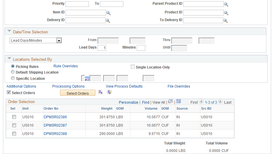

Select Orders  |
 Select this check box to open the Order Release Selection group box where you can select to release a subset of the orders meeting the selection criteria.  |
Date / Time Selection
To narrow the selection even further, you can release orders based on their scheduled shipping dates and times. For example, you might want to pick orders scheduled to ship next week or orders shipping today within the next two hours. These selections can default from the Order Release Date/Time Select group box of the Setup Fulfillment-Order Release page.
Field or Control  |
Description  |
Date/Time Range  |
 The order release process includes demand lines scheduled to ship within the specified From and Thru parameters. For example, you could release orders for picking that are scheduled to ship between 8 a.m. next Monday and 5 p.m. next Friday.  |

Locations Selected By
These options determine the manner in which the order release process suggests storage locations from which to pick stock.
Field or Control  |
Description  |
Picking Rules  |
 Select to use the picking rules defined by the picking algorithm entered in the Location Option field of the Setup Fulfillment-Order Release page or defined for the individual item on the Setup Item Fulfillment page.  |
Rules Override  |
 Select this link to access the Rule Overrides page where you can review or change the default picking options from the Order Release Run Time Options group box on the Setup Fulfillment-Order Release page.  |
Default Shipping Location  |
 Select to use the Default Ship Location defined on the Setup Fulfillment-Shipping page or defined for the individual item on the Setup Item Fulfillment-Shipping Options page.  |
Specific Location  |
 Select to define the material storage location in the fields to the right.  |
Single Location Only  |
 Select to have the picking plan suggest only one material storage location for picking each demand line. This check box is applied when you select either the Default Shipping Location option or the Specific Location option (above).  |
This group box can limit picking to a subset of the orders meeting the selection criteria. Click the Select Orders button to retrieve all orders that match the search criteria entered above on this Order Release Process page, then you can select individual orders to be released. This option is particularly useful when time is short or when you want to reduce the picking workload to small batches that are easily handled by a single picker. Detailed information for each order that you select is available on the Order Release Detail page.
Note: Although you select orders based on order numbers rather than on specific order schedule lines, only schedules meeting the selection criteria are actually released, and only these schedule lines appear on the Order Release Detail page. For example, suppose that you release orders using item A. Two of the schedule lines on the order contain item A and the third schedule line contains item B. According to this group box, the order can be released for picking, but only the two schedule lines containing item A are actually picked. Therefore, depending upon the selection criteria, a single order can be split among multiple picking plans.
When you save this Order Release Request process page after selecting individual orders in the Order Release Selection group box, PeopleSoft Inventory automatically assigns a unique pick release ID to the active run control and to each selected demand line. The Order Release Request run control will process only the demand lines associated with this pick release ID. If you do not select individual orders in the Order Release Selection group box, the run control processes all demand lines that meet the selection criteria.
The pick release ID gives you the flexibility to exit and reenter the Order Release Request process page without reselecting orders. When you click the Select Orders button, the system retrieves any previously selected orders in addition to those matching the current search criteria. The system assigns any new orders to the same pick release ID that you assigned to the original selections. After you run this Order Release Request run control the system resets the pick release ID to 0. The system also resets the ID for any demand lines that you cancel before running the process.
Field or Control  |
Description  |
Select Orders  |

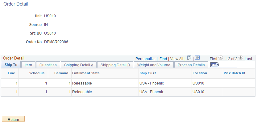

 Click this button to search for orders that meet the selection criteria and place them in the Order Release Selection group box where you can select to release a subset.  |
Sel  |
 Select the check box for each order that you want to release.  |
Order Group  |
 This information appears if the installation includes PeopleSoft Order Management and the order source is OM.  |
Total Weight and Total Volume  |
 These values appear (along with the number of pieces) if you selected the Show Total Pieces check box on the Setup Fulfillment-Order Release page and enter the weight and volume units of measure in the Setup Fulfillment page. If the options to show totals for weight, volume, and number of pieces are active for the business unit, the system adds these parameters for all selected orders and displays the grand totals at the bottom of the page.  |

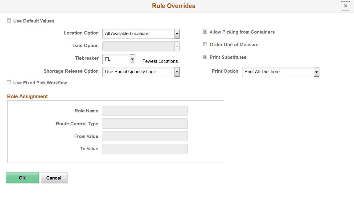

Use the Rule Overrides page (IN_FUL_RLS_RO_SEC) to review or change the default picking options from the Order Release Run Time Options group box on the Setup Fulfillment-Order Release page.
Navigation:
Select the Rule Overrides link on the Order Release Request page.
This example illustrates the fields and controls on the Rule Overrides page. You can find definitions for the fields and controls later on this page.
Field or Control  |
Description  |
Use Default Values  |
 Select to use the default picking options from the Order Release Run Time Options group box on the Setup Fulfillment-Order Release page. Clear this check box to change the picking options for this run control.  |
Location Option  |
 Review or change the directed picking algorithm:
Date Option  |
 If you select Pick by Date in the Location Option field, select one of these options: Earliest Available Lot (FIFO): Pick from locations containing lots with the earliest creation dates. Earliest Expiration Date (FEFO): Pick from locations containing lots with the earliest expiration dates. Earliest Staged Date (FIFO): Pick from locations containing items with the earliest staged dates. Latest Staged Date (LIFO): Pick from locations containing items with the most recent staged dates.  |
Tiebreaker  |
 If you select Container Option, Pick by Date, or All Available Locations in the Location Option field, specify a tiebreaker to be used when multiple storage locations qualify for picking: FL (fewest locations): Pick from the fewest locations possible, beginning with those containing the most available quantity. PC (pick to clear): Empty locations whenever possible, beginning with those containing the least available quantity.  |
Shortage Release Option  |
 Select a shortage release option for situations where there is not enough available stock to fulfill the planned release quantity. Shortage release options are:
 Note: If the demand line is released with an available quantity less the planned release quantity, then the label (shortage) is printed next to the planned release quantity on the picking plan.  |
Print Substitutes  |
 Select to have the picking plan list alternate items that can be used to fulfill the order. For order lines that allow substitutions and have insufficient quantity available to fulfill the order, any substitute items that can fulfill the order line are listed on the picking plan under the requested item in order of priority. Selecting this option also includes substitute items on bar-coded picking plans and picking extract files. Print options include Print All the Time, Print At Partial, and Print At Zero.  |
Use Fixed Pick Workflow  |
 Select if you are using the Fixed Pick Location algorithm and you want the picking plan to initiate the Fixed Pick workflow automatically whenever there is insufficient quantity in the fixed picking locations to fulfill an order.  |
Role Name  |
 Indicate who should be notified when the Fixed Pick workflow is activated. The role that you assign refers to a type of position—a supervisor or manager, for example—rather than an individual person.  |
Route Control Type  |
 Specify the level of your organizational structure to which the workflow should be directed. You could, for example, indicate that the workflow affects supervisors at the business unit level.  |
From Value and To Value  |
 Use to narrow the route control selection. For example, you could specify that the workflow affects only supervisors in a particular business unit.  |

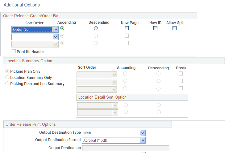

Use the Additional Options page (IN_FUL_RLS_AO_SEC) to select additional options for sorting and printing the picking plan and the picking plan's location summary.
Select to print bar codes and bar code control flags.
Navigation:
Select the Additional Options link on the Order Release Request page.
This example illustrates the fields and controls on the Additional Options page (1 of 2). You can find definitions for the fields and controls later on this page.

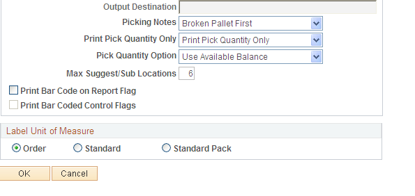

This example illustrates the fields and controls on the Additional Options page (2 of 2). You can find definitions for the fields and controls later on this page.
Specify up to three sort levels for the order release and picking plan report. Within each level, you can sort by address sequence number, carrier, freight terms, item, load, load stop number, ship to location (for internal orders and interunit transfers), order number, order priority, parent product ID (product kit), route, route stop, ship to customer (for external, intercompany transfers, and sales orders), ship via, and TMS reference ID. For example, you might want to sort the picking plan first by carrier ID, then sort the orders assigned to each carrier by order number, and then sort the lines of each order by item ID.
For each level, indicate whether the results should appear in Ascending or Descending order.
Field or Control  |
Description  |
New Page  |
 Select this check box to insert a page break at this sort level.  |
New ID  |
 Select this check box to create a new pick plan ID at the first sort level  |
Allow Split  |
 If using the processing groups feature (defined on the Setup Fulfillment-Fulfillment Task Options page or the Fulfillment Engine Options page), this check box controls how the processing group is split.
Note: When using the processing groups feature, it is important to remember that each processing group creates a separate processing run. When the processing group feature is used with the Order Release process, each separate process group creates a separate pick plan ID, separate picking extract file, separate Shipping Order Release transaction, and separate set of labels. For example, if the Order Release process picks up 1300 demand lines for processing and the processing count is 500 and the processing level is line, then three separate pick plan IDs are produced from the three separate process runs; two groups of 500 lines each and one group of 300 lines. Within each processing group, the demand lines are sorted according to the criteria in the Order Release Group/Order By group box.
Note: If the Use External Warehouse Control option is active for the business unit, these sort options do not affect the sort and breakout of the keys used to send records to the WMS application.
Field or Control  |
Description  |
Print Kit Header  |
 Select this check box to include a product kit subheading on the picking plan report. When your demand lines contain kit components, the pick plan report generates a subheading with the product kit ID, description, and any other information common to all the kit component demand lines. The kit component demand lines are grouped below the kit heading and include the item's quantity and UOM to be applied per kit assembled or order (quantity per information); for example, 1 EA per ASY. In addition, if you have selected the Print All Quantity Fields value in the Print Pick Quantity Only field on this page, then the Kit Quantity Requested is printed in the kit header. This value is the total number of product kits requested on the order line. If you do not select this check box then the product kit ID and description are printed within the item's pick line. This check box is only available if you have selected Parent Product ID (product kit ID) for any of the three Sort Order fields.  |
Location Summary Option
If you are using a push picking plan (the Action of Create Allocations on the Order Release Request page), you can print a Location Summary report with or without a full Picking Plan report. The Location Summary report sorts the demand lines according to where the items are physically stocked within the warehouse (Inventory business unit). The layout of the printed report reflects the actual positions of stock to be picked, enabling your personnel to fulfill all orders on the picking plan without revisiting locations. The Location Summary report includes two different sorts:
Sort Order: This sort is based on the physical location table (PHYSICAL_INV) that contains the location, quantity, and other details about every item stocked within each inventory business unit. You can select up to three sorts related to the physical location table. For example, if you select Area, as the highest-level ascending sort order, the Location Summary report groups together all demand lines to be picked from storage area A, then groups all lines to be picked from storage area B, and so on. In addition to the layout of the business unit (for example, zones, storage areas, material storage locations), you can also select sort order values based on the stock stored within the business unit, including; item ID, lot ID, serial ID, staged date, and so on.
Location Detail Sort Option: This sort is based on the demand fulfillment tables (IN_DEMAND and its child records) that contain information on the order itself, such as, order number, customer, or carrier. This sort occurs within the higher-level Sort Order. For example, if you select Area, as the highest-level ascending sort order and Order No as the highest-level ascending location detail sort option, then the Location Summary report groups together all demand lines to be picked from storage area A and, within storage area A, sorts the demand lines by order number, and next groups all lines to be picked from storage area B, and within B sorts the demand lines by order number, and so on.
For each location to be picked, the report displays a row with the full information, including; zone, ASRS ID, material storage location, item, lot, serial, staged date, storage container, quantity to be picked, and the stocking unit of measure (using the sort order). Below this row, the order demand lines are displayed (using the location detail sort option). For example, if you are picking lot-controlled stock using sort orders of storage location and then lot with a location detail sort option of order no, then the Location Summary report might look like this:
Storage Area A, Aisle 42, Cabinet 12, Shelf 3 (the material storage location), Item ID LT5001, Lot ID 3000, 25 EA (the quantity to be picked and stocking UOM)
Order 1, Line 1
Order 1, Line 2
Storage Area A, Aisle 42, Cabinet 12, Shelf 3, Item ID LT5001, Lot ID 3001, 50 EA
Order 1, Line 1
Order 1, Line 2
Storage Area B, Aisle 18, Cabinet 55, Shelf 1, Item ID LT5001, Lot ID 7000, 100 EA
Order 2, Line 1
Note: It is possible to complete all of the picking using only the Location Summary report; however, you can only view details such as picking errors or picking line and schedule orders and notes if you print out a full Picking Plan report.
Field or Control  |
Description  |
Picking Plan Only, Location Summary Only, and Picking Plan and Loc Summary (picking plan and location summary)  |
 Indicate which version of the picking plan you are printing. Location summary options are only available when you enter the following values on the Order Release Request page:
Sort Order  |
 Select up to three sorting levels to sort demand lines on the Picking Plan Location Summary report. These sort orders are based on the locations within the inventory business unit (physical location table). For each level, indicate whether the sort is in ascending or descending order and whether a page break should occur. Values for the highest-level Sort Order field are:
 Once a value has been used at a higher-level sort order, the same value cannot be repeated in a lower-level sort. The values for the two lower-level Sort Order fields are:
Location Detail Sort Option  |
 Select up to two location detail sort options. The detail sort options are based on values located on the demand line, not the physical locations within the warehouse. For each level, indicate whether the sort is in ascending or descending order. Once a value has been used at the higher-level sort order, the same value cannot be repeated in the lower-level sort. Values for the location detail sort option fields are:

Picking Notes  |
 If you select the Picking Plan check box to generate the picking plan SQR report, then you can select a message to print at the top of each page of the Picking Plan report: Broken Pallet First: Instructs the picker to pick any broken pallets first. Largest Batch First: Instructs the picker to pick the largest batch first. None: No message prints. Smallest Batch First: Instructs the picker to pick the smallest batch first.  |
Print Pick Quantity Only  |
 For each demand line, select to print all the quantity fields on the pick plan or just the pick quantity.  |
Pick Quantity Option  |
 Select the pick quantity to be displayed on the pick plan. Options are:
Max Pull/Sub Locations  |
 Indicate the maximum number of storage locations to include on pull picking plans or the maximum number of substitute item storage locations to print on the picking plan. The default value is 6.  |
Print Bar Code on Report Flag  |
 Select to print code 128-formatted bar codes on the Picking Plan report, so that they can be scanned during the picking process. A bar code containing the pick batch line number and the five optional bar code scanning control flags appears next to the pick batch ID (located in the report's header) and on each detail line.  |
Print Bar Coded Control Flags  |
 Select to attach an item's control flags to the bar code printed on each line of the Picking Plan report. These control flags enable the electronic data collection system to prompt for the lot ID, serial ID, staged date, line number, or shipping serial ID immediately after the user scans the bar coded line number field. For cases that do not require control flags, such as when you are using a wedge to scan the pick batch ID or pick batch line number bar codes directly onto the Picking page, you may prefer not to activate this option. The format for the bar code printed for each detail line is LSDAH:99999. The format elements are the following:
 Note: PeopleSoft Inventory delivers printer settings for all SQR output to a generic line printer. However, when printing bar coded information on reports on a PCL printer (HP Laser Jet), you must first define the printer type accordingly. You may do this by changing the printer type settings delivered in SETENV.SQC from LINEPRINTER to HPLASERJET.  |
Label Unit of Measure
Select the order, standard, or standard pack UOM for the item. This is used to:
Define the number of pieces for EIP transactions.
Determine how many labels to print when generating carton labels.
The number of labels printed depends upon how you defined the units of measure when you set up the item.
Use the File Overrides page (IN_FUL_RLS_EX_SEC) to review or change the file directory and file name for the picking extract file, item usage labels, or carton labels.
Navigation:
Select the File Overrides link on the Order Release Request page.
This example illustrates the fields and controls on the File Overrides page. You can find definitions for the fields and controls later on this page.
The default values come from the Setup Fulfillment-Electronic Fulfillment page and the Setup Fulfillment-Pick Plan Label page.
Field or Control  |
Description  |
Override File  |
 Select to override the default file directory and file name for the picking extract file, the shipping carton labels extract file, or the item usage labels extract file. The directory is selected according to the following hierarchy:
 The file is named according to the following hierarchy:
Use the Order Release Detail page (IN_FUL_RLS_OD_SEC) to view order line information for the orders that appear on the Order Release Selection group box.
Navigation:
Click a linked order number in the Order Release Selection group box of the Order Release Request page.
This example illustrates the fields and controls on the Order Release Detail page. You can find definitions for the fields and controls later on this page.
Note: Order release processing only retrieves schedule lines that fall within valid scheduled ship dates and times. If the business unit requires closure calendar validation and processing for shipping activities as defined on the Closure Calendar page, and if the picking lead days include closure dates, the system adds one day to the number of picking lead days for every closed day and compares the result to the scheduled ship date. Therefore, the lead days include only open business days. Times are not included in these calculations.
Field or Control  |
Description  |
Export  |
 Identifies whether the shipment is a sales order or an intercompany transfer requiring export shipment documents.  |
Weight and UOM  |
 The weight of the pieces in this order line, expressed in the unit of measure defined on the Setup Fulfillment page.  |
Volume and UOM  |
 The volume of the pieces in this order line, expressed in the unit of measure defined on the Setup Fulfillment page.  |
Note: The weight and volume are based on the stocking weight and volume established on the Define Business Unit Item - Inventory: Weight/Volume page; if this information is unavailable, the weight and volume are based on the item weight and volume established on the UOM Weight/Volume page.
