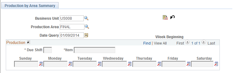

Use the Production by Area Summary page (SF_PA_SCH_SUMMARY) to define and maintain production schedules.
Add production IDs, or add, modify, and view all production for a specific production area.
Navigation:
This example illustrates the fields and controls on the Production by Area Summary page. You can find definitions for the fields and controls later on this page.
Field or Control |
Description |
Date Query |
Enter the production due date to add or view production for the appropriate workweek. After you enter a date, the system displays the corresponding day of the week. |
Click the Fetch button to retrieve the production information, to add a new production schedule or production ID, or to make changes to existing production. |
Due Shift (production due shift) |
The system displays the shift when the production start quantity will be completed. The system also displays the schedule quantity due for each day of the week. |
Click the Production Detail button to select one of these links:
Click Insert to add a production quantity for an item in the selected area. Note: Click the Insert Row button to enter a row on this page. To delete a production start or production end quantity, use the Production by Area Details page. |
Click the Reset Selection button to clear the information that appears in the grid and select a new area or date. |
Due Shift |
Enter a production due shift for the item and scheduled quantity. |
Item |
Enter an item value. You can maintain production quantities for items that are manufactured using either production schedules or IDs. The only restriction is that the item must be defined for the production area selected. Once you save the information, you cannot change the item; you can only delete the schedule. |
Note: When adding an assembly with item status of Hold, you will receive a warning message. The warning message does not prevent you from performing the action. The system also gives you the option to cancel at save time.
Production Quantity
Enter the quantity on the day the week that you want the production to be completed. If you have specified a rate quantity per shift for the area and item, you can view and select that rate by clicking the down arrow in the appropriate day column. For example, the day that you choose for the quantity is the production due date. Whether you can enter a whole number or a decimal may depend on the item's unit of measure and quantity precision combination defined in PeopleSoft Inventory. For example, suppose that item ID A0007 has a unit of measure of EA and a natural round, whole number combination. Then you can only enter whole numbers. If you enter an incorrect number format, you receive an error message.
The system automatically calculates the production start date and shift as well as the actual start date and time and actual due date and time once you click the Process button. In addition, when you enter a quantity for a day:
The system adds the quantity on the date corresponding to the day of the week in which the quantity was entered.
The time is set to the last hour of operation for the last work center on the item's routing.
If you're using operation yield, the system calculates the production start quantity based on the production end quantity.
Because production schedules are always backward scheduled, you enter the production end quantity.
You can change the due time at the production detail level.
Field or Control |
Description |
Click the Production Detail button next to the Quantity field on the day of the week that you want to change. Click the Detail link to complete the transfer. |
Important! You must click the Process button to save the schedule before you can access the Detail page.
You can change the due time for the scheduled production from the Detail page. You can define and maintain multiple production quantities, each with a different due time.
All changes to quantities for a day must be done at the production detail level.
You cannot delete production quantities in the Production by Area Summary page. Navigate to the Production by Area Details page to delete quantities.
If a routing is not defined for the item and you've entered a quantity for a shift and a day on this page, you must define the production start date and production start shift on the Production by Area Details page. The system automatically changes the due time to the last hour of operation based on the production calendar. The start date and shift automatically changes to the due date and shift. The time automatically changes to the first hour of operation based on the production calendar. You can change the actual start date and time within the production start shift as well as the actual due time within the production due shift.
The system displays production due shift options based on these scenarios:
The system uses the work center calendar for the routing's last operation, if one exists.
If a work center calendar does not exist for the routing's last operation's work center, the system uses the production calendar, if one exists.
If a production calendar does not exist, the shift for the five-day work week is available.
If you are adding production on the summary page, they are added in the Entered status. Access the Detail page to change the status or add production in the Firmed or Released statuses.
Click the Process button to save the production schedule or production ID. The system then calculates the production start date, time, and shift.
Note: If capacity and material availability are concerns, estimate the production start and production due dates and shifts when you create or maintain production using PeopleSoft Manufacturing, and then schedule the production schedule's or production ID's production start and production due dates and shifts using PeopleSoft Supply Planning.
The Process button uses Remote Call for three-tier processing. Remote Call is a PeopleCode API function that provides a means of calling a Tuxedo service from a PeopleSoft application. A typical use of Remote Call is to run data-intensive, performance-sensitive programs near or on the database server. If you experience a time-out or other error when adding or changing production information, use the Reschedule Production process (SFPCRSCH).

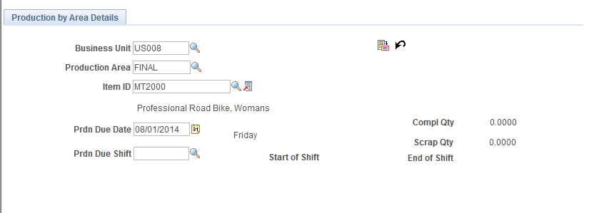

Use the Production by Area Details page (SF_PA_SCH_DT_MAINT) to view details for a production schedule or production ID.
Add production IDs, modify, or view details for all production in a specific production area.
Navigation:
Click the Production Detail button and select the Details link.
This example illustrates the fields and controls on the Production by Area Details page. You can find definitions for the fields and controls later on this page.
Field or Control |
Description |
Prdn Due Date (production due date), Prdn Due Shift (production due shift), Item ID, Prdn Start Date, (production start date) and Prdn Start Shift (production start shift) |
Enter values for these fields to retrieve production information. |
Search |
Click to display the selected production information. |
Compl Qty (completed quantity) |
Indicates whether assemblies have been completed to stock or routed to another production area. |
Scrap Qty (scrapped quantity) |
Displays the number of assemblies that have been scrapped in process. |
Click the Insert button to add new production quantities. Each quantity that you add on the Production by Area Details page has the same business unit, production area, item ID, routing, routing item, and production due date. The system calculates the total production quantity for the production due date or on the Production by Area Summary page. You can only add production in the Entered, Firmed, and Released statuses, and you can delete Entered, Firmed, and Released schedules. |
Rtg Itm (routing item) |
Displays the referenced item's routing. The end item can either have its own unique routing or reference another item's routing. |
Due Time |
The actual due date and time when production should be completed for the given production due date and production due shift. |
Prdn Start Qty (production start quantity) |
Displays the beginning quantity at the first operation of the manufacturing process. The system will adjust this quantity to account for any operation yield. |
Prdn End Qty (production end quantity) |
Displays the quantity expected at the end of the manufacturing process. The is the production quantity that you entered in the days of the week fields on the Production Area by Summary page. |
Click to Output List button to access the Production Output List page. |

Output Schd Qty (output schedule quantity) |
Enter the values for the item being produced. Whether you enter a whole number or a decimal depends on the item's unit of measure and quantity precision combination defined in PeopleSoft Inventory. |
BOM and Routing codes |
Values appear and are automatically assigned from the BOM and routing code combination defined for the production area and item combination for regular production. Because BOM and routing combination effectivity dates are defined at the area and item level, the BOM and routing combination appears by default based on the combination in effect on the due date of the schedule. Therefore, you can have multiple BOM and routing combinations for the same area and item combination, and this affects completions. Note: Because production is always backward scheduled using these pages, the production due date is used to check the BOM and routing combination effectivity dates. |
Prdn Start Date (production start date), Prdn Start Shift (production start shift), and Start Time |
These fields indicate the actual date, shift, and time when production should begin, as follows:
The actual due time automatically changes to the last minute of the specified shift using the calendars associated with the last operation. The last minute for the specified shift is based on the work center's calendar for the work center associated with the last operation in the item's routing. If not, the system uses the production calendar. If a production calendar does not exist, the system uses the shift for the five-day work week. Change the due time to any valid time that falls within the production due shift specified. If the shift spans multiple dates, the system determines the actual due date based on the production due date, production due shift, and actual due time specified. |
Click the Process button to save changes to the production schedule. The system calculates the production start date, time, and shift. |
