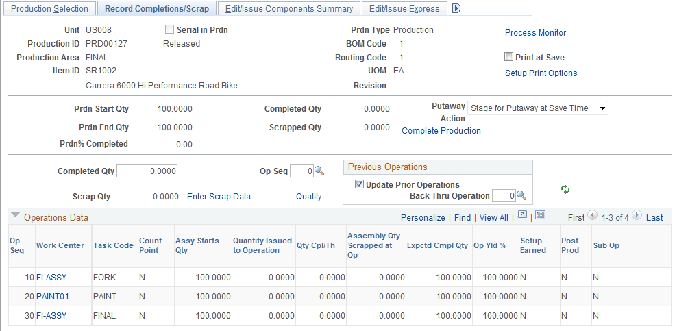

Use the Record Completions/Scrap page (SF_COMPL_ID) to enter reversing entries for selected production.

This example illustrates the fields and controls on the Record Completions/Scrap page. You can find definitions for the fields and controls later on this page.

Completed Qty (completed quantity) |
Enter a negative return quantity in this field. Note: If you enter a negative quantity in the Completed Qty (completed quantity) field, and you didn't select the negative completion on the Record Completions/Scrap - Production Selection page, you receive a message asking if you're doing a negative transaction. If Yes, then the transaction automatically selects the Negative Completions option for you, and you do not have to return to the Production Selection page and select the Negative Completions check box. |
Enter Scrap Data |
Click this link to correct the scrapped component quantities. |
Quality |
Click the Quality link to initiate a data entry session and to transfer to either the Data Entry - Subgroup Method page or the Data Entry - Sample Method page in PeopleSoft Quality, depending on the data entry method that you specified when creating the quality control plan. Note: The Quality link is available for each end item in the Output Details scroll area. You can transfer completions data to PeopleSoft Quality for each end item. |
Update Prior Operations and Back Thru Operation |
You can enter values for these fields if you're creating a reversing entry for production IDs. |
Lot ID |
Select a value if you're creating a reversing entry for lot-controlled end items. |
Area |
Specify the storage area and inventory locations from which you want to pull the completed end items. |
Return Qty (return quantity) |
Enter a negative number in this field. |
Serial IDs |
Click this link if you're correcting data entry errors for serial-controlled components. Select each serialized item that you want to move back into production by selecting one or more serial IDs. |
Note: Reversing entries are processed when you save the Record Completions/Scrap page.
