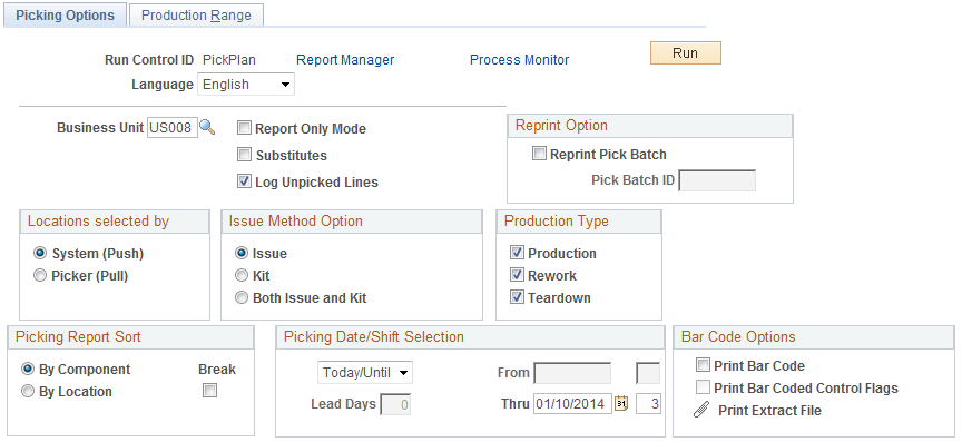

Use the Picking Options page (RUN_SFS6000) to generate picking plans for production.
You can generate pick plans for production with a status of Released or In Process.
Navigation:
This example illustrates the fields and controls on the Picking Options page. You can find definitions for the fields and controls later on this page.
Field or Control |
Description |
Report Only Mode |
Select to preview the pick plan before running it. The system does not create material reservations in Report Only mode because it is an information-only report. |
Substitutes |
Select to print substitutes on the pick plan. However, if you do not want the picker to pick substitutes, run the pick plan without displaying any substitutes. In this case, you can also run the pick plan in Report Only mode first, list substitutes, and then make the substitution on the component list before running the final pick plan. Note: Substitute items for rework and teardown end items do not appear. Once a partial pick has been done using an item or its substitute, it must be completed with the same item. No partial picking is permitted. If there is a shortage of the original item and it has substitutes, the substitutes appear on the pick plan. They are distinguished by a border around the substitute items. Note: The pick plan does not perform automatic substitutions. |
Reprint Pick Batch |
Select to reprint a previously printed pick batch. |
Pick Batch ID |
This edit box becomes available when you select Reprint Pick Batch. Select the pick batch ID number. If this is the first time you're printing the picking plan, do not select the Reprint Pick Batch check box. |
System (Push) or Picker (Pull) |
Indicate whether the system uses one of the following methods to determine the locations from which is picks components:
Issue Method Option |
Select from the following options: Issue, Kit, and Both Issue and Kit. Subsequent selection options depend on the issue method selected here. |
Issue |
When this method is selected, components on production IDs or schedules whose issue method is set to Production Issue are picked. Because these components are sent to WIP locations for consumption during end-item completions, the Production Selection process prompts you for WIP location information. The issue method uses netting to determine the amount of components to send to the WIP locations. The system includes all requirements through the selected date, even past due requirements when a date range is entered. It also checks requirements from production areas outside the selected range of production areas, if they share the same WIP locations. For each required component, the system determines the available quantity on hand in the WIP location. If the quantity on hand is negative, the system treats it as 0. The system then determines the required quantity of the component for the selected production. The system also reviews the quantity of in-process picking plans for the component and the WIP location. The system then checks the WIP minimum quantity, which is defined at the item and location level. It defines the additional quantity to be issued over and above the demand for Issue components. If all requirements occur as planned—and no additional material is issued to the WIP location—the component should have this quantity remaining in the WIP location. Once all demand is calculated (quantity required + WIP minimum quantity), it's netted against all supply (quantity on hand in the WIP location + all pending pick plans destined for the location). If the demand is greater than the supply, that amount appears on the pick plan. If supply is greater than demand, the component is not printed on the pick plan. |
Kit |
When this method is selected, components on production IDs whose issue method is set to Production Kit are picked. Because these components are issued directly to a production ID and are not consumed from WIP locations during end item completions, you specify the production area, production ID, and operation to which you want to send material. You cannot send material to a WIP location. The pick plan nets the component's scheduled quantity against the issued quantity. If the scheduled quantity is greater than the issued quantity, it prints the quantity on the pick plan. If the issued quantity is equal to or greater than the scheduled quantity, the system considers that component requirement fulfilled and does not print it on the pick plan. |
Both Issue and Kit |
This method assumes that you're picking components for production regardless of the issue method. Using this option, some components are sent to WIP locations and some directly to a production ID. On the Production Selection page, you specify to which production ID kitted components are sent as well as which WIP locations are stocked. |
Production Type |
Select Production, Rework, or Teardown. Note: A component with the item status of Hold for the production type Production cannot be picked. However, a component with item status of Hold for rework and teardown production can be picked. |
Picking Report Sort |
You can sort the picking plan by component, location, or production area. The production area option is available for only pull and push kits. |
Break |
Select to indicate that you want each component or location to print on its own separate page. The options available depend on the issue method selected. These are the valid combinations and sort options: |
Push or Pull |

Field or Control |
Description |
Picking Date/Shift Selection |
Indicate the production start dates and shifts for which you want to include picking plans. This information is required. The system issues a picking plan for all components associated with operations due to start within specified periods. Options are:
Print Bar Code |
Select to have the system print bar codes for bar coded fields on the Pick List. Note: PeopleSoft SCM applications do not support the printing of bar codes from processes running on OS390 servers. You should run your SQRs that print barcodes on a process scheduler server that is running on a non-OS390 operation system. |
Print Bar Coded Control Flags |
Select to attach an item's control flags to the bar code printed on each line of the Picking Plan report. These control flags enable the electronic data collection system to prompt for the lot ID, serial ID, staged date, or shipping serial ID immediately after the user scans the bar-coded line number field. For cases that do not require control flags (for example, when you are using a wedge to scan the pick batch ID or pick batch line number bar codes directly into the Inventory Picking page), you might prefer not to select this check box. The format for the bar code printed for each detail line is LSDAH:99999, where:
Note: PeopleSoft Inventory delivers printer settings for all Structured Query Report (SQR) output to a generic line printer. However, when printing bar coded information on reports, such as the Material Putaway Plan report and the Picking Plan report on a printer control language printer (for example, HP LaserJet), you must first define the printer type accordingly. You can do this by changing the printer type settings that PeopleSoft Inventory delivers in SETENV.SQC from LINEPRINTER to HPLASERJET. If you use electronic data collection, you can create a pick plan extract file. This file can be downloaded to a data collection device and used instead of a paper pick plan. The extract file is ASCII format and contains all the information included within the regular pick plan. |

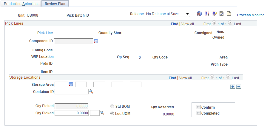

Use the Review Plan page (SF_PICK_TRANS) to confirm that the material was pulled from the suggested stores location, or to indicate from which location the material was pulled.
Navigation:
Enter information on the Production Selection page and click the Search button to retrieve the plan.
This example illustrates the fields and controls on the Review Plan page. You can find definitions for the fields and controls later on this page.
Field or Control |
Description |
Release |
Select how you want the material release to occur. Options are:
Kit Components |
Where substitutes exist, the Comp ID (component ID) field is available, and you can display substitutes for the component. The substitute component list is obtained from the BOM. No partial substitutions are allowed if components have previously been issued. Note: When a kit component is substituted, the component list is updated to reflect the substitution when you click Save on the Review Plan page. If a substitution is done on a PUSH pick plan, the original component is unpicked and the new component quantity picked. If the substitution is done on a PULL pick plan and a pick has already been recorded, the substitution is treated the same as for a PUSH plan. |
Issue Components |
For issue components that are consigned, the pick plan prints only non-owned material locations. If this component exists in an owned location, it must be manually transferred to an owned WIP location to be used in production. This cannot be done using the pick list. The substitute component list is obtained from the business unit level because the component may be associated with multiple end items, resulting in multiple substitute item lists. Where substitutes exist, the Comp ID (component ID) field is available, and you can display substitutes for the component. When an issue component is substituted, you must maintain the information at the component list on the Component List Maintenance page or the Edit/Issue Components page to record the substitution on the appropriate production IDs and production schedules. Until the data is updated or if another pick plan is run, the system attempts to pick the original component again. |
The system displays the number of storage levels defined for each storage location. Click the Storage Location Search button to search for a different storage area. If you're using the PUSH material issue method, the recommended storage area appears. You can modify the storage area, if you pulled material from an alternate location, as well as the quantity picked. If you need to change the picking location for a component, set the quantity to 0 or delete the existing row, and insert a new row. |
Storage Area |
If you're selecting consigned kit issue components, including lot- and serial-controlled components, you can pick from both owned and non-owned WIP storage locations if material exists in both. If you're using the PULL material issue method, specify the storage location such as Aisle, Level 1, Level 2, Level 3, and Level 4, depending on the storage level setup. When using the PULL material issue method for rework or teardown production, you can override the typical method and select a nettable location. |
Container ID |
Enter the value if you're picking from containers. |
Confirm |
After reviewing each entry, you can confirm the selection by selecting this option. If you confirm an item with the item status of Hold, you'll receive a warning at save time. However, you are not prevented from confirming the pick. Only those components that have been confirmed are released to production. Note: If you're modifying previously saved pick information, only the quantities can be modified. If you want to change picking location information, set the quantity to 0 or delete the row, and insert a new row. |
Completed |
Select to indicate that you are finished picking this pick line location. This option works with the Confirm option as follows
Lot ID and Serial ID |
If you're using the PUSH material issue method, the serial ID is the serialized component that should have been picked from the storage area. If the component is lot-controlled, the system displays the lot ID from which the component should have been picked. If you need to change the serial ID or lot ID for a component, set the quantity to 0 and insert a new row. If you're using the PULL material issue method, specify the serial ID or lot ID for each component that you picked. If you are entering data for rework or teardown production IDs that are using serial genealogy, keep these points in mind:
Note: If the component to be issued is not serial-controlled but trace usage is serial, the Pick Plan process does not suggest the serial ID to pick. You must indicate which serial IDs are to be picked. The system verifies that the components have not been assigned to another production ID. Note: This logic is also applied to other kit issues. |
If you do not need to make any changes to locations or quantities (or once all changes and selections have been made), you can confirm all of the suggested locations and quantities at one time when you click the Confirm All button at the top of the page. |
Click the Unconfirm All button to reverse all confirmed locations and quantities. |
If you do not pick any of the items on the pick plan, click the Delete All button to remove these rows from the pick plan. This relieves any hard material stock reservations that have been made. |
Confirm |
You can confirm selected pick lines by selecting this check box to indicate that these pick lines are correct and material is ready to be released. |
Click the Next button to access additional items in the scroll area. |
Click the All Complete button to indicate that all pick lines have been picked and there is no other quantity to be picked. |
Click the All Incomplete button to indicate that all pick lines are not complete. This indicates that you may want to pick additional quantities for specific pick lines. |
Save |
Click to process the review plan. |
