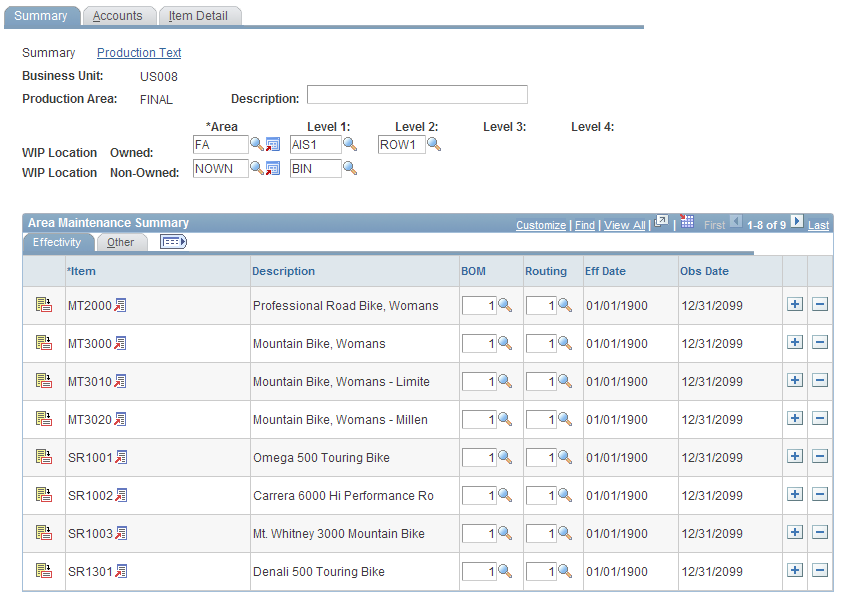

Use the Summary - Summary page (SF_PRDN_AREA_SUM) to define and maintain general information for each production area, indicate default WIP locations, and identify items to be manufactured within a production area.
Navigation:
This example illustrates the fields and controls on the Summary - Summary page: Effectivity tab. You can find definitions for the fields and controls later on this page.

WIP Location Owned and Non-Owned |
Enter values for the production area. If you are producing items that include non-owned components, for example, you are the subcontractor and the customer is supplying the components, define a non-owned WIP location in addition to the owned WIP location. Additionally, if you receive items that are consigned to you by the suppliers, they must be stocked in a non-owned location until they are consumed in production. Note: All consigned items are set up as non-owned. However, consigned manufactured items must be moved to owned WIP locations during the completions process. If you are exclusively using owned components in the WIP location, you do not need to identify a non-owned WIP location. Owned inventory can only be issued from and received into an owned inventory location. Likewise, non-owned inventory can only be issued from and received into a non-owned inventory location. Note: The transfer of consigned inventory from a non-owned location to an owned location results in the recognition of the payment liability. The owned and non-owned WIP locations for a production area indicate the locations where material should be issued or consumed, if the component's issue method is set to Issue or Replenish and any of these conditions exist:
Storage Area |
The system displays the number of storage levels in the Area, Level 1, Level 2, Level 3, and Level 4 fields that have been defined for each storage area. |

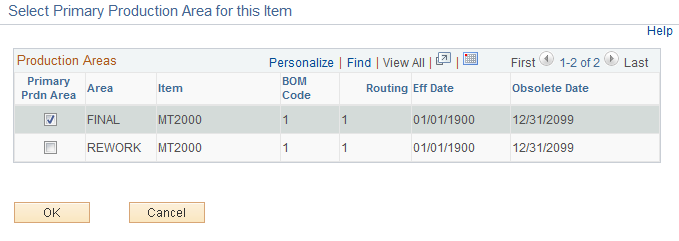

Use the Select Primary Production Area for this Item page (SF_PRDNAREA_SEL_SP) to select the default location where the production item will typically be manufactured.
Navigation:
Click the Item Search button and click the Primary Production Area link.
This example illustrates the fields and controls on the Select Primary Production Area for this Item page. You can find definitions for the fields and controls later on this page.
The primary production option identifies the primary production area for a specific BOM and routing code combination. This occurs because PeopleSoft Supply Planning enables you to plan for multiple BOM and routing code combinations. This primary production area option enables PeopleSoft Supply Planning to determine the production area that the production ID or production schedule to be manufactured.
This example illustrates how this works:

Using this example, if PeopleSoft Supply Planning generates one supply record (such as a production ID) with a BOM and Routing code equal to 1 and one with a BOM and routing code equal to 2, then the system would use AREA1 for the first supply record and AREA2 for the second supply record.
Note: Because primary production areas are defined at the BOM and routing combination level and these combinations can be effective-dated, the production area is the primary production area only for the dates specified on the combination.
Field or Control |
Description |
Primary Prdn Area (primary production area) |
If you enter the page and the correct primary production area is selected, then click the Cancel button to return to the Area Maintenance - Summary page. To change the primary production area, select the check box next to the production area that you want to designate as the primary location where this item is manufactured. When you click OK, the system accepts your changes. |

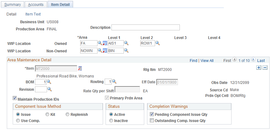

Use theProduction Area: Item Detail page (SF_PRDN_AREA_ITEM) to define production details for each item associated with a production area.
Navigation:
This example illustrates the fields and controls on the Production Area: Item Detail page. You can find definitions for the fields and controls later on this page.

Owned and Non-Owned WIP Locations |
You can change the values for these fields. |
Area Maintenance Detail
