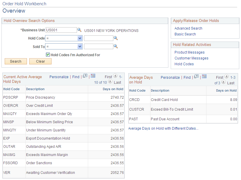

Use the Order Hold Workbench - Overview page (HWB_OVERVIEW) to use this page to view analytic data across sales orders on hold.
Hold data can be searched and summarized using business unit, hold code, or customer.
Navigation:
This example illustrates the fields and controls on the Order Hold Workbench - Overview page (1 of 2). You can find definitions for the fields and controls later on this page.
This example illustrates the fields and controls on the Order Hold Workbench - Overview page (2 of 2). You can find definitions for the fields and controls later on this page.
Hold Overview Search Options
Search using the Business Unit, Hold Code, and Sold To or a combination of these fields.
Apply/Release Order Holds
Use the links to search for orders with holds so you can apply or release holds.
Hold Related Activities
Use this section to navigate to hold codes or products and customers with hold-related messages.
Current Active Average Hold Days
This section displays the hold codes based on your search criteria. The Days on Hold value is the active holds in the system.
Field or Control |
Description |
Days on Hold |
This is the average time for active holds calculated in days. A timestamp on the order hold record indicates when it was last set to the active status. |
More Current Active Average Hold Days |
Click the link to access the Current Active Average Hold Days page. The link appears if the search criteria has more then 10 hold codes. |
Average Days on Hold
Displays the average days that a hold was active for a given time period. By default, the system calculates the average based on holds released in the last 30 days
Field or Control |
Description |
Average Days on Holds with Different Dates |
Click to access the Average Days on Hold page to change the range of holds to be included in average days on hold calculation |
Average Days on Hold |
Click the link to access the Average Days on Hold page. The link appears if the search criteria has more then 10 hold codes. |

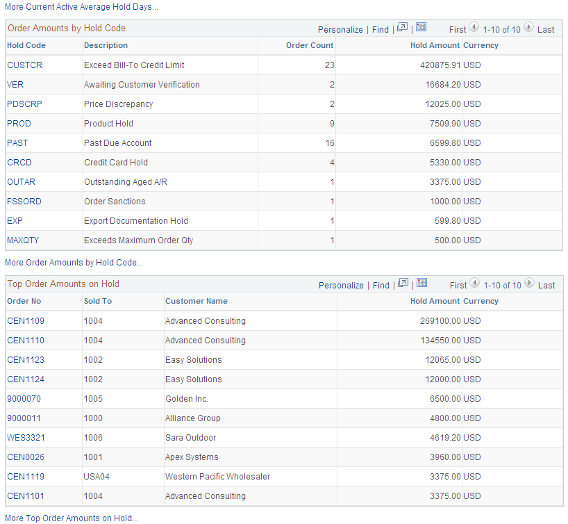

Order Amounts by Hold Code
This section displays the Hold Codes for orders that are on hold based on the search criteria. You can view the value that is on hold and the number of orders on hold for each hold code.
Field or Control |
Description |
Hold Code |
Click the link to access the Order Amounts by Hold Code Detail page. |
More Order Amounts by Hold Code |
Click the link to access the Active Average Hold Days page. The link appears if the search criteria has more then 10 hold codes. |
Top Order Amounts on Hold
This section displays the orders that are on hold based on the search criteria.
Field or Control |
Description |
Order No |
Click the link to access the Top Order Amounts on Hold Detail page. |
More Top Order Amounts On Hold |
Click the link to access the Top Order Amounts on Hold page. The link appears if the search criteria has more then 10 hold codes. |

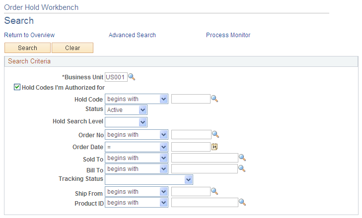

Use the Order Hold Workbench - Search page (HWB_SEARCH) to use to search for orders with holds.
Additional search fields appear if you select the Advanced Search link.
Navigation:
Click the Advanced Search link on the Order Hold Workbench - Overview page.
Click the Basic Search link on the Order Hold Workbench - Overview page.
This example illustrates the fields and controls on the Order Holds Workbench - Search page. You can find definitions for the fields and controls later on this page.
Note: Additional fields appear if you are performing an advanced search.
By default, the system does not select closed or canceled orders, lines, or schedules. It also does not select orders that require processing by the Order Completion process.
The customer pickup hold is not searchable and will not be brought into the workbench because it can only be released from the sales order. However, if the customer pickup hold code is added manually, it will be brought into the workbench.
Warning! The customer pickup hold should not be granted role security.
Field or Control |
Description |
Hold Search Level |
Use this field to restrict the level (Header, Line, or Schedule) when searching for hold codes. This restriction is helpful if you know what level you are searching for and want to reduce the amount of data brought into the workbench. Note: This option only appears when using Advanced Search. Certain fields may not be available for search because they are no longer applicable. Header: Search for header holds only. The system will only retrieve the header data. It does not bring in any line or schedule information, and you cannot navigate to line or schedule pages. Line: Search for line holds. The system will retrieve the header and line data. Schedule: Search for schedule holds. The system will retrieve the header, line, and schedule data. |
Product Group Type |
This setting is required if you want to search using a Product Group. |
