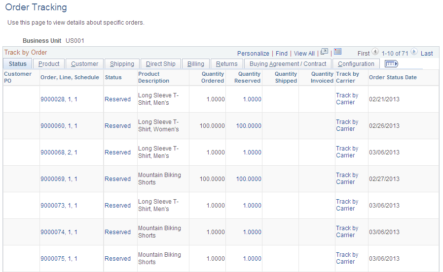

This example illustrates the fields and controls on the Order Tracking page. You can find definitions for the fields and controls later on this page.
This page displays information from the Order Entry Form page unless otherwise noted. You can view order information and navigate to other pages for more detailed information.
Status Tab
Displays information about the status of the order and the ordered, reserved, shipped, and invoiced quantity of the lines. You can also track the order from the carrier's website.
Field or Control |
Description |
Status |
Click a linked order status to access the Order Tracking - Schedule Detail page. If the status is On Hold, click to access the Order Tracking - Holds page. Note: Unlike the Backordered status on the Order Tracking - Search page, orders appearing here can have a status of Backordered if the backordering occurred at picking or at shipping. |
Order, Line, Schedule |
Displays the order, line number, and schedule number. For example, CEN001,2, 1 represents the schedule for the second line of order number CEN001. |
Quantity Reserved |
Click a value to transfer to the Fulfillment Status page. |
Quantity Shipped |
Click to view shipment detail on the Order Tracking - Shipments page. |
Track by Carrier |
Click to access the carrier's tracking website, which was established on the Carrier URL page. |
