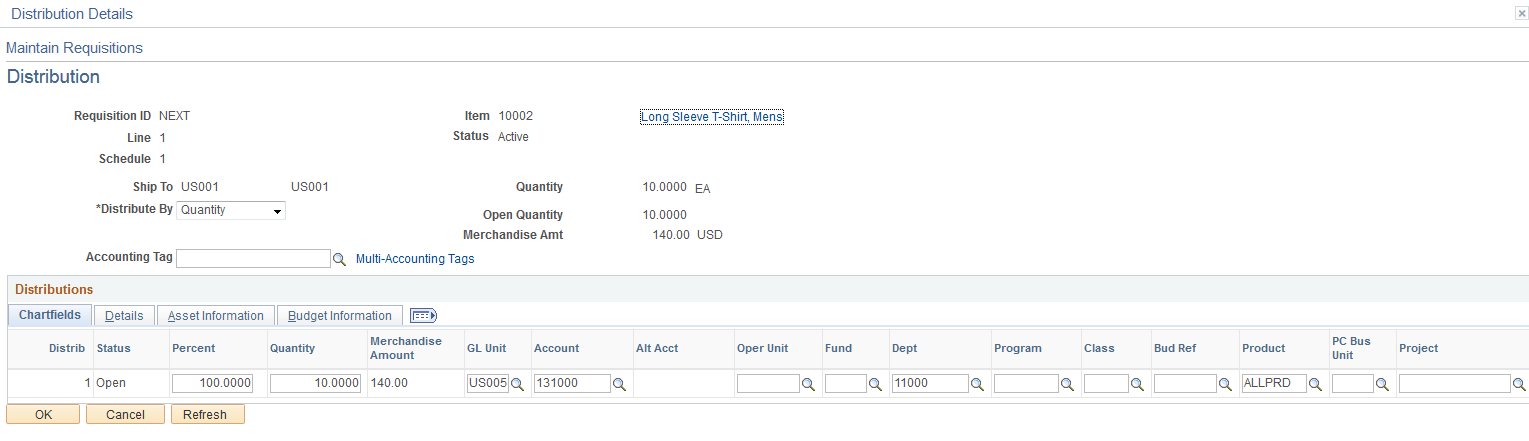

Use the Maintain Requisitions - Distribution page (REQ_DISTRIB_DETAIL) to specify multiple shipping schedules for each line and define multiple distributions for each schedule.
Navigation:
Click the Schedule button on the Maintain Requisitions - Requisition page.
Click the Distribution button on the Maintain Requisitions - Schedule page.
This example illustrates the fields and controls on the Maintain Requisitions - Distribution page. You can find definitions for the fields and controls later on this page.
The settings of the Override and Default options on the Header Defaults page affect defaulting behavior on this page when you split distribution lines.
For example, if you selected the Override option and you split 50 percent of distribution line 1 to distribution line 2, the system checks the requisition line defaults for a matching distribution line number (in this case, it is 2). If no match exists, the system checks the requisition header defaults. If no match exists, it applies the value from distribution line 1. If no value exists on distribution line 1, the system looks to the next levels in the default hierarchy.
If you have the Default option selected and perform the same split, the system checks the default hierarchy first. If no values exist, the system checks the requisition line and header default values as described previously.
Add distribution lines to the schedule to divide the delivery of goods among business units in the organization and to further define the accounting distributions. Sequential numbers are assigned to each distribution that you define for a schedule.
Distributions are transferred to purchase orders, but are not sent to the supplier.

Distribute by  |
 Select the method to use to allocate the expense account distribution. Selecting either option enables you to distribute by percentage. If you change the amount or quantity, the percent is adjusted. If you change the percent, the amount or quantity is adjusted. In either case, the total must equal 100 percent. Amount: Select to enter a value in the Amount field. The sum of all distribution amounts must equal the schedule amount (the value in the Amount field on the Maintain Requisitions - Schedule page). It is not recommended that requisition distribution lines for inventory items have a Distribute By value of Amount as it can cause rounding problems if sourced to PeopleSoft Inventory. Quantity: Select to enter a value in the Req Qty field. The sum of all distribution quantities must equal the schedule quantity (the value in the Req Qty field on the Maintain Requisitions - Schedule page). This options is recommended for inventory items that are sourced from PeopleSoft Inventory.  |
Liquidate by  |
 Liquidate the outstanding pre-encumbrance and encumbrance balances by amount or quantity. Note: This field is visible only if commitment control is enabled and you select the Allow Liquidate by Quantity when Distribute by Quantity check box is selected on the Purchasing Definition - Business Unit Options page. If commitment controlled is not installed, or you do not select the option to liquidate by quantity on the Purchasing Definition - Business Unit page, the budget processor balance liquidates by amount only.  |
SpeedChart  |
 Select a SpeedChart code. A SpeedChart retrieves preset ChartField definitions and applies them to the schedule distribution. Note: Accounting Tags appear in lieu of Speedcharts when the Accounting Tag check box is selected for Purchasing on the Accounting Tag Registration page. See Setting Up Accounting Tags  |
Multi-SpeedCharts  |
 Click to access the Multiple Speed Charts page. Use this page to define multiple speed charts and the requisition quantity to distribute by speed chart. Note: Accounting Tags appear in lieu of Speedcharts when the Accounting Tag check box is selected for Purchasing on the Accounting Tag Registration page. See Setting Up Accounting Tags  |
Accounting Tag  |
 Enter an Accounting Tag that will be used to populate ChartFields on transaction distribution lines. The system automatically prorates the distribution amounts according to the proration percentages defined on the Accounting Tag. Note: Accounting Tags appear in lieu of Speedcharts when the Accounting Tag check box is selected for Purchasing on the Accounting Tag Registration page. See Setting Up Accounting Tags  |
Multi-Accounting Tag  |
 Click to access the Multi Accounting Tag page where you can append and override accounting tags for the purchase order schedule. Note: Accounting Tags appear in lieu of Speedcharts when the Accounting Tag check box is selected for Purchasing on the Accounting Tag Registration page. See Setting Up Accounting Tags  |
Open Quantity and Open Amount  |
 Displays the quantity on the schedule not yet sourced to a purchase order if you are distributing by quantity. If you are distributing by amount, this field displays the amount on the schedule not yet sourced to a purchase order.  |

ChartFields
Select the ChartFields tab.
Field or Control  |
Description  |
Status  |
 Displays the distribution line status: Complete: The distribution line has met requisition reconciliation criteria and has been closed. Open: The distribution line is open and is available for sourcing. This value is open by default when the Requisition Status option is set to open on the Requester Setup page. Canceled: The distribution line has been canceled and is not available for sourcing. Processed: The distribution line is available for sourcing and is either in process or complete. This status implies that the line has already been processed.  |
Percent  |
 Enter the percentage of either the quantity or the amount that you want distributed on the distribution line. The value in the Amount or Req Qty field, depending on the distribution method, is calculated based on the value that you enter.  |
Quantity  |
 Enter the quantity of items that you want distributed on the distribution line. The value in the Percent field is calculated based on this value. This field is available for entry when you distribute by quantity. Note: You cannot enter a distribution quantity greater than the associated schedule quantity. To increase the quantity on a distribution line, return to the Maintain Requisitions - Schedule page and increase the schedule quantity, or reduce the quantity on other distributions for that schedule. The quantity on the distributions must equal the ordered quantity of the associated schedule.  |
Merchandise Amt (merchandise amount)  |
 Enter the total amount that you want distributed on the distribution line. The value in the Percent field is calculated based on this value. This field is available for entry when you distribute by amount.  |
