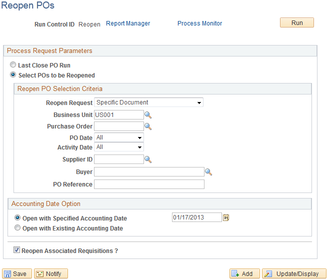

Use the Reopen POs page (RUN_PO_REOPEN) to initiate the Purchase Order Reopen process.
Navigation:
This example illustrates the fields and controls on the Reopen POs page. You can find definitions for the fields and controls later on this page.

Field or Control |
Description |
Last Close PO Run |
Select this option if you want to reopen the purchase orders that were closed during the last run of the Close Purchase Orders process. When you select this option, the Reopen PO Selection Criteria group box is not available. |
Select POs to be Reopened (select purchase orders to be reopened) |
Select this option if you want to reopen any purchase order that has already been closed. After you select this option, enter the purchase order or purchase orders you would like to reopen in the Reopen PO Selection Criteria group box. |
Field or Control |
Description |
Reopen Request |
Select the reopen request option. Values are:
PO Date |
Select a purchase order date option. Values are:
Activity Date |
Select an activity date option. Values are:
Supplier ID |
Select the supplier ID. Purchase orders associated with that supplier will be reopened. |
Buyer |
Select the buyer. Purchase orders associated with that buyer will be reopened. |
PO Reference |
Enter the purchase order reference. Purchase orders associated with that purchase order reference will be reopened. |
Accounting Date Options
Field or Control |
Description |
Open with Specified Accounting Date |
Select this option if you want to reopen the purchase orders using the accounting date you specify. The current date appears by default in the date field but you can override it if you choose. This field only appears if you are using commitment control. |
Open with Existing Accounting Date |
Select this option if you want to reopen the purchase orders using the existing accounting date on the purchase orders. This field only appears if you are using commitment control. |
Additional Criteria
Field or Control |
Description |
Reopen Associated Requisitions ? |
Select this check box if you want the Purchase Order Reopen process to reopen the requisition lines that are associated with purchase orders you are requesting to be reopened. For example, lets say you have a requisition that has five lines. You then create a purchase order associated to just one of the requisition lines. Then you close the purchase order. When you reopen the purchase order and if this check box is selected, the system will reopen just the one requisition line associated with the purchase order not the other requisition lines. If you are using commitment control, this check box must be selected. |
